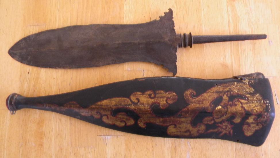

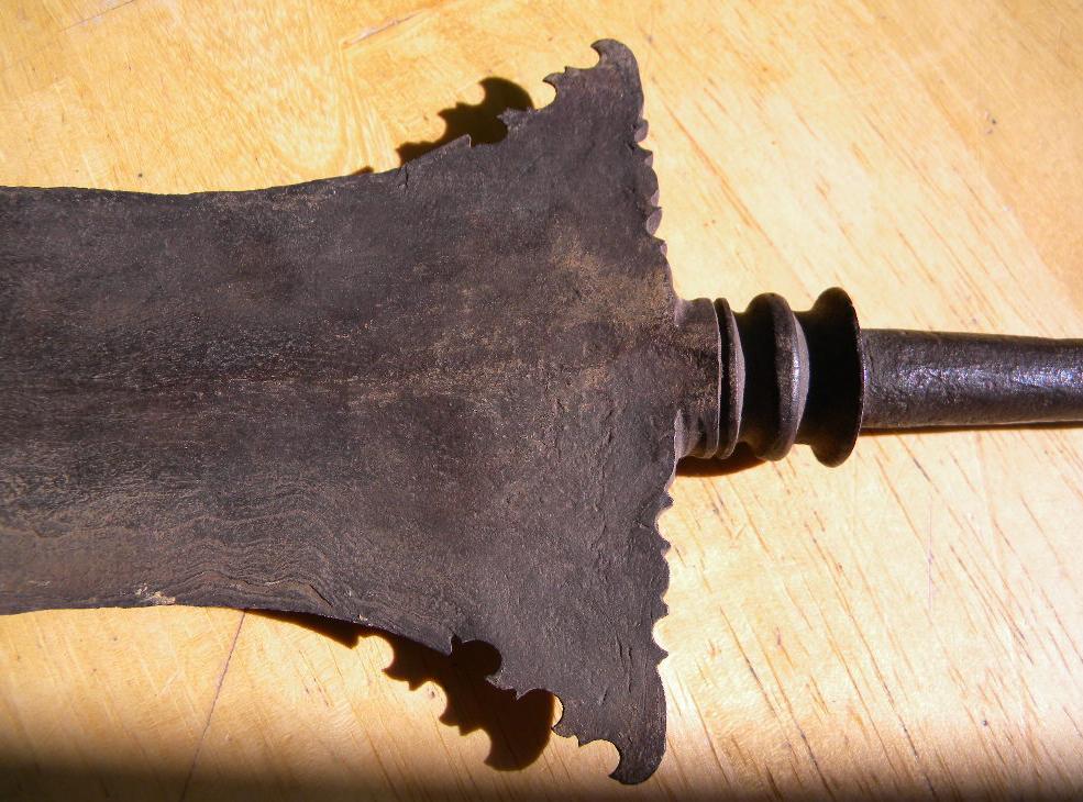

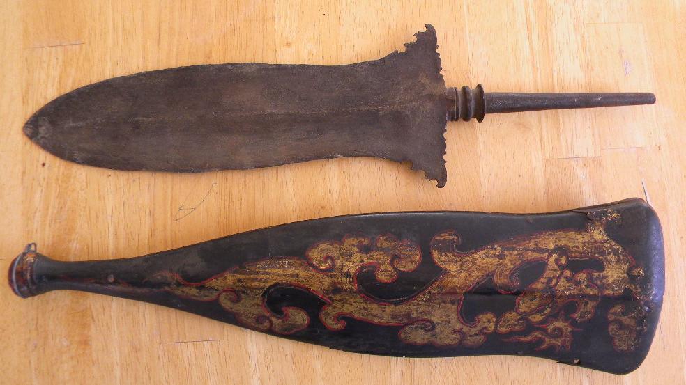

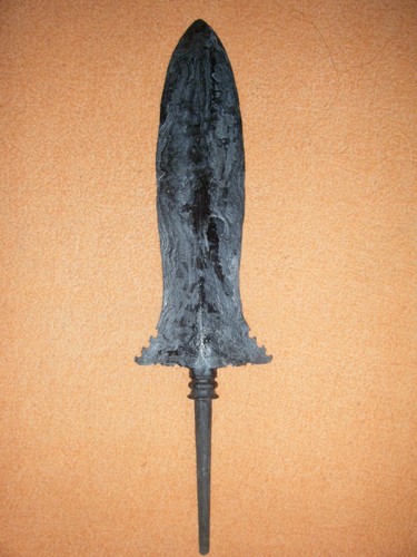

Hello Members,
yesterday I have won by e-bay this very big indonesian tombak, i think from Java. I have never seen a big one like this but the pictures tell me (I hope and cross my fingers) that it is an old original one. What do you think? Someone can tell me more? Pictures from the seller and the link: http://cgi.ebay.com/ws/eBayISAPI.dll...K%3AMEWNX%3AIT
Like every time many thank's in advance,

Nice piece - would be better if you could etch the blade to bring out the pamor.

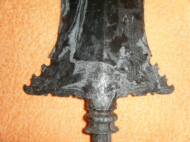

You know how much I dislike trying to classify blades from photos, but I think I'm prepared to offer an opinion on this one. Based upon the form of the metuk, form of rondha, and size, I believe this can be classified as Tuban. Tuban blades of all types were very substantial, and the metuk and rondha are much closer to Tuban form than any other.
I would hope that when this has been cleaned and stained we see Tuban material.
Detlef, believe me:- you do not want the blade to have a "nice pamor"; you want it to have a typical Tuban pamor which will be wos wutah or ngulit semongko, rather coarse, heavily veined, and smooth to the touch. If you're real lucky the pamor might be hair-like, and then we can attribute to Mpu Bekeljati.

thank you very much for your comment! Have I written that I wish to see a nice pamor after staining? I wish to see a hair-like wos wutah or ngulit semongko! Now I can't wait to hold it in my hands. That are very good news.

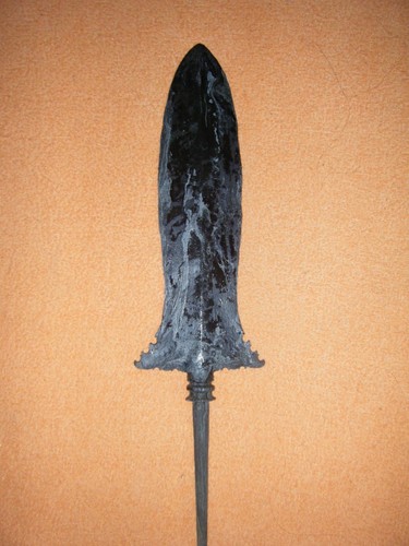

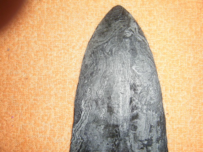

Hello Alan,
the tombak is stained and it seems that you have been correct, the pamor is like you supposed and the touch is indeed very smooth. What do you think, is it possible that this tombak is from Mpu Bekeljati?

Detlef, you've just been a staining fool lately...
Another nice job on an nice interesting tombak.
@Indiana....collecting tosan aji weapons tends to follow different rules than many other types of blades. These blades are traditional cleaned and re-stained on a regular basis within the culture they come from and it usually is not considered desirable to maintain and aged patina on the blade surfaces. The pamor patterns are culturally important and meant to be seen, not hidden by years of dirt and wear.

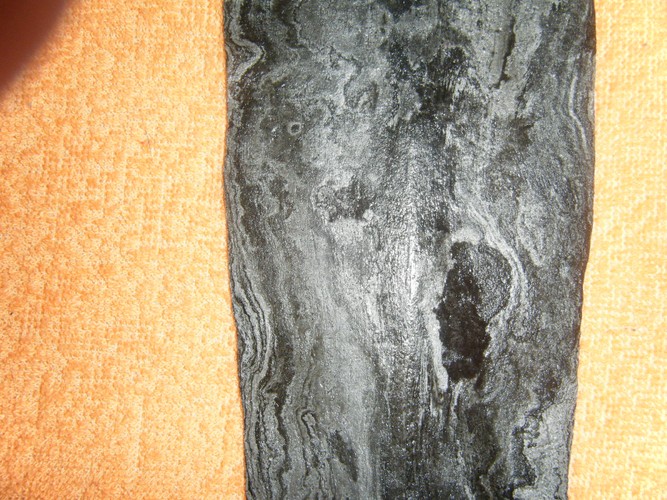

Posts: 6,441

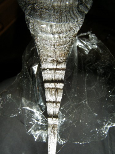

I'm looking for a core and I don't see one .

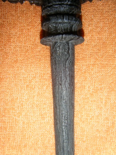

Is this tombak made entirely from pamor material ?
I notice the methuk is integral .

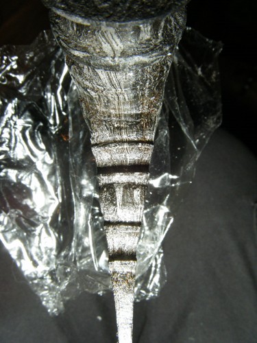

Hello Rick,

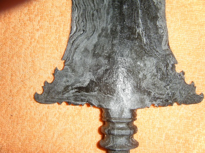

yes it seems like this. Here two closeups from pesi-side.

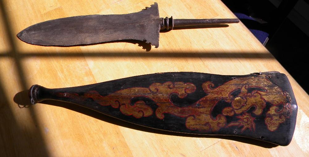

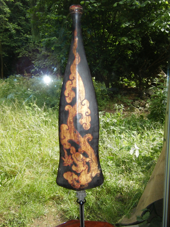

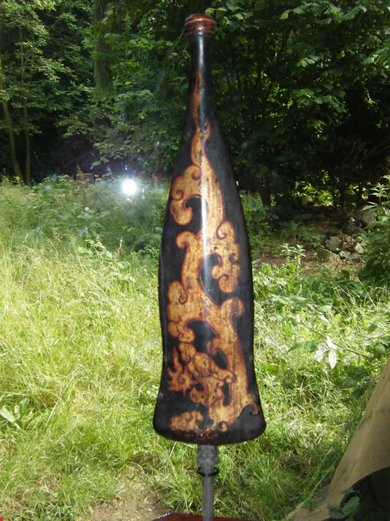

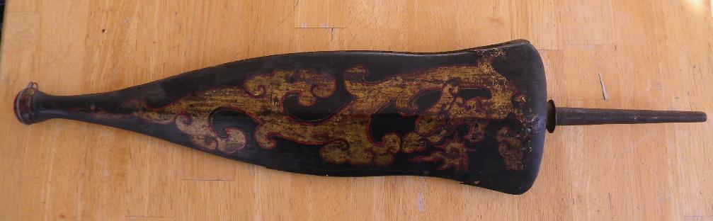

Here two pictures with the restored sheath!
Old 10th June 2012, 06:29 PM   #15
Posts: 6,441
Nice job .

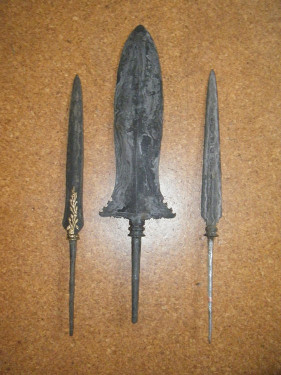

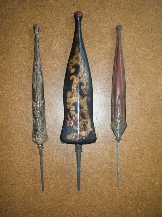

Maybe it is important to add that this size of tombak is a little bit unusual in my limited experience.
Here a picture with two other javanese tombak from my collection.
