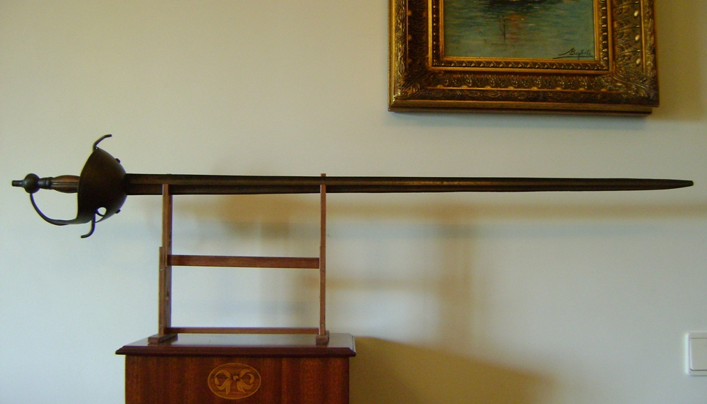

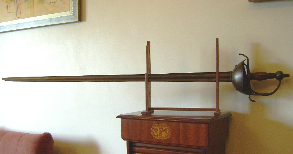

So this guy visited me last Saturday, to show me a sword belonging to a friend who wishes to get rid of it.
I look at it and asked the price, but he says it must be me to offer. I advance with a figure and (through the phone) the owner immediately accepts ... as long as i pay in the moment ... in cash.
This is why i went (again) beyond the expected Christmas budget and brought in this 'non looked for' addition to the house 'furniture'.

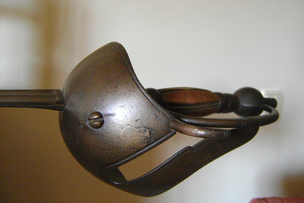

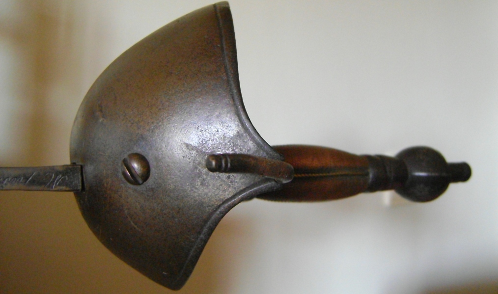

According to the books this is what the Spaniards call a mounted sword for cavalry model 1796, with barquilla con vela (boat and sail) guard.

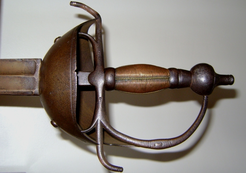

Looking to the descriptions and images available, it is an exception that the grip copper wiring is 'caged', not by the usual rigid iron bars but also by twisted wiring, this in brass.

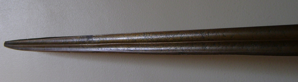

However and for me the great novelty is that the blade is a typical French one, made in the famous Manufacture de Klingenthal. I can trace blades for these swords being imported from Solingen, but not from France; i am trying to get comments on this situation from a Spanish expert i know.

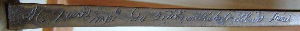

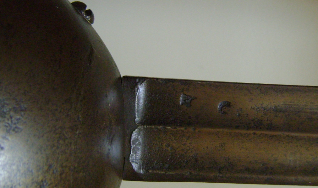

The inscription on the blade spine shows it was made during the Imperial period and the inspection poinçons (MOUTON and BEAUMARETZ) confirm its production date, that of 1803.
Although the sword model is named 1796, the date of 1803 was apparantly the first year of its appearance in the forces; the Spanish swords nomenclature functions that way.
This blade its rather lengthy, with its 93 cms, same as those of Spanish standard for this model; only that the basic version is double edged and this Klingenthal specimen is single edged, with two wide fullers ... like those in curved sabres, but in this case straight, with only a vestigial curve near the tip.
Please enjoy the pictures ... and post some comments, if you feel like .

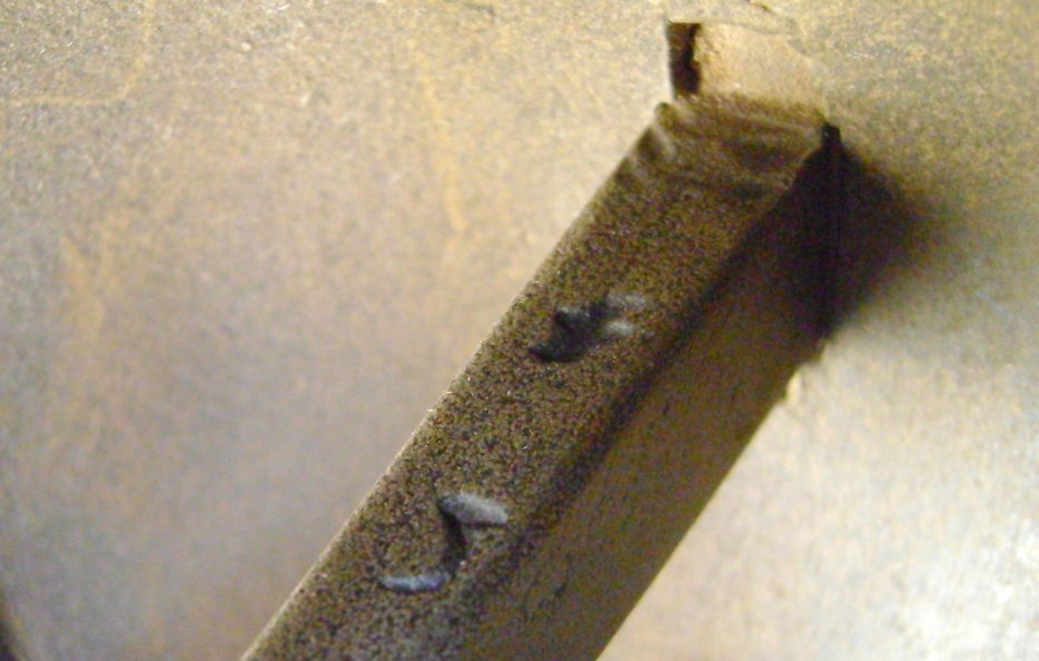

Old 26th December 2011, 02:59 PM   #2
The marks.

just a thought without any major evidence:
during the penninsular war, nappy put one of his brothers on the spanish throne, all looked well for the frenchies. could they have supplied blades for the 'new' kings troops? joe napoleon, i gather, wasn't very popular.
i'd like to think however that after the spanish army destroyed the grand armee of france at Bailén, killing about 6000 & capturing over 18000, including killing over 2500 cavalry during their vain attempt to escape, a lot of nice kleigenthal blades would have been available for conversion into preferred spanish forms.

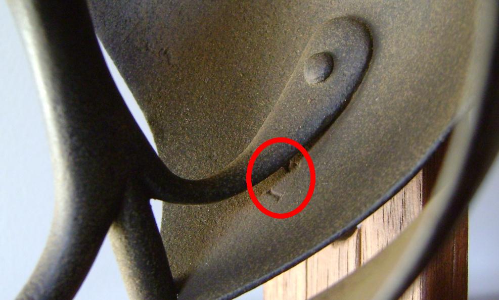

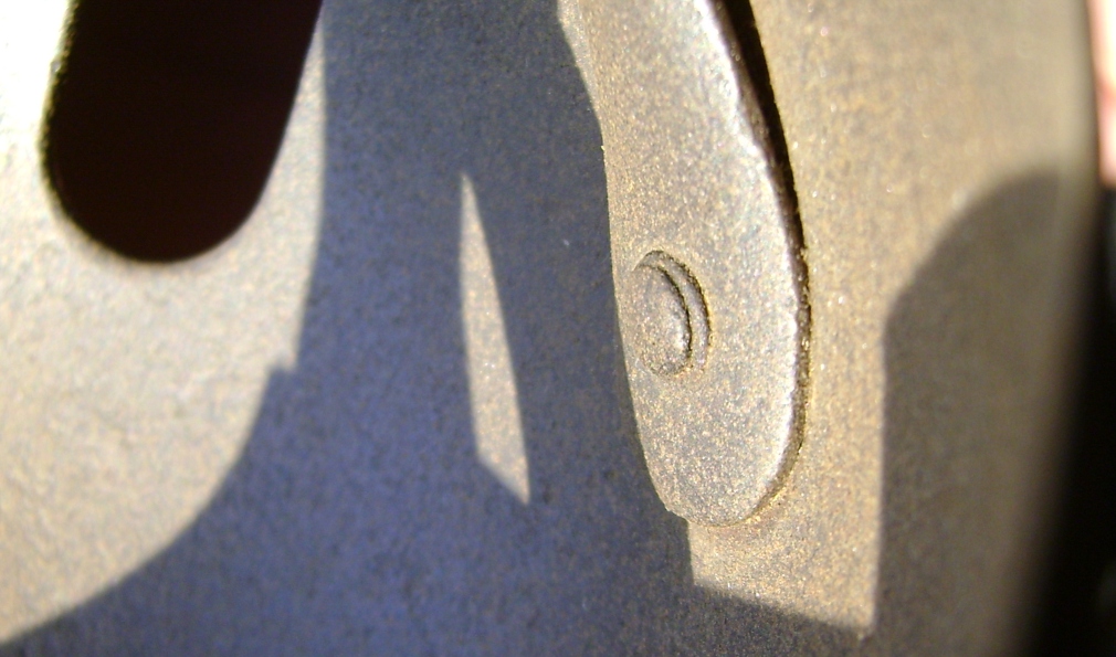

interesting detail - the two screws holding the 'sail' to the rest of the guard are slotted on the outside, but peened on the inside.

An absolutely magnificent acquisition Nando!!!!! and outstanding observations by Kronckew.There were indeed powerful French influences in play near the turn of the century, and actually the dragoon sword that was referred to as the M1799 was influenced by contemporary French sabres with the 'birdhead' type pommel/backstrap. This was the model that appeared in the 1803 text regulations.
This particular form of cuphilt was I think as you mention possibly called a M1798, but it seems that its classification is a bit sketchy. I think that Juan Perez has more on that but I hevent really reviewed his material from some years ago.
According to Chamberlain (p.83, plates 150,151) this type cuphilt was more in accord with earlier forms and as always revealed Spain's inclination to adhere to traditional forms. It seems these were possibly in use much earlier than the 1798 benchmark, and probably contemporary with the M1728 forms which have become known as the 'bilbo' for thier bilobate shellguard basic in hilt. These 'bilbo' type swords were the form most well known in New Spain as far as military dragoon swords, while the cuphilt style broadswords were well known among infantry officers primarily. Naturally in frontier environments there were few set standards observed conclusively.
With reference to your observation on the Alamo it is indeed unlikely this hilt form was present in the Mexican dragoon regiments there in 1836, there were possibly two, but offhand I can only think of one from Laredo. Mexico had won independance in 1821, and while still Spanish in basis as far as the regimental structure, arms were largely residual and imports.
The presence of the French cuirassier blade on this sword affirms it Continental provenance rather than Colonial.

Oh, i was about to second you in surprise about the fixation of the cup being 'screwed' by the outside and 'riveted' by the inside, but i took the sword to the (Portuguese ) sun and discerned some thread in its (half rounded) end.

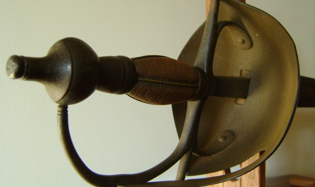

As with many regulation patterns adopted in military 'organization' the prescribed or more likely accepted patterns were often of forms which had already been in use, so assigning pattern dates was often a matter of perspective.
It seems that in the 1790s into opening years of the 19th century, there were actually several types in use by the Spanish military so though we know the period in use for them, designated date/pattern remains speculative.
By analogy, this was the case in England as well as they worked toward establishing regulation military patterns, beginning with the M1796 groups (though there were the M1788 patterns unofficially). While the heavy cavalry swords (from the Austrian M1769 pallasche) were clearly defined, the variations in some of the officers swords, Horse Guards etc. remained vaguely established and the light cavalry sabres had considerable variations, again primarily where officers were concerned.
Whatever one choses to designate this sword, it is a fantastic example of the sturdy Spanish cavalry fighting swords of the 1790s and early 1800s.
The French blade only heightens the intrigue in this historic piece !!

I have received Juan José Pérez feedback.
While he reminds that this blade model was regularly mounted on French An XIII line cavalry swords, he finds it difficult to define whether this specific composition was result of a period work done in Spain with a captured blade or a later work required by some sword enthusiast or collector.
He has added that this is the first time he sees this particular setup.

I am sorry to say that although the blade looks good, parts of the hilt at least are 1970's replica made in Spain for the wallhanger market. I owned one of these myself and so am familiar with the type. The original is a very fine sword in the Real Armeria, I think.
The sword is most likely a shotgun job of some age, made not to decieve, but for reenactment, or to replace the replica blade damaged in use, and then retired to the wall.
Quite a few of us did similar in the years before decent reenactment swords were made, reusing Kaskara blades, UK 1908 cavalry blades or anything else we could find.
