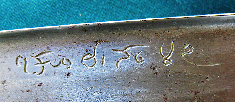

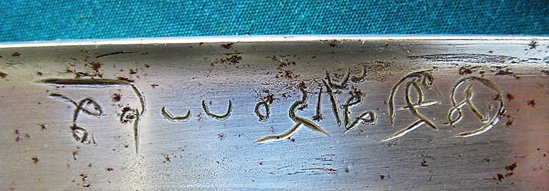

These two photos have been sent to me by a friend with a request to try to find out the translation..
I'm sorry, but he has not given me photos of the complete dagger. I have seen it, and it is a peshkabz type thing.
Is anybody able to assist with a translation of this text?
Thank you.

Hi,
Looks like a script from down South, from Andhra Pradesh or Karnataka.
Will check with a couple of friends who can read it.
The last two characters read "4" and "2" so most probably this should be some armory no. or something.
Bhushan

I've asked my Telugu colleagues here in Hyderabad (Andhra Pradesh) and they can't read anything beyond the last 2 numbers.

The script is not Kannada according to my wife...

It looks like 'Kanada' to me, perhaps from the Mysore armoury. Perhaps Olikara is on the forum and can help?
There are some similarities with this inscription: http://www.vikingsword.com/vb/showthread.php?t=159
Runjeet

I believe it is Kannada as well, and the dagger you refer to, has the same kind of inscription.

FWIW, Kannada is my wife's mother tongue, and while she admittedly does not fluently read it, she did grow up speaking it and surrounded by the language...
In the 3 1/2 years I've lived in India - all but maybe six months cumulative in Karnataka - I found I mistook Dravidian scripts for one another as often as I got them right.
Here's a link to the syllabic characters of the Kannada alphabet:
http://www.omniglot.com/writing/kannada.htm
ETA: Considering there is an unquestionable similarity to at least a couple characters in the inscription, maybe another dialect or colloquial language that borrows from Kannada script, e.g., Konkani?

A friend's father identified the script as indeed being Kannada. The translation is attached.
First picture (top)
I think this is in Kannada. It says: “Choo Ra Sam. 47” (Here abbreviated ‘Sam’ stands for ‘Samvatsar’ or year. ‘Choo Ra’ could be name ‘Shoora’ ( or valiant person)
Second picture (bottom) writing is oriented upside down
See this picture through a mirror. Now it looks as below. (I rotated the picture clockwise 360 degree)
In Kannada it reads as follows:
“Shri Krishna Sam. 1163” (Shri Krishna Samvatsar 1163) (or Sri Krishna. Year 1163)
PS: I am not 100% sure whether my interpretation is correct.
The "choo ra" mention is interesting. We use this name for the smaller variant of these pesh-kabz/karud type daggers, but we've heard that this word is not used locally used. Perhaps the name was derived by some early collector from a similar inscription.
Emanuel

I thank you most sincerely for the time and effort you have taken in providing this translation, Emanuel, and I offer my friend's thanks on his behalf.
Do we know what the year is in our calendar?
Old 28th February 2012, 02:46 AM   #20
Emanuel
Emanuel's Avatar
Join Date: Jul 2005
Location: Toronto, Canada
Posts: 1,242
My pleasure Alan.
1163 in the Malayalam calendar seems to correspond to 1988 Gregorian
If correct, then either the inscription is a later addition to the blade, or the whole thing is of recent manufacture - not unlikely.
