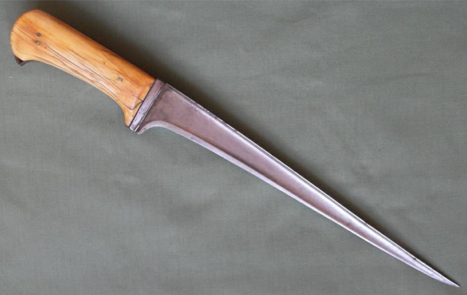

Just thought I would share my first attempt at bringing back this Blade.
Would welcome any feedback

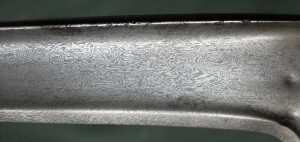

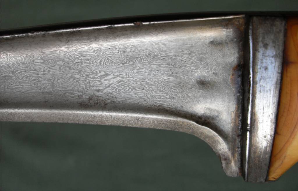

Excellent, Good wootz and good work. Well done.
Are there some small rusty spots left at the base and ridge? Make sure to clean those and wash the blade with warm soapy water after etching and also keep some oil on it for a while before final cleaning.

The small brown spots are a tiny amount of the varnish that was on the Blade.
I then gave it a metal wax, is that ok to use?

Salaams templarnight ~ Good work. Nice pictures. Please detail the procedure that you followed ~ ie vinegar or fruit juice or acid and how long did it soak etc... and how did you clean the blade after?...did you use 00 paper?... as Alex was saying... and what did you use to preserve the blade after?... such as sewing machine oil or preservation wax?...Thus forum library takes a step closer to perfection. Regards Ibrahiim al Balooshi

I used a fine wire wool to remove the brown varnish.
Then a fine grade 1000 paper, but only once or twice over the Blade.
I used Ferric Chloride applied with a toothbrush, constantly stroking up and down the blade. I done this for about 2 or 3 minutes both sides.
Washed with water, dried and used a soft cloth to very lightly polish.
Then applied Renaissance Wax to it.
Hope this is of help.
