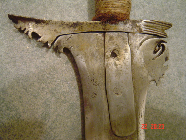

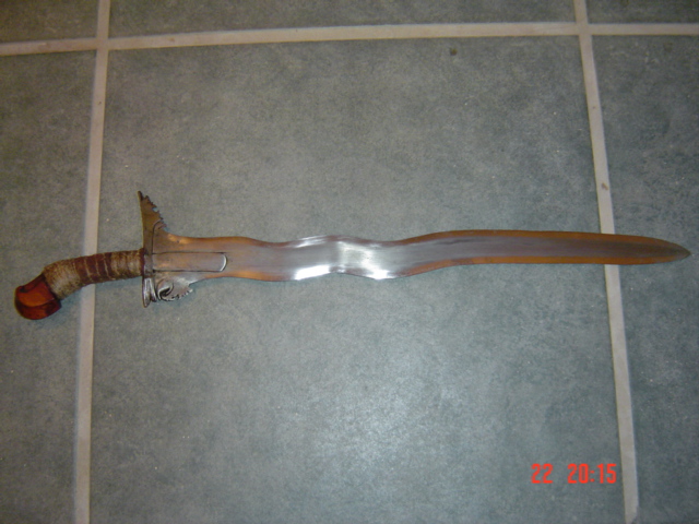

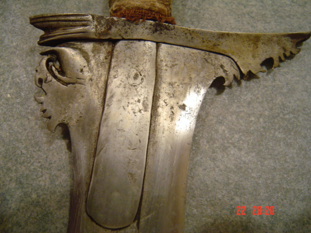

I acquired this Moro kris sword? a few weeks ago. Can anyone tell more about this sword? provenance and age may be?

I'll take a stab (every pun intended ). This Moro kris according to Cato would be very old, like 1700s, and is from around Jolo Island. What is interesting is that the tang appears to have been broken in the past and therefore a new one made long ago coming up through into the ganga bottom of the blade (an old form of repair).

On what details is your assessment based (originating from the Jolo area vs. Sulu archipelago in general)?

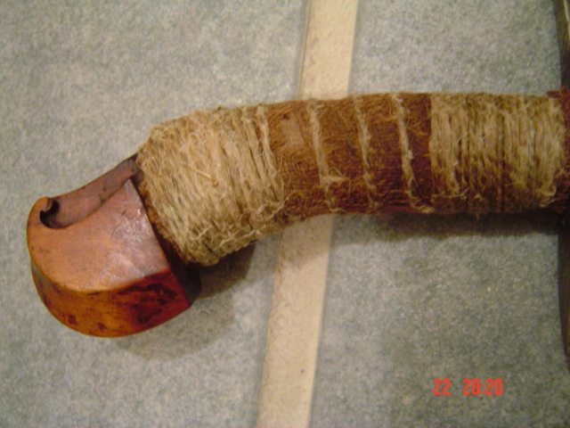

I haven't seen such an angled hilt with 20th (or even later 19th) century pieces. Is this an obsolete construction style or just very rare? I like this quite a bit (and am partial to "small" kakatua pommels anyway). How does it handle, Punal?

Could you please give the dimensions for this nice kalis taluseko?

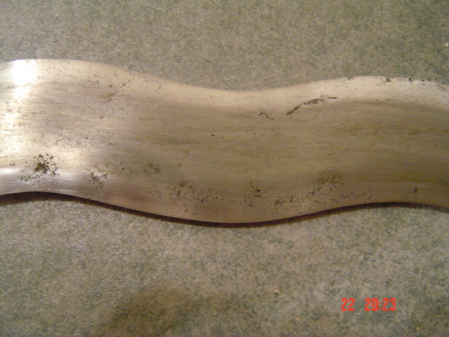

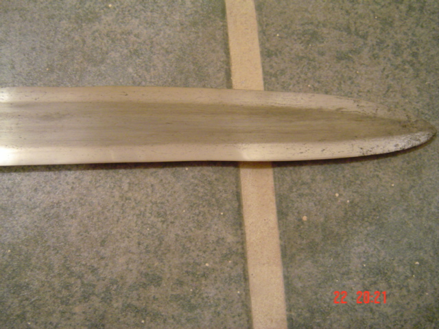

You definitely want to give that blade a light acid etch to reveal the lamination and possibly other forging details. (I hope the seller didn't use power tools to "enhance" the blade! )

Yes! that's the first thing I noticed when I first got it, the deep etch and there were also deep honing marks on the mid portion of the blade. It was also rust infested all over, I had to bath 'em lemon juice and used a super fine sanding paper everynight for a week just to remove the scrach marks
and thickened rust. The asang-asang was also missing, and there was atleast a 2-3mm gap between the gangya and the blade. I did a few strokes of filing just to evens it out but, I had to stop, I do gun smithing not blade restoration, I'm afraid I might cause more damage to it. I also used a polishing paste to polish the edge of the blade, for a little enhancement.

I wonder, this sword has ron dha and greneng which is much more alike to keris blades than the Moro kris. Could this blade possible be of Malay origin?

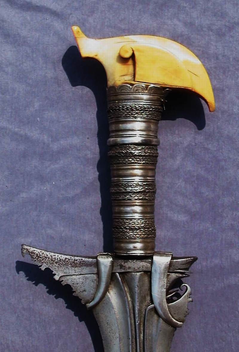

Posts: 6,441
Cool For Comparison
Sorry Nechesh ..

Hello Punal,
Did you remove the hilt? I'd be interested to know how the tang looks like...
Do you happen to have pics of the original condition?
It was also rust infested all over, I had to bath 'em lemon juice and used a super fine sanding paper everynight for a week just to remove the scrach marks and thickened rust.
It's usually sufficient to work on the blade with plastic brushes; super-fine steel wool can help to remove rust without removing remaining metal. I use wood and stag pieces to pry away stubborn rust spots. Only after complete cleaning, I'd decide on polishing or a restoration strategy if deemed necessary at all with such an old piece.
I'd still go for a final etch/stain to get rid of the shiny appearance.

Welcome Buwaya. These terms technically apply to the Indonesian keris, not it's Moro cousin, but since these blades are so similar in form we can get away with using them. You can see them more closely compared in the last 2 photos that Rick posted. We are referring to the filed out shapes on both the main part of the blade and on the seperate piece (which is most often called the gangya on Moro kris and the gonjo or ganja on Indonesian keris). Hope that helps.
