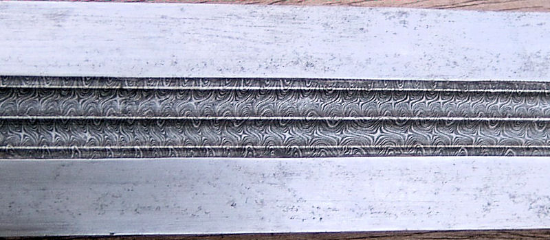

Just a short post that might be of interest, about wide flat multi fullered blades of a kind often called "shearing blades". Anyone who is familiar with Kaskara/Saif from the Sudan will know the type, often with half moon or other bladesmiths marks, usualy? made in Solingen.

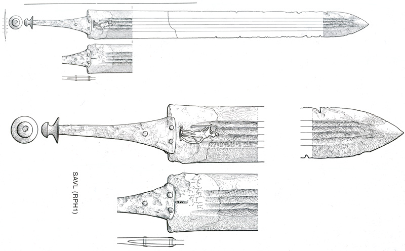

Imagine my surprise when I saw the pictured blade, from a second century context in Moesgard, Denmark. I had always thought them a late type, 17th cent. onwards.

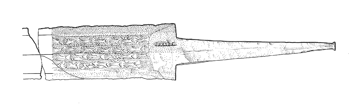

Note also the short tang with rivited on extension, a repair...or was it made like that.

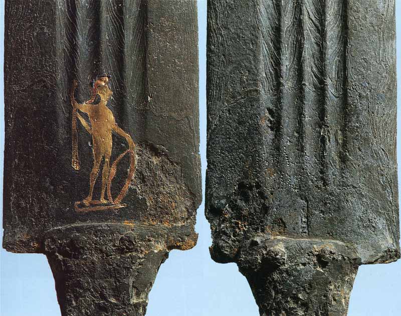

I am amazed that the gold or brass inlayed figure is still intact and clearly recognazable even after all these centuries!
Hi Stan
clear yellow like that, no mark of oxidation ... it's not brass or copper
it's GOLD

That would have been a very fine sword indeed, Beautiful pattern welded blade.

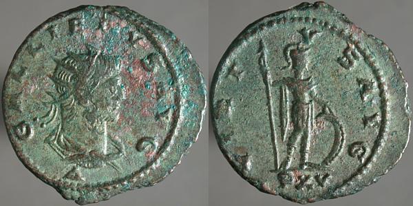

The figure looks like Mars to me.

I am inclined to doubt whether the colloquial modern term 'shearing blades' actually conveys the correct impression of an antique and top-ranking Damascus steel blade like this. Its quality is certainly among the best that I have ever seen. As a 'Late Medieval man', I wish we could learn more about this kind of early blades.
In my opinion, the blade seems to originate from the Viking era, and the riveted tang would be a later addition.

The excavators are pretty definate about the date, 2nd C AD, and confident that this and the bulk, if not all,of the blades were made in the North Western Roman Empire. Preservation in the Danish and Jutland bogs is very good for certain materials, and markedly poor for others, copper alloys in the display cases are bright. Wooden boards from shields and shafts from spears,and also some leatherwork, survive. The museum is a treasurehouse, as are the Nydamshalle in Schleswige and the National Museum in Copenhagen. For me, what makes this relevant to the "Ethnic" section is such an early appearance of a blade type we are familiar with in "Trade" blades, even to it's short tang, and the fact that it is in fact a "trade blade" itself, and probably made not that far away from Solingen.

Looks 'Roman' (Empire or Influence) to me.
The pommel nut doesn't look Viking.The standing figure matches Roman designs and the date of second century would certainly post-date the beginning of Roman influence in 'Denmark'.
Pattern welded blades of this type were certainly known to the Romans and many second century Roman swords were pattern welded. I think also various Celtic peoples were making them at that time. I have heard of other Roman swords with riveted tangs. Would seem illogical to be the 'norm' though.
