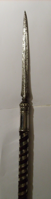

Today I was lucky to pick up this lance .
It was brought from Indonesia to Holland in 1937.

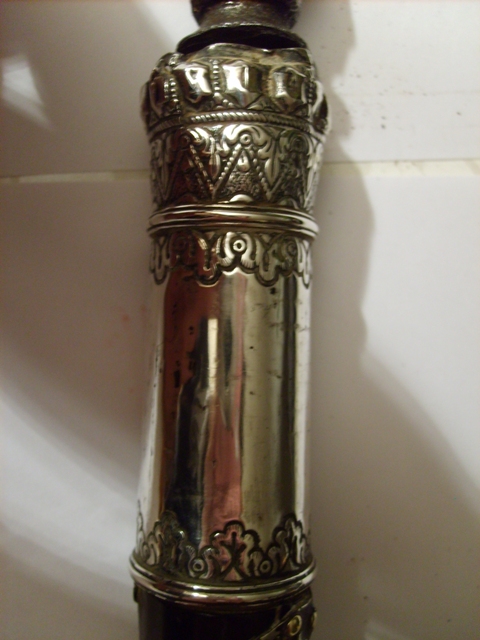

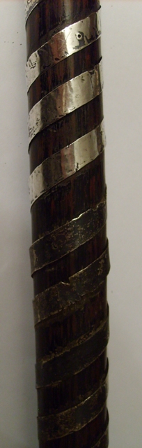

It has a nice silver collar and silver band all around down the shaft , I just cleaned some of it , it is a hell of a job

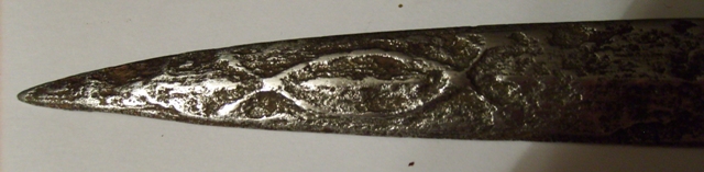

Also a nice interesting stamp/mark at the point !
Is there somebody who knows what it is, and what could be the origin of this one? , imo it is from Sumatra .

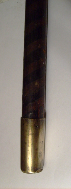

On the end there is a copper end cap , and it is a pity the last 30 cm of silver band is missing.
Total length is 2.55 m

beautiful spear. Sumatra is also my guess and Batak seems possible. just before I go through Zonneveld and read about a Lembing Raja (lembing = spear, raja = king), look page 82. Also when it look not complete identic is there a lot of parity.

I've seen a similar blade in the provenanced Borneo collection of Moller, also with a nice silver sleeve. But then, I never have seen such silverwork on a Borneo lance shaft like yours.....
A lembing Radja from the Bataks looks also different like yours...

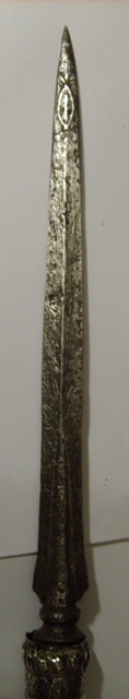

Also I never have seen an Aceh lance with this kind of silverwork on the shaft. Aceh lance blades are in general more smoothly forged, and not with that thick pamor on it (if we can call it pamor?)
I wonder if somebody could tell us more about the mark on the blade tip?
But with those silverwork on the shaft, very unexpected.......I incline and will vote for South-Celebes...

The lance head itself makes me say Java.
The silver collar is found allover the archipelago and beyond.
But the silver strip around the shaft is new to me and I can not place it in a certain area.

Like Willem said the point could be a Jawa tombak , still raises the question what about the mark ?

The silver strip makes it confusing , i will check out the RMV database later.
Maybe the patterns on the collar will give the answer ?

RMV Database number 135-1 .
look likes it have the same silver strips , the describe it as South Sulawesi .
