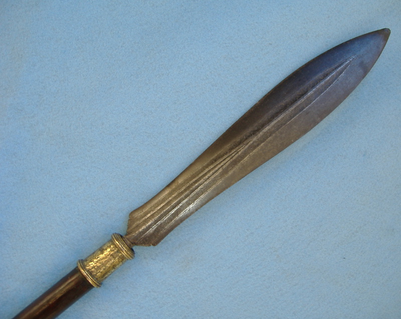

Hey is a nice spear I just picked up. My first thoughts from the pics I had seen were that it was Indonesian, but with it in hand I am not so sure. The blade is huge, almost 3 inches wide at the widest point. Note the blade has a design throughout the fullers, and features a smallish brass ferrule with designs. This spear is almost 8ft. long and has a simple iron toe.
Any ideas??? ....I'd be most grateful for any input.

Hi Charles, the fullering reminds me very much of forms found in the keris .
The blade of this spear reminds me a bit of a keris buda; so I think Indonesian is not out of the question .
The decoration within the fullers is the curve ball for me; it seems un-Javanese to me, at least .
I wonder, could it be from Bali ???

I'm with Rick on the Indonesian attribution. The chasing work on the ferrule looks Indonesian to me.

Nice catch (as always from you).
Please also enclose a close up of the fuller motif.
From a distance it resembles a Dayak motif.

Hope this helps...

Nice,
Here is the Dayak scroll motif I had in mind (lower part, from Nieuwenhuis' Quer Durch Borneo).
And below is one of my Borneo spears that also has a resembling motif like yours.
Yours seem to be a variation of the half tumpal (full tumpal is the center motif at the right, 3/12 if using the clock system)

Nice catch.
General shape and decoration indicate Borneo.
But a rather sofisticated malay area.
Can we see a close up of the ferrule ?

Here are two more photos that may help. I can certainly see the Borneo connection in the fullers from VVV's picture (...and thanks!)
The ferrule is very abstract...perhaps again pointing to Borneo...there seems to be a naga(perhaps???) incorporated into the design. You can see the "scales".
