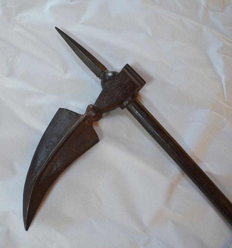

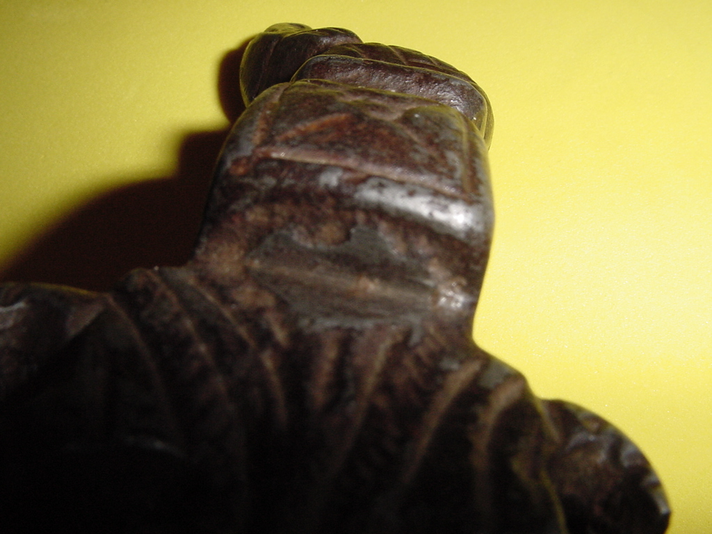

Here's a Zaghnal i got recently, about nine inches overall, with a five inch blade. I'm curious as to how they were made forged or cast? There are some
obviously cast ones recently on E Bay. This one is smaller and not as well
finished as this one at Oriental-Arms http://www.oriental-arms.com/photos.php?id=3588.

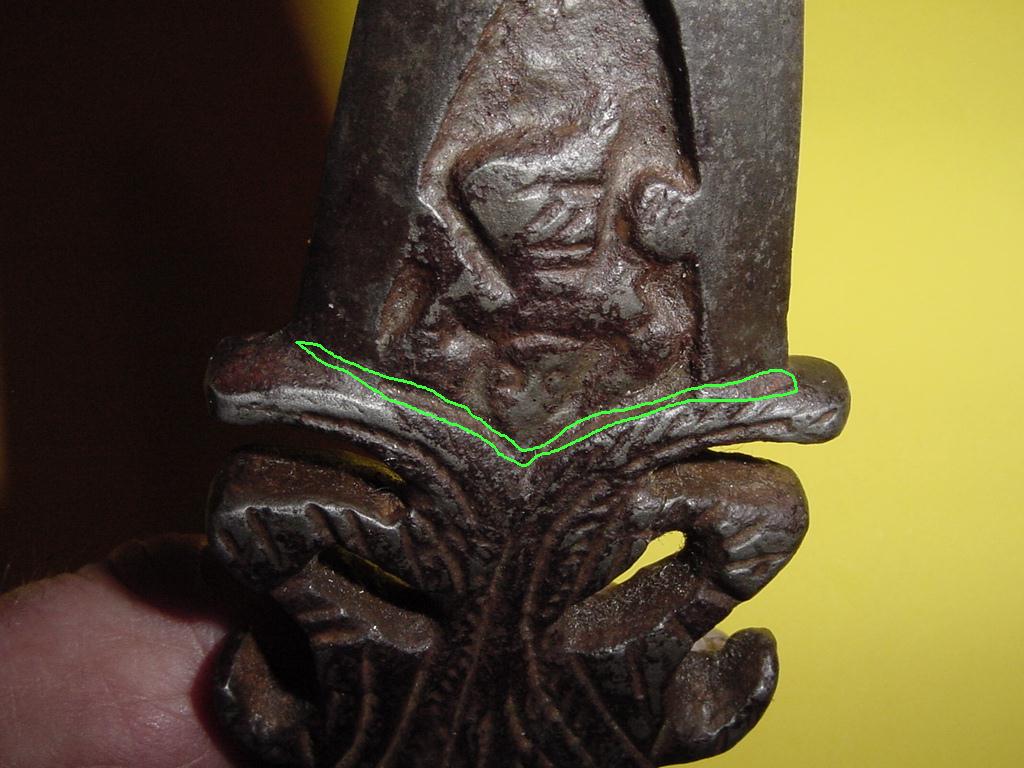

A first, I thought the blade was attached like chillanums, there is a solder like material at that point, it may only be silver. The second point of a
possible attachment is above the Tigers at the point a handle would be attached. So, my guess is it may have been made as two pieces.
Can anyone enlighten Me?

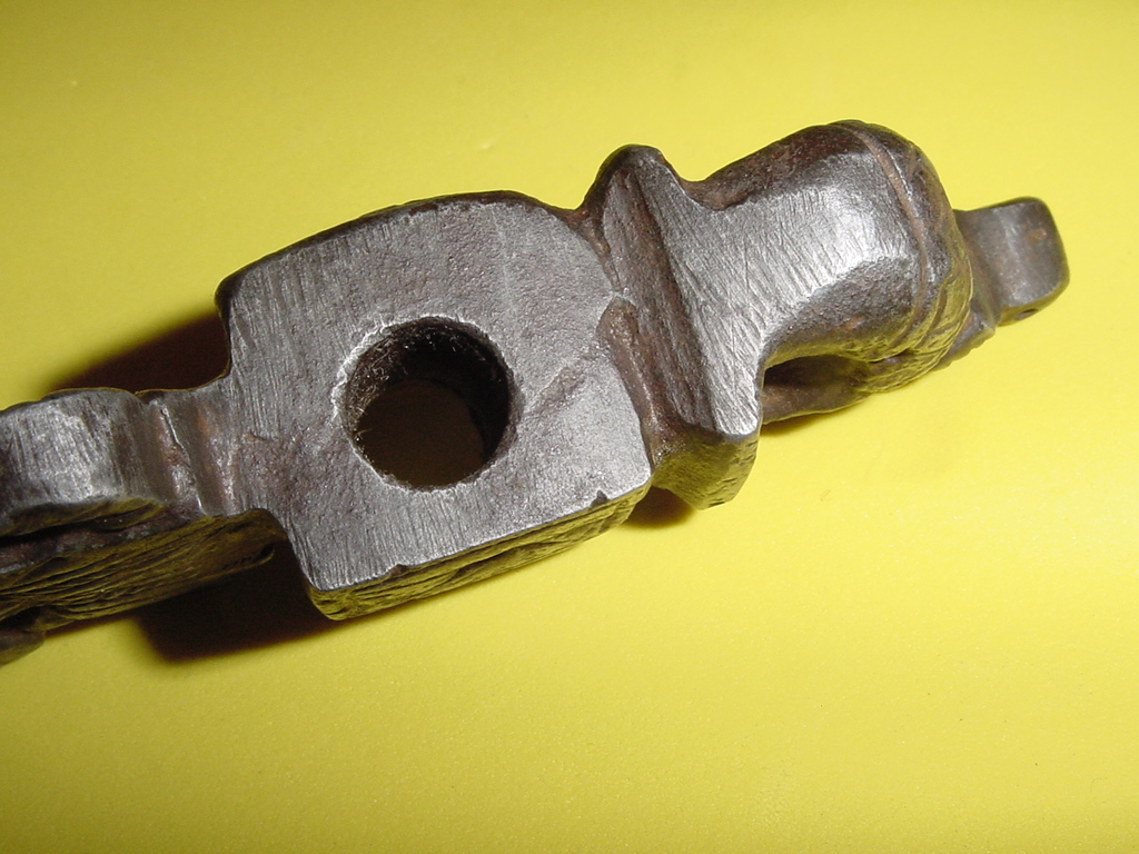

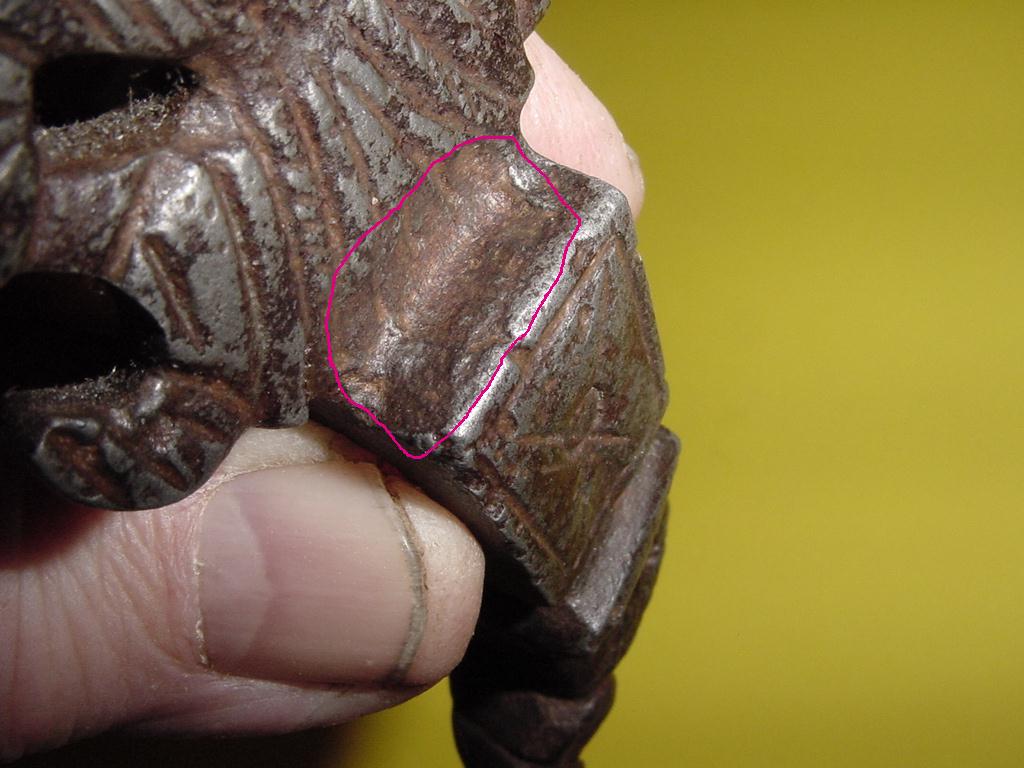

Hi Stan, I wasn't sure if it was part cast and the blade steel The areas, I felt may have been joined are still suspect. (3rd and 5th Pictures. Is there a less destructive way to test for cast without looking at the sparks from a grinder?

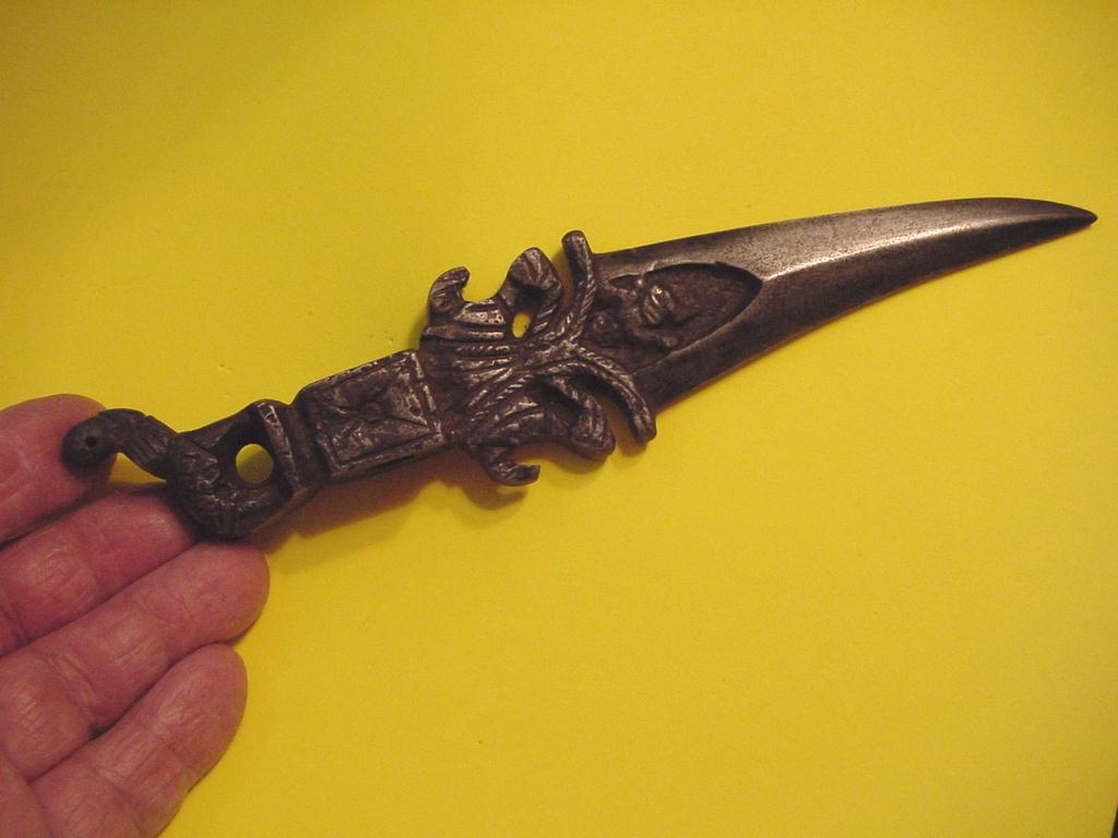

I did this one recently too all steel age ???
Thanks for the input I noticed the link I added did say steel elephant.
