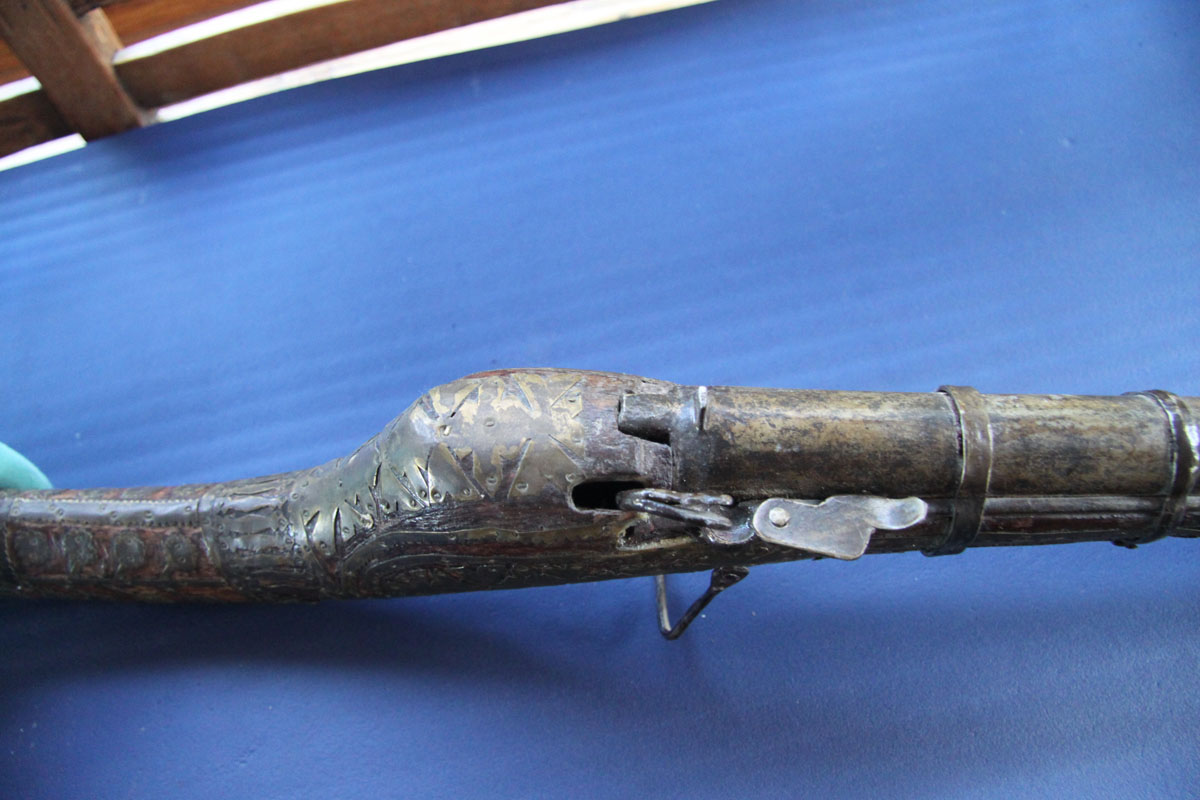

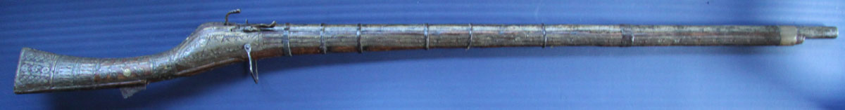

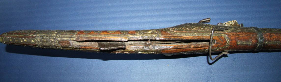

hoping that somebody could tell me more about this matchlock musket.
origin ?
age ?
any comment will be welcome.
Best regards
Cerjak
Old 13th January 2012, 07:15 PM   #2
Iain
Iain's Avatar
Join Date: Mar 2010
Location: Olomouc
Posts: 1,720
Looks like an Afghan jezail? Is that the trigger way back on the butt stock? I would guess the lock is Indian? Nice piece.

It is a jezzail for sure, what country, now that is the question. Afghan jezzail were mainly made out of Brown Bess locks captured from the Brits. This one to me looks African. Metal work and engraving does not look from this area. For sure it is pretty old.

This looks like a super piece to me. Not at all unusual with the matchlock ignition,and the trigger is usually placed back towards the butt on these matchlocks due to the simple pivot design. For flintlocks and percussion it is where you would normally expect it to be.
What I think makes this stand gun out from the crowd is the brasswork, most I have seen have been either almost undecorated or the kind of 'wedding gun' decorated with mother of pearl. So this one is a cut above your average jezail, at least in my view. The finer jezails also often have damascus barrels - you could be lucky

A similar gun previously discussed on the forum:
http://www.vikingsword.com/vb/showthread.php?t=12094
Old 14th January 2012, 05:03 PM   #6
Mefidk
Join Date: Nov 2005
Location: Denmark
Posts: 157
Wouldn't you know it - there is another with brass in a parallel thread here: http://www.vikingsword.com/vb/showthread.php?t=6578
Brass work very similar to this one, but with what looks like tower marked lock.
Mefidk is offline   Reply With Quote
Old 14th January 2012, 05:44 PM   #7
Ibrahiim al Balooshi
Ibrahiim al Balooshi's Avatar
Posts: 4,408
Salaams Mefidk~ Yes spot on.. The design is clearly the same on the butt section with "tree of life" decoration almost identical on both..
