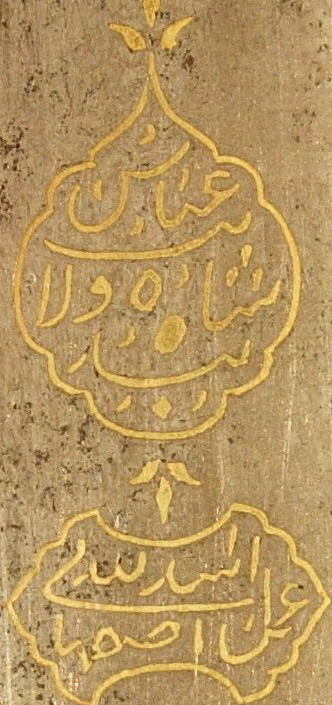

Hi..I'm new to this forum, and there seem to be some well-informed participants that might be able to help me identify a sword I recently received. It appears to be made of wootz steel with the Assadullah cartouche and the silver work is very nice... I would appreciate some help.... thanks!

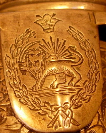

The symbol of lion with a sword and a sun on its back is Iranian, Pahlavi Dynasty, i.e. 20th century.
Assadullah 's name can be found on thousands of blades. However, the blade seems to be real Damascus, i.e. older than the handle with the symbol. Japanese used ancestral blades on military swords; why couldn't Iranians?

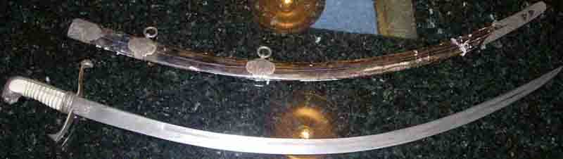

Can we see the entire sword?

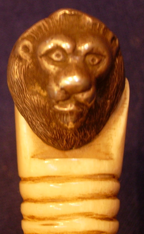

This is late 19th or early 20th century Iranian court work for an officer with strong European influence, as Ariel notes above it is mounted with an heirloom blade which is not unusual.
As to the Lion and Sun crest, this appears much earlier in an Iranian context. This particular rendering of it however is very similar to that depicted on period coins, an additional argument in favor of an early 20th century attribution date.
