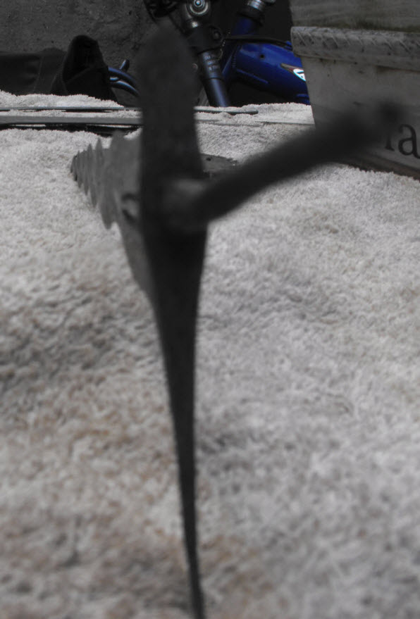

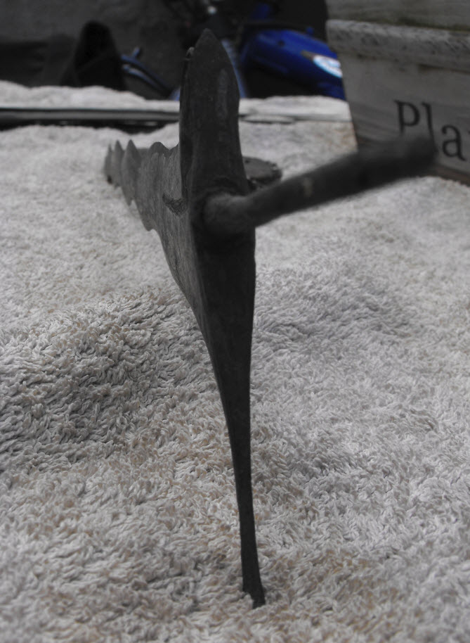

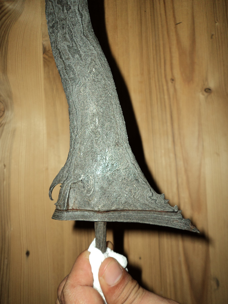

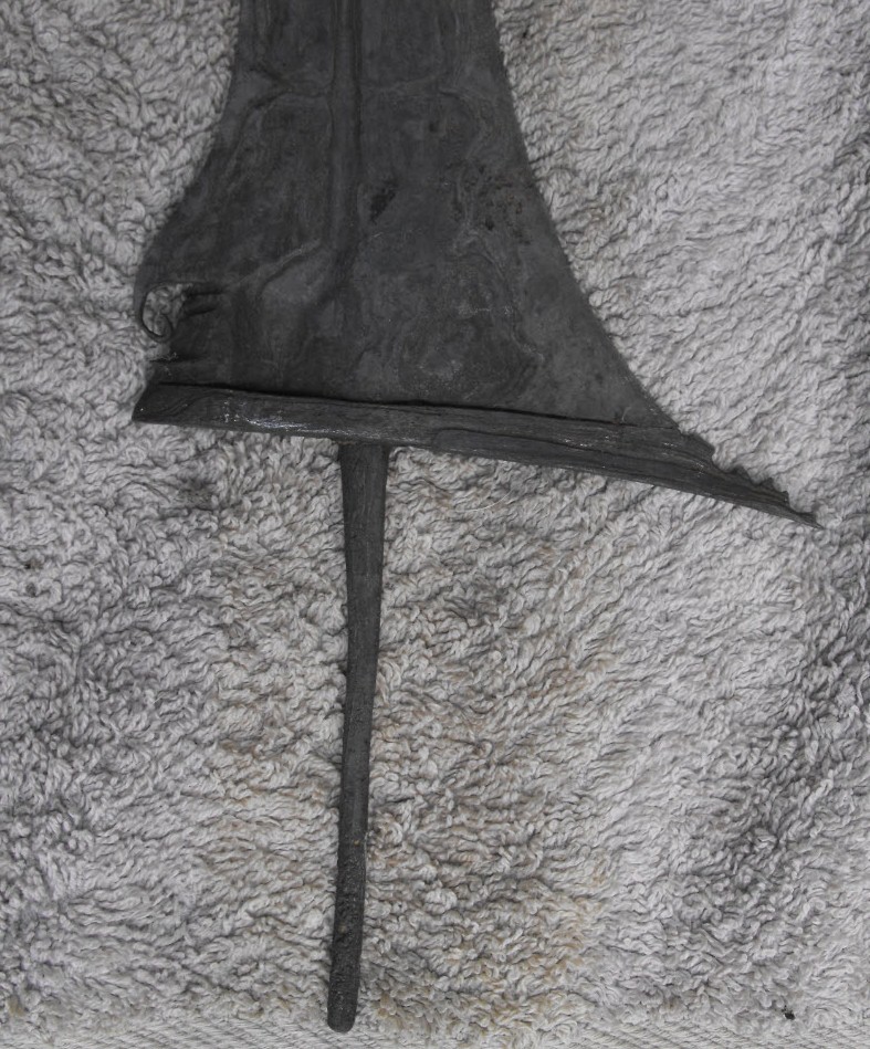

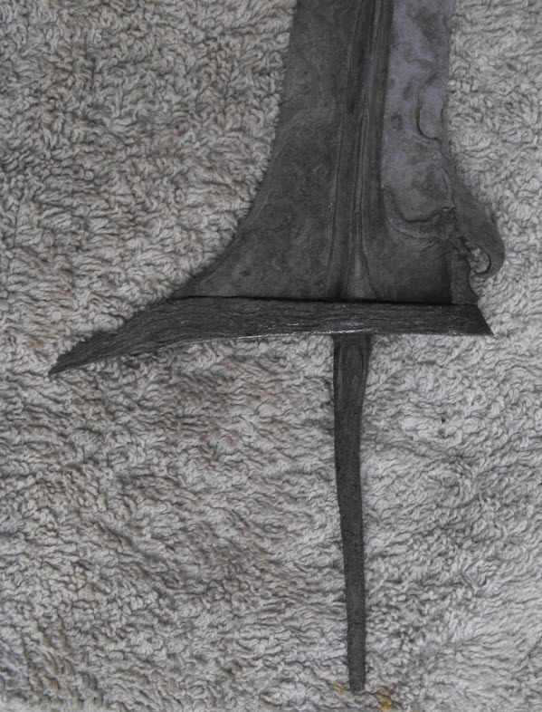

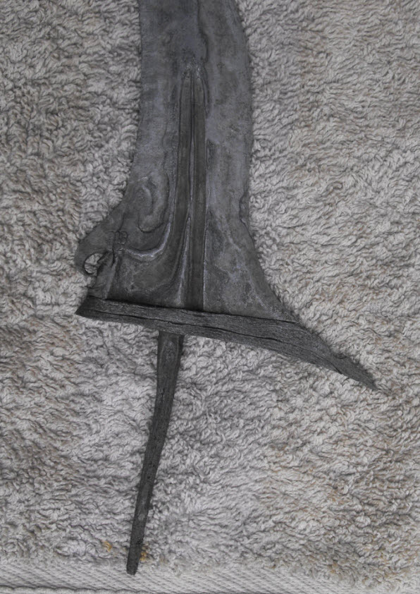

This blade is about 35 cm without pesi, when i bought this one they told it was from East Java/Madura, but i don't know if that is true.
Harley is offline   Reply With Quote
Old 5th January 2012, 10:48 PM   #2
Posts: 7,228
Yes, it possibly is East Jawa, I don't think Madura, very unlikely to be Central Jawa.
Not much of a blade, and nothing I can see to allow me to take a punt at giving it a classification.

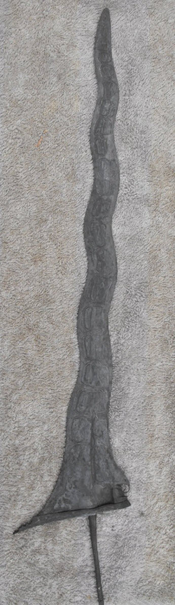

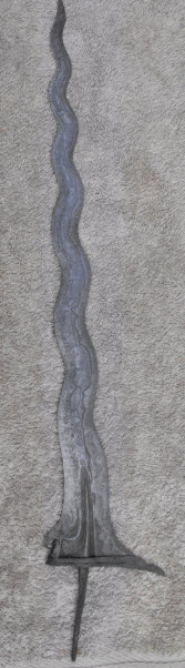

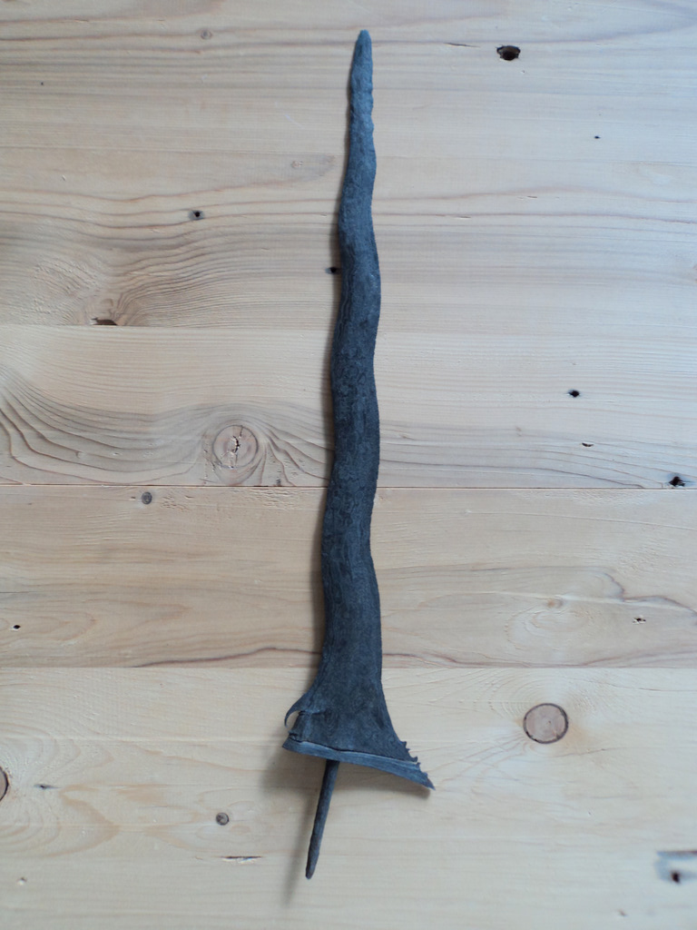

Thank you Alan, i shall place the third wilah here, because i think that it is a sort of the same as this one.
And i hope that this time i do it in the right way, but you have to scroll

Harley, this blade is vastly better than the previous one.
I am uncertain as to a classification, but I think possibly north coast, towards the west. Stained properly this blade would come up nicely. Not a bad blade at all.

Hullo everybody,
Harley, your blades that I have seen seem to come from the Cirebon/Tegal area. If all of them are similar, you must have had a field day buying them up.
BTW ..... if they are indeed from this area, then I would call them 'Sunda', especially if they are longer than 'normal' (i.e. more akin to the larger Balinese blades). The Sunda traditionally prefer their blades to be 'dry' looking. Hence they don't stain them.
Blades tend to be simple and not 'proud'/intimidating.
WRT to dapur, that's more difficult.
Cirebon has had the longest exposure to Jawa influence. So the blades tend to follow the prevailing pakem Jawa. Though there are still those who adhere to the old pakem. However, I have noticed blades which seem to be some form of 'marriage' between the two. Confusion? Or merely commercial opportunism?

That is a nice surprise!
Thank you again Alan, you're of the greatest help to me.
Hello Amuk Murugul,
To my untrained eyes they where similar, but it says more about me then about the wilah's i 'm afraid
I don't think they are longer as usual, this one is 35,5 cm(I forgot to mention).
I can Imagen that it's so difficult to tell something about the blades and even more when there is some kind of marriage between to different styles.
Thank you very much for your contribution!

Amuk, I cannot disagree that the second blade that has been posted may be able to be classified as Cirebon, however, in the system of classification that I was taught, Cirebon is not recognized as a classification.
The relevant classification that includes Cirebon is Pajajaran, and Pajajaran is sub-divided into at least three sub classifications, which are numbered, not named.
However, I am very reluctant to identify this second blade as Pajajaran, because although there are some indicators which point to Pajajaran, for instance, the bata rubuh blumbangan, there are too many conflicting indicators, and as the blade is out of stain it is impossible to appraise the nature of the pamor, which is a key indicator for Pajajaran keris.
Still, it may be able to be tagged as Cirebon. Regrettably I have never encountered a list of indicators for a Cirebon classification, either within the system that I was taught, nor anywhere else.
The first blade posted is quite dissimilar to the second blade. My inclination is to place it as East Jawa, but the quality of the blade is really too low to permit any sort of realistic attempt at classification, and from the photos I cannot even guess what the material might be like. In fact, it could be from anywhere, so if you feel inclined to place it in West Jawa, or Sunda, I will respect your opinion, but in the absence of indicators it is difficult for me to understand how you came to that opinion.

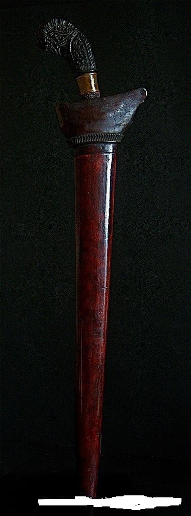

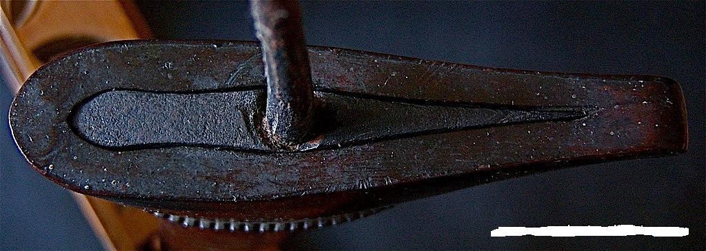

Alan,
The indicators of the blades attributed to tangguh Cirebon are described in the EK (page 463) but they are not very distinctive nor matching with the strong Cirebon blades especially.

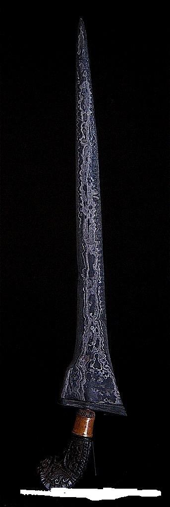

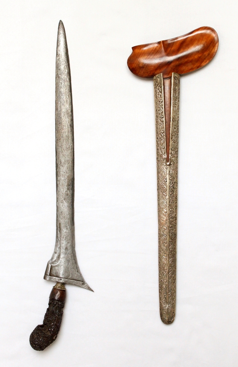

OK Alan, I understand and agree especially in this case as advised earlier; Would you consider that the 2 blades shown on the attached pictures are representative from Cirebon/ Northern Java? Both have old blades and old matching sheaths. The first one measures 47 cm without peksi and the second one 37 cm.

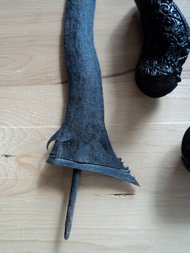

from what I know, Harley's blade could be east Jawa, Madiun area. Look at the luk sedheng construction as opposed to Cirebon's shallow luks.

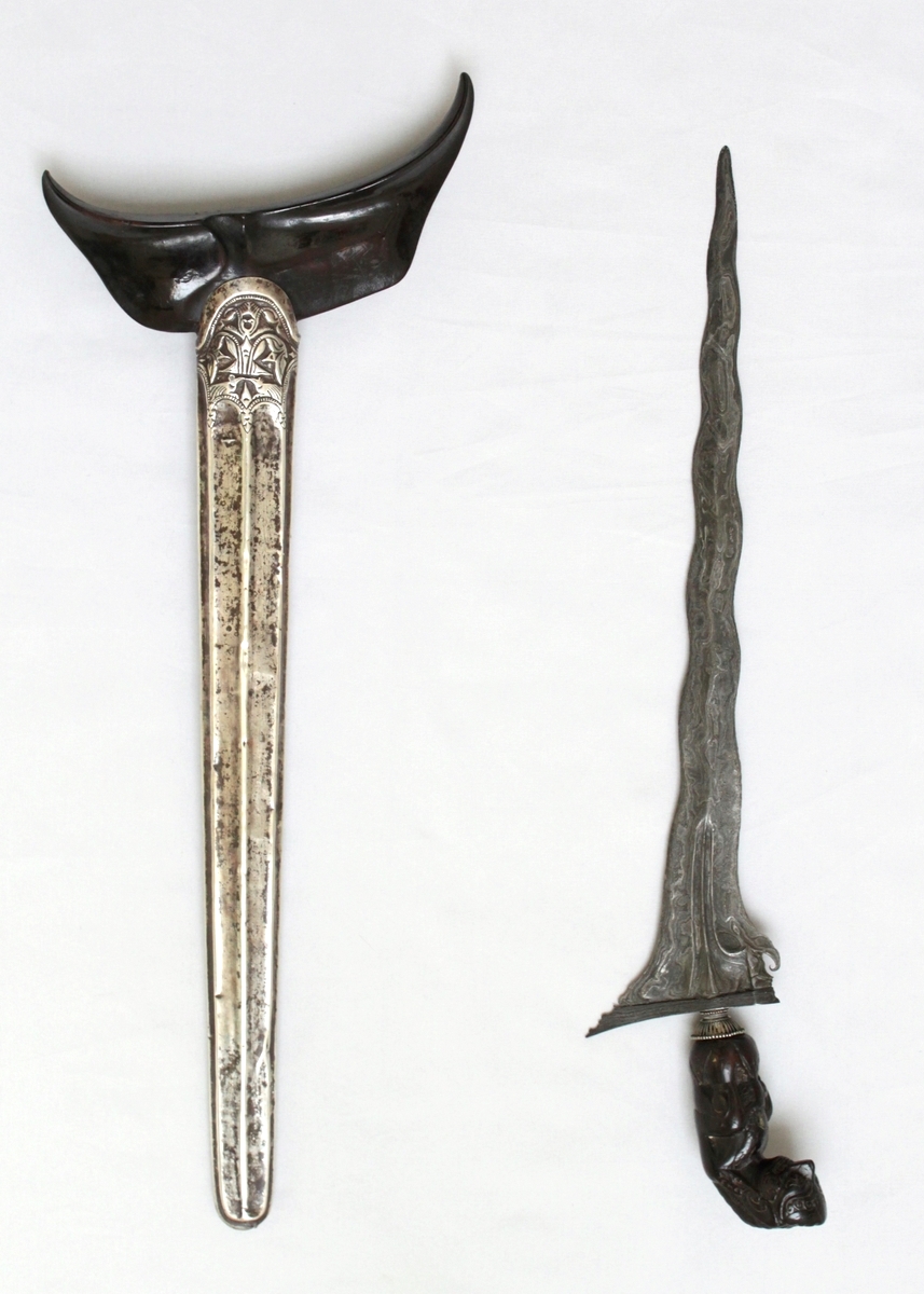

Best regards
This thread is on the way to become very very interesting!
Your second keris is a beauty Jean and to my humble opinion it is in all parts a genuine Cirebon/North-West coast keris. Like Penangsang write are the shallow luks are a good sign.

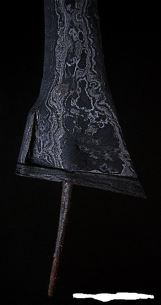

Old 7th January 2012, 03:16 PM   #13

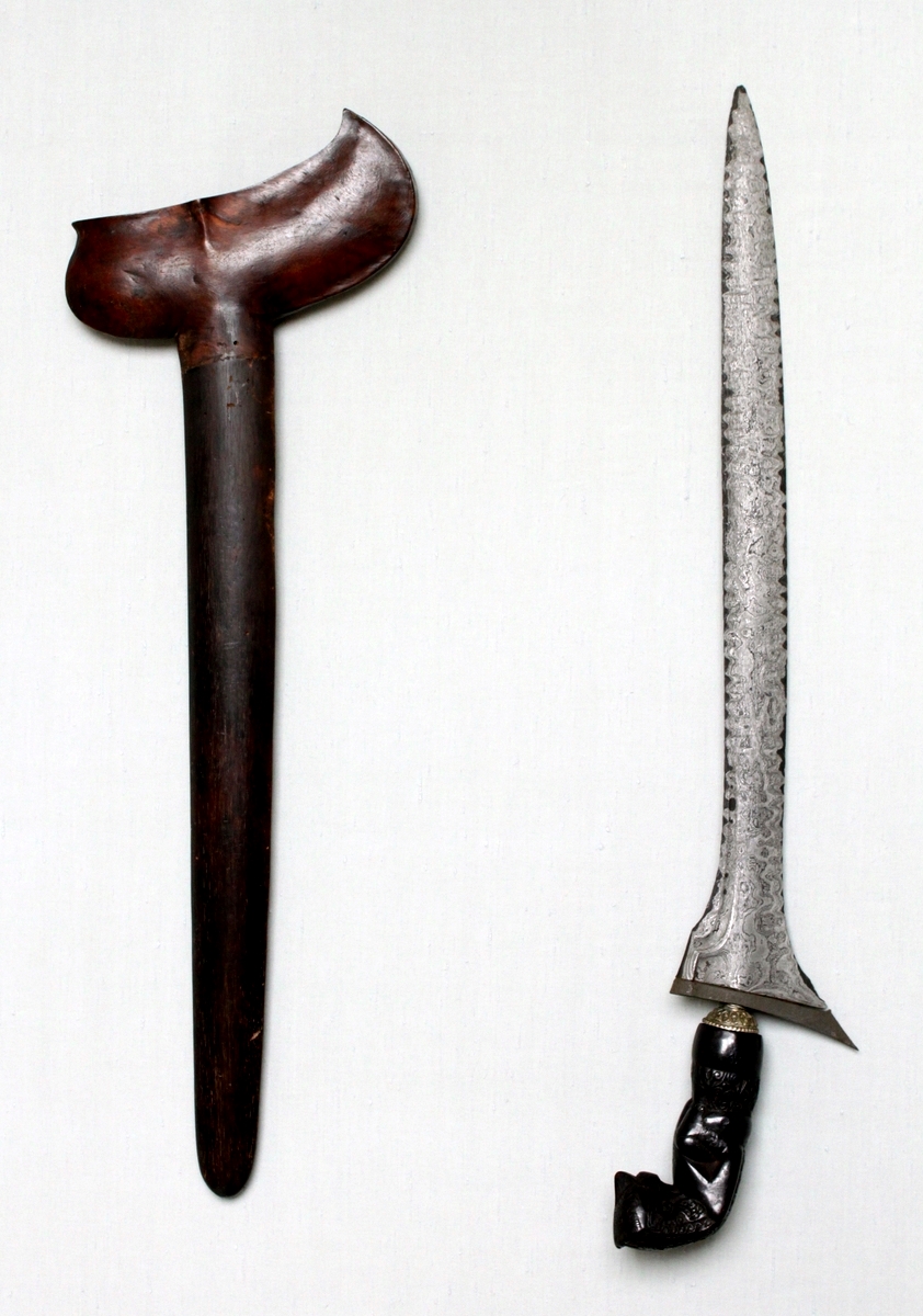

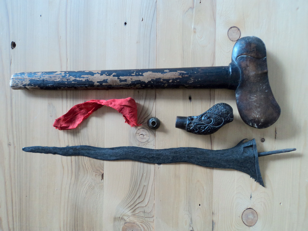

This keris I bought recently and think that it is a genuine Cirebon keris as well. Notice again the shallow luks.

And here the pictures of a Cirebon keris which was sold some time ago from a very good and trustworthy seller by ebay.

As well interesting since I have read/heard this before. And I have done an observation: Many (if I am able to say so since I haven't seen so much) keris sheaths from this region are painted (look my first example) or coated with something I don't know so that you can't see the wood. Someone else are able to confirm this? And why is it like this?

Jean, I don't intend to be difficult, nor evasive here, but I'm afraid that you, and just about everybody else who contributes to discussion here look at keris in a different way to the way in which I look at a keris.
You have shown me photos of two keris, one of which (the full pendok) is probably able to be classified as Cirebon, the other of which is possibly Cirebon, however, in respect of the blades alone, I am not prepared to offer an opinion on origin.
It is very possible that the full pendok keris has a blade that might be able to be classified as Cirebon, and comparison with Ben's blade is worthwhile.
In the Solonese system of tangguh there is no tangguh Cirebon.
Now, you Jean, and Detlef have posted some keris as examples of Cirebon keris.
What I can see is four keris that have elements of dress that may, or may not be Cirebon, and four totally different blades.
Bear in mind:- when I am talking about a classification, or tangguh, I am addressing only the blade, and what I can see in these examples are four blades that bear not the slightest resemblance one unto the other.
As I said at the beginning of this post:- I look at keris in a somewhat different way to most other people. Because of this I regret that I am unable to provide a supportable opinion in response to the question you have raised in your post #10.
Hello Alan,
Thank you very much for your detailed and logical reply. First I apologize for not having shown more detailed pictures of these blades as it is a bit difficult for me at present, but it would probably not have brought much additional information regarding their classification. However I can take additional pictures of the sorsoran and ganja if you deem it useful.
My question was supposed to be simple but it ended-up to be much more complex than I expected!
Regarding the straight blade, my point is as follows: I agree that it is not distinctive in terms of dapur and pamor but it seems an old blade measuring 47 cm long excluding the peksi, so could it originate from another area than Cirebon/Tegal? (such as a manufacturing center). Of course these blades are quite rustic ones and were not made by empus. I have and have seen several similar ones (see another example).
The Central Javanese tangguh system ignores Cirebon and Banten although these two centers constitute a very reliable source of genuine old krisses dating from the 17th century brought to Europe by the traders and now found in the museums and old collections as shown in Jensen's Krisdisk.
Best regards

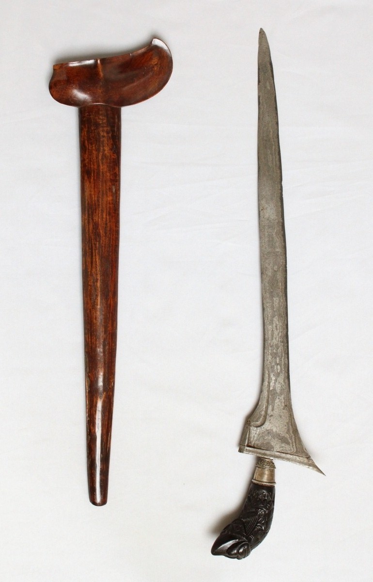

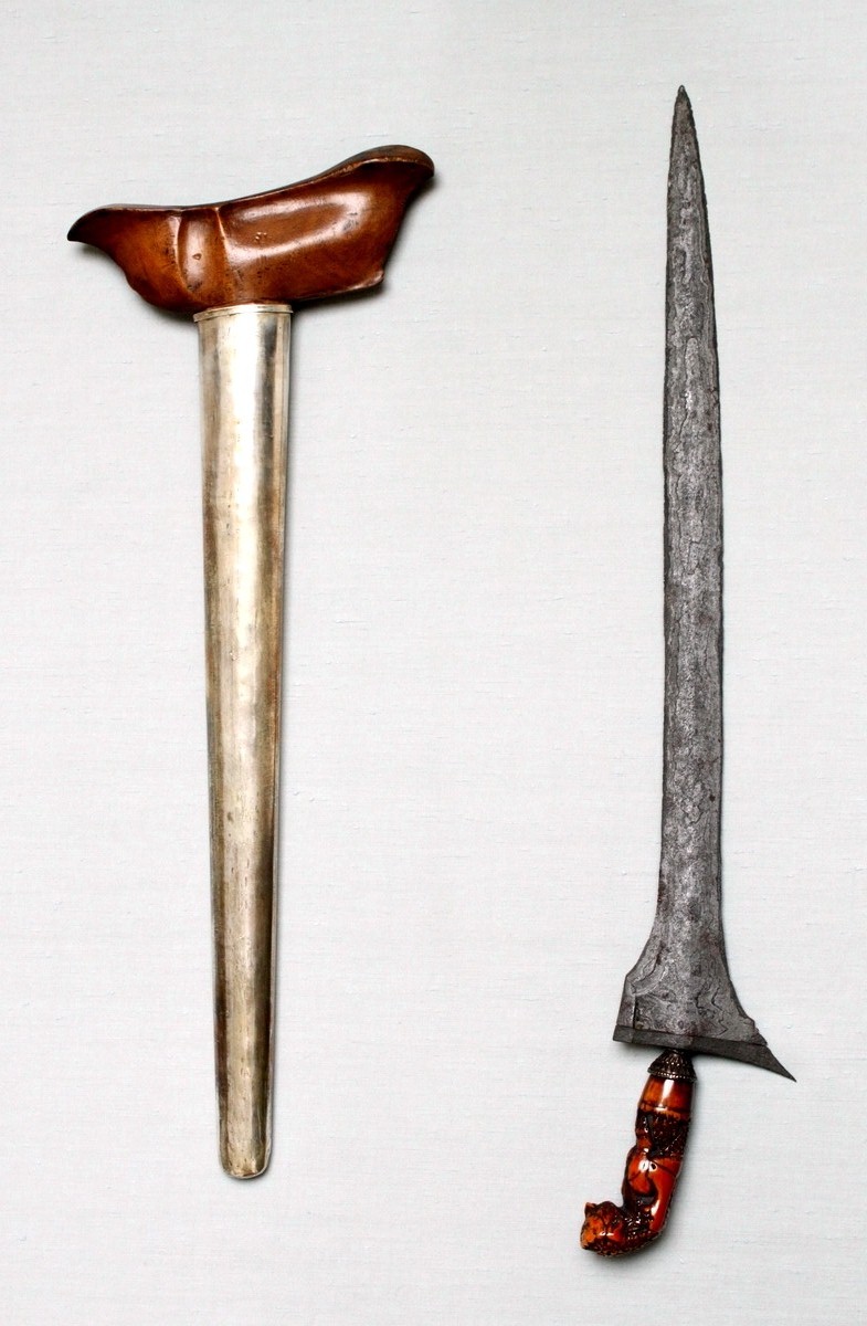

Post #10 unable to be definite from the photo, but it appears to have some characteristics which could indicate Pajajaran (now corrected)
Post # 14 classifiable as Tuban
Post # 17 this blade displays some Mataram characteristics, as is usual, it would need to be handled for any certainty
But the important thing is this:- each of these blades is totally different one from the other, to my eye, no similarities at all, except that they are keris and straight. To my eye these keris are total strangers to one another.
Two of the waved blades are similar:- the blade in post #1, and the blade in post # 10.

Post #14 unable to be definite from the photo, but it appears to have some characteristics which could indicate Pajajaran
Alan, could you clarify this. You named 2 blades as post #14, but that post only contains one blade.

You first say that the blade in post # 14 may be from Pajajaran and in next sentence from Tuban, I think that you mean post # 10 may be from Pajajaran and post #14 from Tuban, please confirm.
To my eyes, the blades shown in posts # 10 and # 17 are quite similar (the style of tikel alis for instance), however # 17 is more recent I think, and the differences may only come from the village smiths who made them. If you held # 17 in your hand, you would probably disregard the Mataram classification because of its size (43 cm without peksi). I show you two other similar blades for reference, the first one is 42 cm long and similar to post # 10 and the second one 40 cm long and similar to post# 17 (more recent).

Yes Jean. Wrong number. Written down correctly, transcribed incorrectly. I was up at 3.30am yesterday, drove to Sydney for a meeting, round trip of about 500 km, came home, watched Zulu, and wrote my post sometime around 1am. It was a long day.
Jean, the tikel alis in the two blades in posts # 10 and # 17 are about as different as Javanese tikel alis can get --- at least, according to what I can see on my screen they are. If we examine the tikel alis in #10 it appears to terminate in line with the tampingan, and in the hand, there would probably be a nicely rounded curved edge rising up into the gandhik. This style of tikel alis is what we regard as the "new" style. Apart from the way in which it terminates under the gandhik, the line of the tikel alis down (or up) the blade appears to curve gently into the blade edge, and to taper.
Now look at the tikel alis in #17. This tikel alis terminates past the tampingan and in the hand it would probably give the appearance of flowing openly through to the front of the keris. This is the type of tikel alis that we regard as the "old" style . Then look at the line of the tikel alis down the blade, it is more or less straight.
Then look at the radius of curve in the tikel alis on both keris:- utterly different.
Then look at the proportion and style of the sorsoran on both keris :- utterly different.
The proportion of the two blumbangans appears to vary.
The wadidang appears to have a different radius.
It is difficult to appraise the shape of a sirah cecak from a side view, but I feel that if we could look at both sirah cecak from above, there might also be a variation in form here, too.
I feel that examination of #10 with a loupe would possibly reveal that the edges of the pamor show a minute gap between pamor layer and core; I doubt that the edges of the pamor layer of # 17 will show a similar gap.
Yes, it is certain that where a blade is not produced by an empu or a pandai keris, variations in style can occur. Variations in style can also occur between equally skilled empus working during the same period, but these variations in style are minute, the variations in style that we are looking at in the two blades under discussion are immense variations.
To anybody who is used to following Javanese standards of appraisal, the differences of style between these two blades is immediately obvious and must place them into two totally separate categories.
