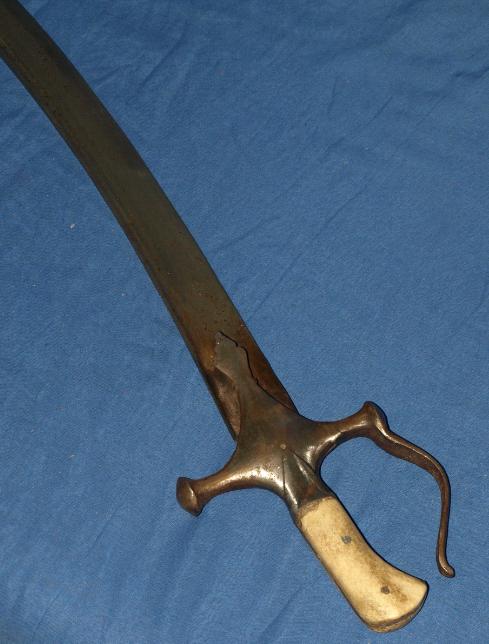

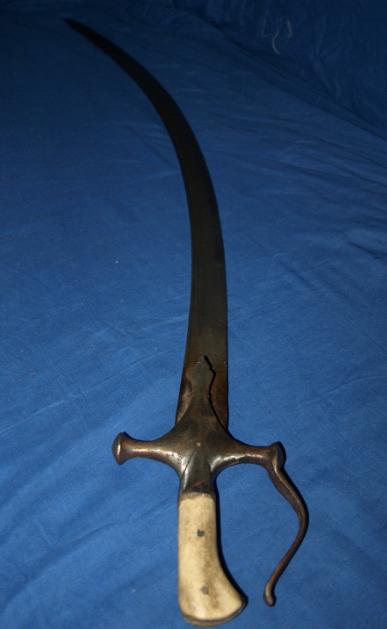

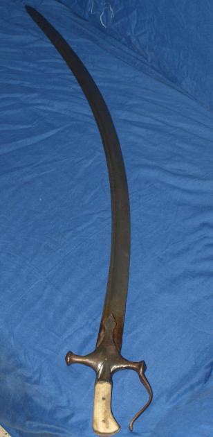

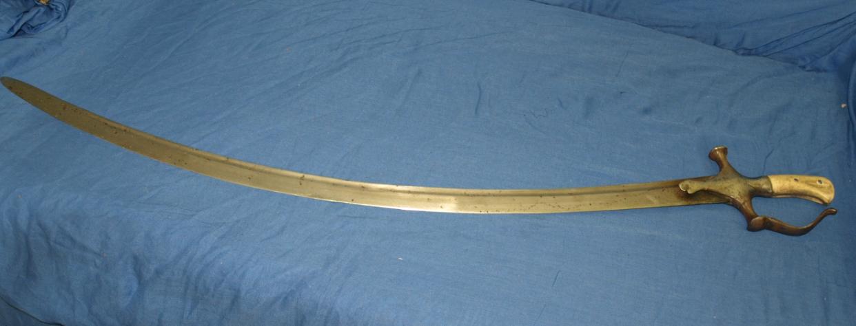

Hey All,
I bought this Sword in northern India about 2 years back, and since then i am trying to identify the origin of this sword. The following are the detailed attributes.
Blade - Made of Sukhela (mild Indian steel) and measures 32 inches long.
Full tang, Riveted to the Hilt and Jammed with Resin.
Hilt - Made of Barasingha (reindeer) Horn. The knuckle guard is attached to the quillon.
Thou the hilt has typical talwar features, but it lacks the bottom disc, and The lower 'beak' resembles that of a Shamshir.
The Overall design resembles the Indian Talwar, But The hilt and the curvature of the blade are two features which are unlike the Talwar. I have been trying to search for a similar sword but have not found one which looks like this one.
What could be the origin of this sword ?
has anyone seen a Sword like this before ?
Please provide your valuable inputs
Thanks
GST

Hi GST,
I would say a shamshir blade ..... a deliberately modified or 're-used' damaged tulwar hilt with the disc/pommel missing ... and obviously horn slabs rivetted to the tang to complete the hilt.
I am saying shamshir blade due to the fact it does not have a rat-tailed or similar tang that the tulwar would have had.
Whether this was a later marriage ('bitsa' sword) or one born out of necessity and, therefore, part of its history isn't clear, I'm afraid.
Kind Regards David

Posts: 6,339
I see an Afghan influence in the hilt scales .

Posts: 227

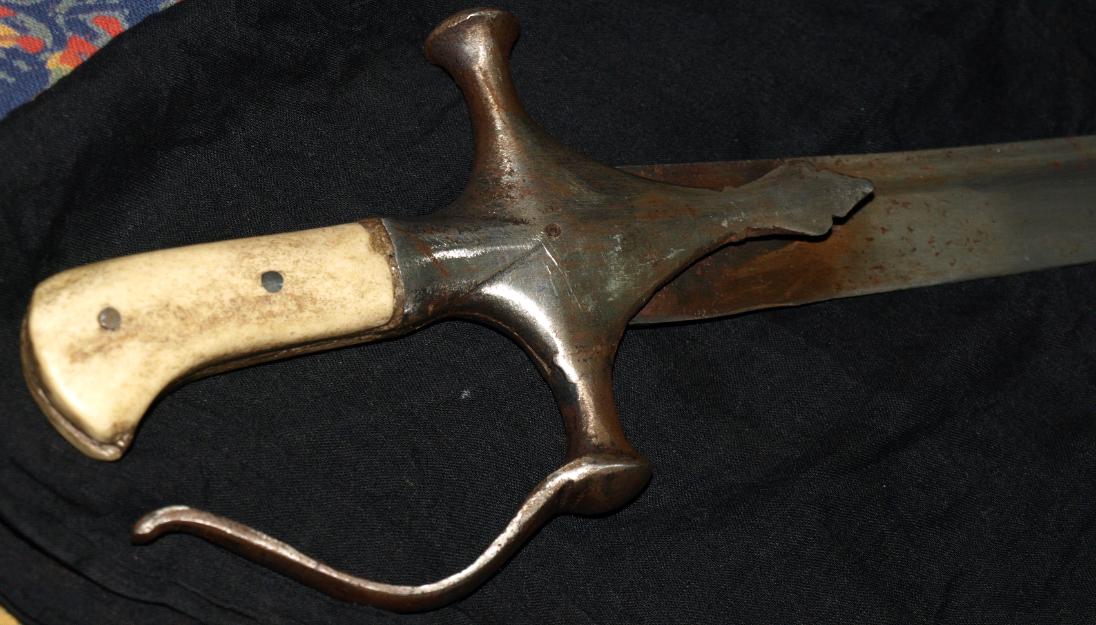

The best way to tell tulwar from shamshir IMO is to look for the presence of a ricasso (the unsharpened area at the base of the blade). Ricasso on this type of blades is a unique feature identifying a sword as a tulwar. If the blade is sharpened evenly all the way to the hilt, it can be called a shamshir. From the pictures you provided, it does not appear that the ricasso is there but perhaps I am just not seeing it? The hilt shape. although not a typical one, definetely points at Indo Persia as a country of origin.
In conclusion I'd like to say that it is is a lovely and unusual sword you have there!

Posts: 4,224
my initial impression (before reading the other replies) was/is afghani.

Posts: 2,928
I can't say with total certanty, but this style of hilt is in my experience a modern hybrid design. A way to spruce-up the simple steel Tulwar hilt and (i assumed) to make it more comfortable and widen it's appeal to modern buyers (including the export market).
I believe that the similar examples I've seen hail from Rajathan, N/N-W India.
If seen similar hilts described as being bone or camel bone.
That said, I can the others points about Afghan similarities and it wouldn't be much of a stretch to place it in Afghanistan and make it a 'Taliban Tulwar'.

Posts: 10,282
GST welcome to the forum! and thanks for posting this unusual example...gotta admit I hadn't seen anything with reindeer horn before!
Totally agree with the consensus here, a tulwar which has been redone with this hilt to become a rather appealing unusual example, and most likely in Afghan regions.
A tulwar I would say.

Posts: 1,340
What Jim said pretty much. But am interested in the blade, its missing a riccaso which makes me think its not indian manufacture?
Old 24th November 2011, 04:10 PM   #9
Posts: 10,282
Spot on Lofty! Exactly as Stan pointed out in his post, characteristically Indian made blades will have that distinct ricasso which was effectively to allow protection for the forefinger often wrapped over the quillon in Indian sword technique with tulwars.
This is more likely an apparantly well worn European blade, and not likely Persian as it does not actually have the features of those shamshir blades.
Even when 'tulwars' are mounted with shamshir blades in India (quite common actually in Mughal courts) they are typically termed tulwar as this is of course the word in general for sword there.
There are tulwars with Persian style hilts rather than the Indo-Persian disc pommel types, again called 'tulwar' but with Persian form hilt noted.
I would add here that in Tirri, there are examples of tulwars sans the disc pommel which he notes are removed as per Afghan fighting preference, which seems correct. I have actually seen tulwar forms which appeared to have been produced without the pommel disc, one in discussions with a British Brigadier who took it from a tribesman in fighting on plains near Khyber regions in the 1930s.
Terminology in ethnographic weapons can be maddening!!!

Katana / David & Atlantia - Thanks for your response. Initially i thought the same that this was a remodeled or restored Tulwar, But whats contradictory is the fact that the blade is 32 Inches long and the Hilt is over 5 Inches long, The full length of the Blade being 37 Inches. If we assume this was a Talwar and was later modified, it would have been close to 40 inches, Including the 'Rat Tail' Talwar Tip.
I have not seen many Talwars over 36 Inches (3 Feet) long.
Secondly, The Blade is not the usual tempered Steel or Leaf Spring bar, Its made of a Mild Indian Steel called Sukhela. Thou its not rare, but it isn't common either. It has a fantastic temper and it can flex amazingly yet retain its shape. The elasticity of this blade is phenomenal. I wouldn't wish to modify such a Blade just to make the sword more appealing to a buyer..But however, thats just my opinion.

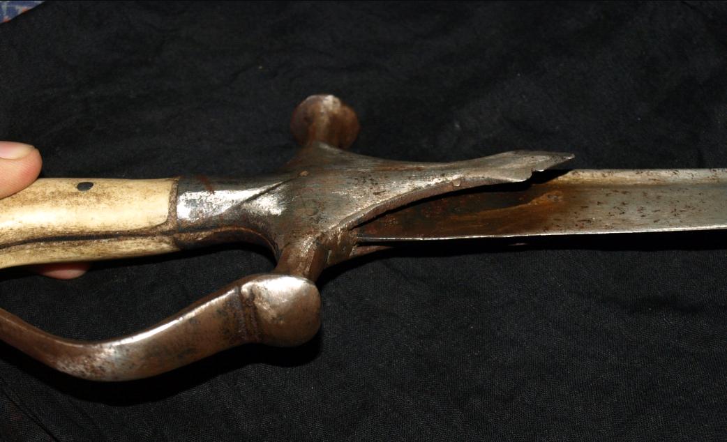

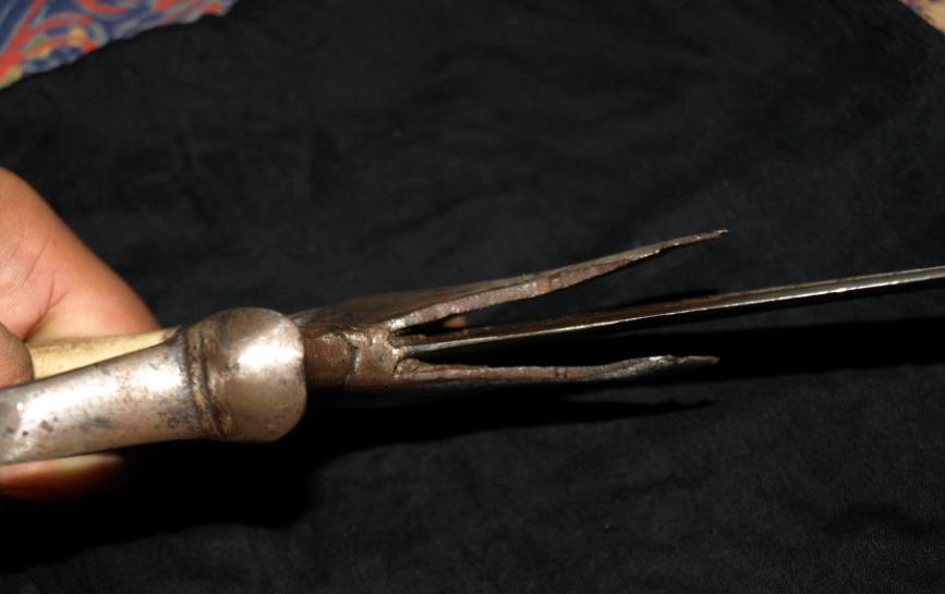

Rick & Kronckew - Many of my Friends and i had the same impression that it was an Afghan sword. But the unique characteristics of the Hilt just confuse us.

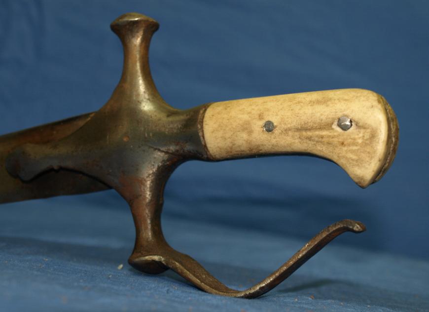

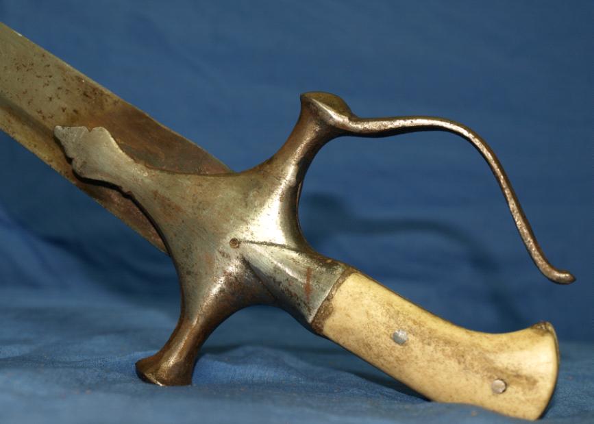

Stan. S & A. Alnakkas - The Blade does Not have a Ricasso. Thats another striking feature about this Blade. 90% of the Indian Swords (pre or Contemporary) have a Large Solid Ricasso. Many a times, manufacturer's name/insignia is stamped over it.I have attached 3 more pics which show a bit more of the Blade & hilt. As you can see in the pics, the ricasso is absent and the blade is sharp all the way till the hilt.
Iain - Thanks for the Link. Thats a beauty there on eBay, it sure does look a bit like mine.
