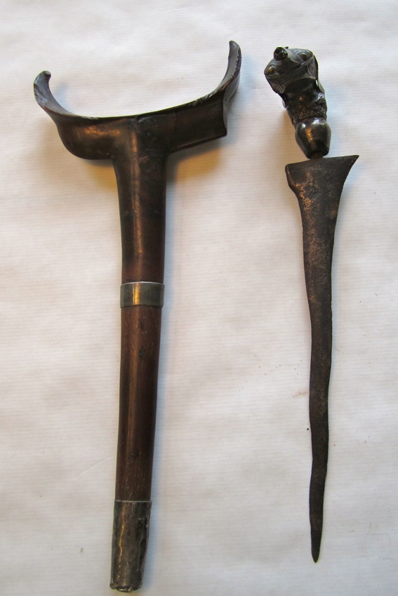

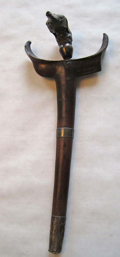

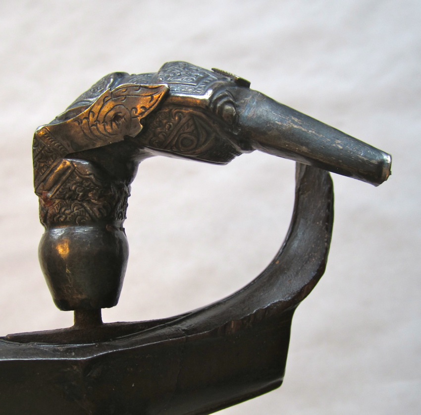

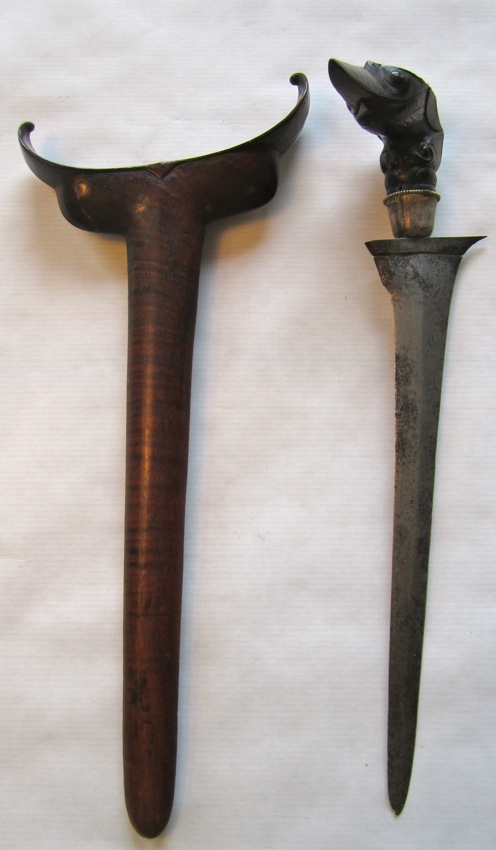

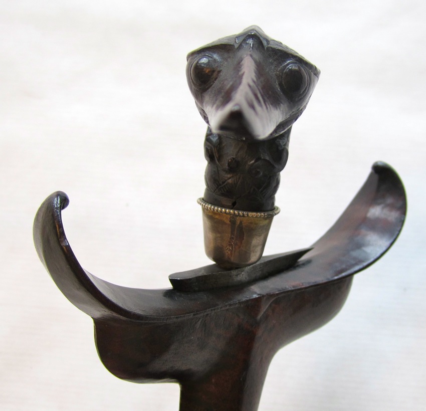

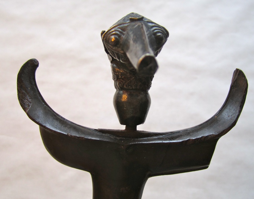

Here is first a small silver coteng I found that is so much smaller than my two earlier coteng and the two coteng I have seen at the late Karsten Sejr Jensen's house. It's about 2/3 in size (30 cm/11 3/4") compared to my other silver coteng (42 cm/16 5/8").

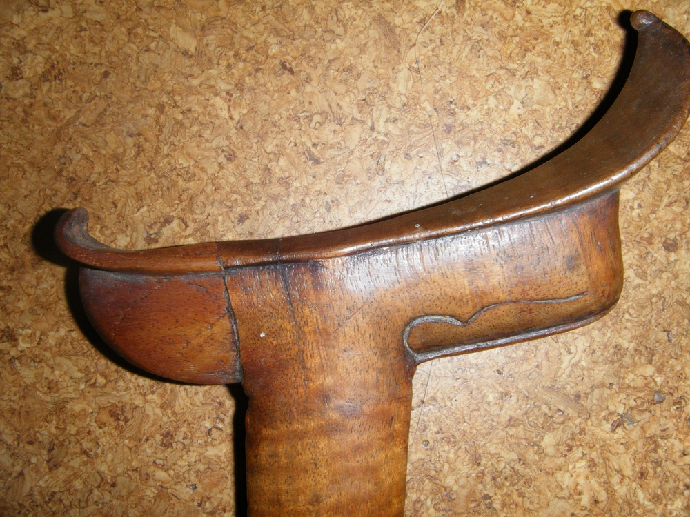

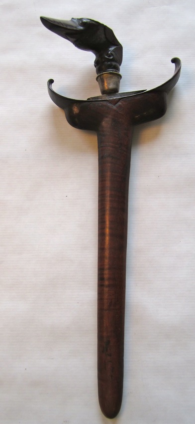

And then a few weeks later I bought this small wooden coteng from Artzi that is just as small (29 cm/11 1/2").
What do you think, are they older versions or are they keris selit according to the quote above?

I've seen small coteng kerises around, but I'm not so sure they can be classified as 'older' because of size. "Keris selit" as a term may not be applicable North of Kelantan/Terengganu, as it seems to have a Kelantanese/Terengganu origin.
Cotengs are inherently quite slim and petite, even in their full sizes, compared to the larger kerises that can be found down South. There may not be a very strong reason to downsize them further for a 'keris selit' effect.

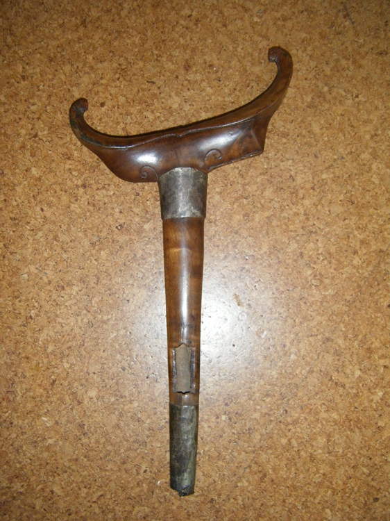

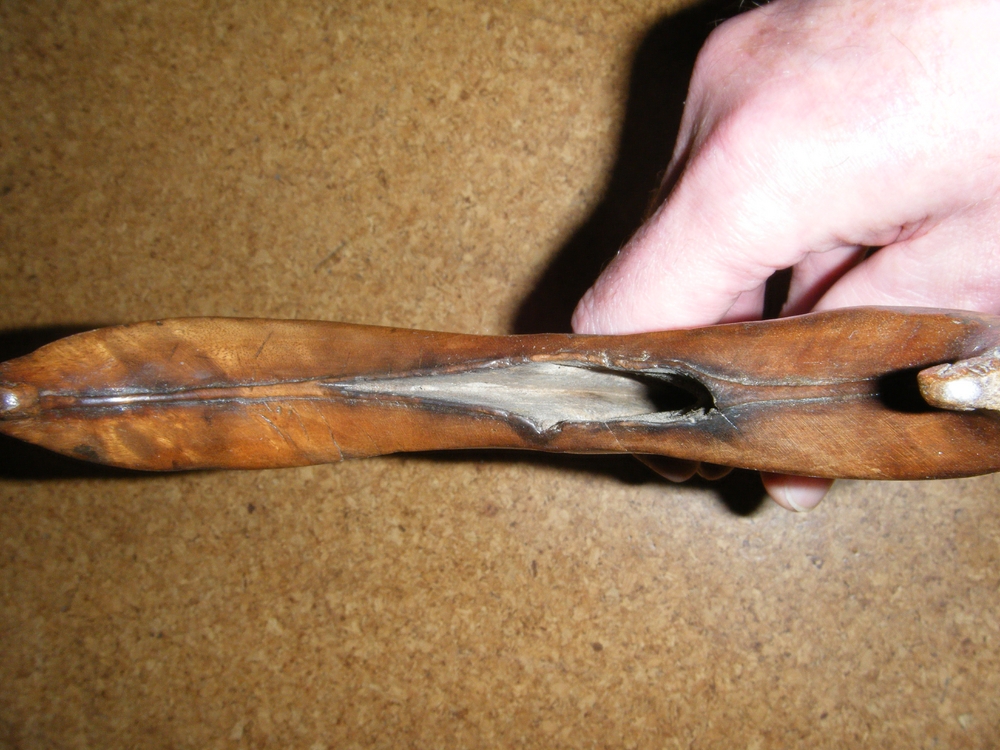

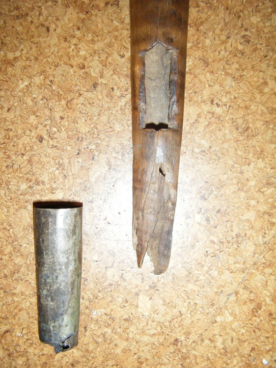

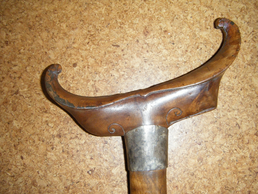

I just bought this small coteng sheath (I think it is one?). It is only 27 cm long but the tip of the batang is broken and covered with a silver (?) cover. I have several questions about this sheath. Since the "window" in the batang seems old and patinated: is there a special purpose for such a window? Are the hilts smaller than a "normal" coteng hilt? (Here is special Michael asked) Do someone know from which wood this sheath is carved? And which sort of blade would be adequate?

Nice old coteng sheath. The 'window' in the batang is probably old damage.
The part of the batang that has been lost could easily have been 5cm or longer, to make the proportions correct.

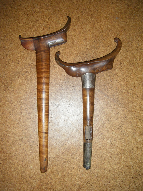

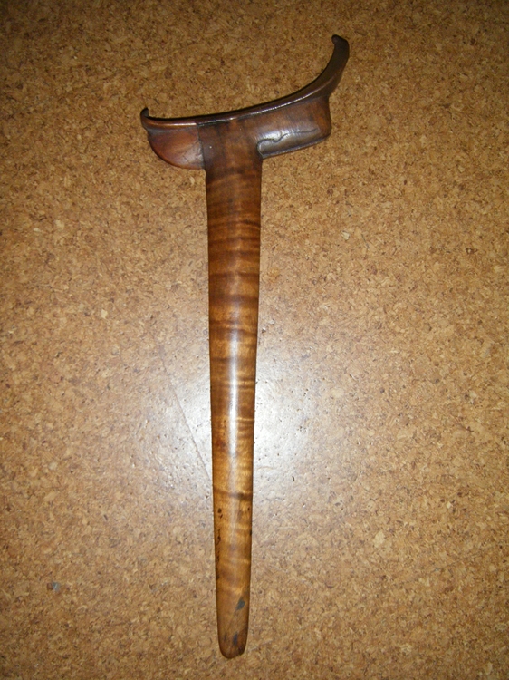

I have get with the sheath a second one from the same wood (I think) but with a old repair but the batang is still ok. I am unsure if I shall cut the broken one and should replace it with the good one, the cut don't will be visible by the silver sleeve. What do you think?

The other sheath has a broken daunan, but the batang is one piece with the cross-piece. It is quite a waste to cut the batang to fit the first sheath.
If you don't have a keris blade and coteng hilt to fit the first sheath, why not just leave them be for the time being. If you do get a keris blade and coteng hilt in the future, you could send it to Malaysia to be fitted, and at the same time, get a batang and metal works done.

yes, I think you are right, it will be the best to do nothing until I have a blade and hilt!

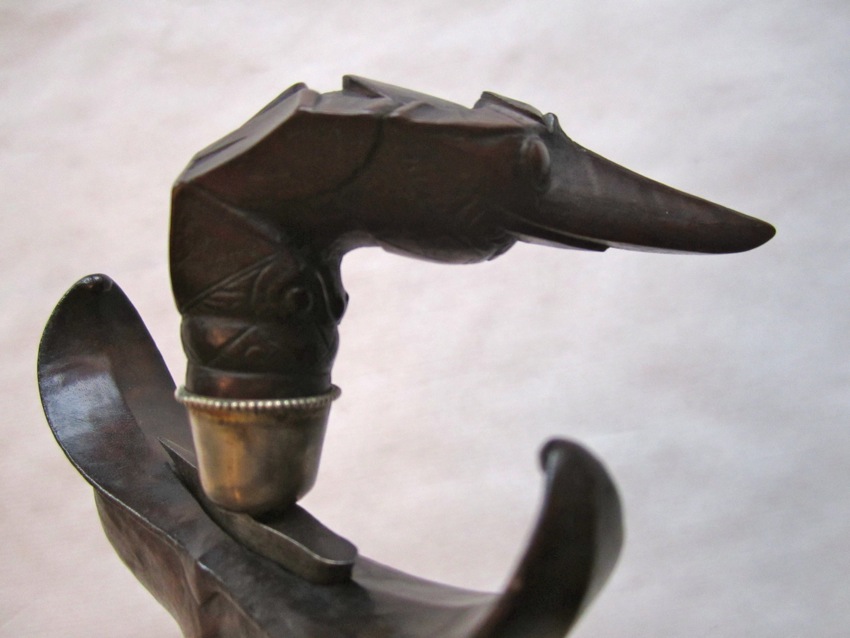

can you tell me if the hilts of your examples are smaller as normal.
Thank you,

Yes the hilts are also proportionally smaller than regular sized coteng.
