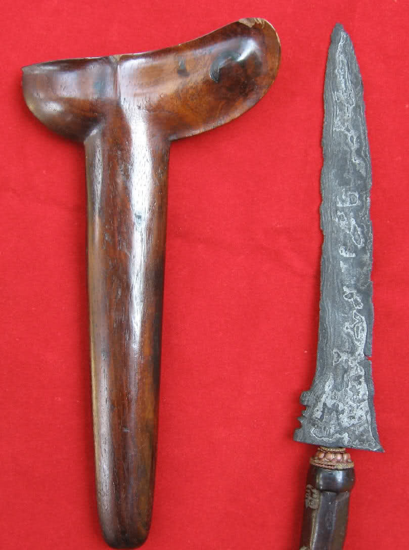

Hi all, anybody can help me to identify this keris? If you ever see or have this keris type, kindly share your experiences with me..
Thanking you in advance

Neither Sombro nor Jaka Sura, is not a name of keris type. Sombro, was a female empu -- according to some keris legends -- once lived in the era of Pajajaran kingdom, West Jawa around 10 century. While Jaka Sura was one of Supamandrangi's son -- while he was serving as 'abdi dalem' (king's servant) as an empu in Blambangan, East Jawa in Majapahit era (around 14th century). Supamandrangi is the most famous name of a Majapahit empu. These are legends, of course, not history. Your keris's dapur is Puthut... Or betok type of keris, with puthut motif..

However, in respect of the keris under discussion, yes, I agree, this is a betok puthut.

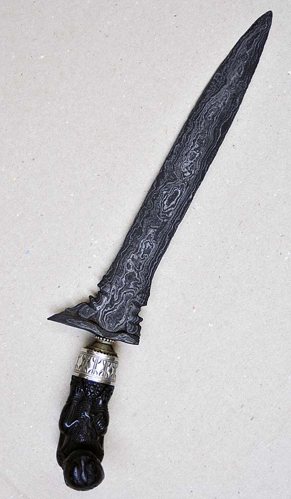

Karttikeya, the proportion of the gandhik, the puthut side, IMHO is too short to be an iras (one piece) type of betok. It is possible the ganja was missed. For comparison, you may look at this betok in this picture below.... Pls compare the proportion of the gandhik side of this "puthut kembar" (twin puthut)...

Pak Ganja, thank you for the sharing pic. Actually, I've seen that keris type 2 times and both no ganja, I do not know whether it has lost ganja or original shape (we might call it iras). For your information, there are some thumbprints on the blade and very thin. But I noticed both iron and pamor of yours are different from mine, probably your keris comes from different period. Anyway, thank you for your explanantion, Pak Ganja.

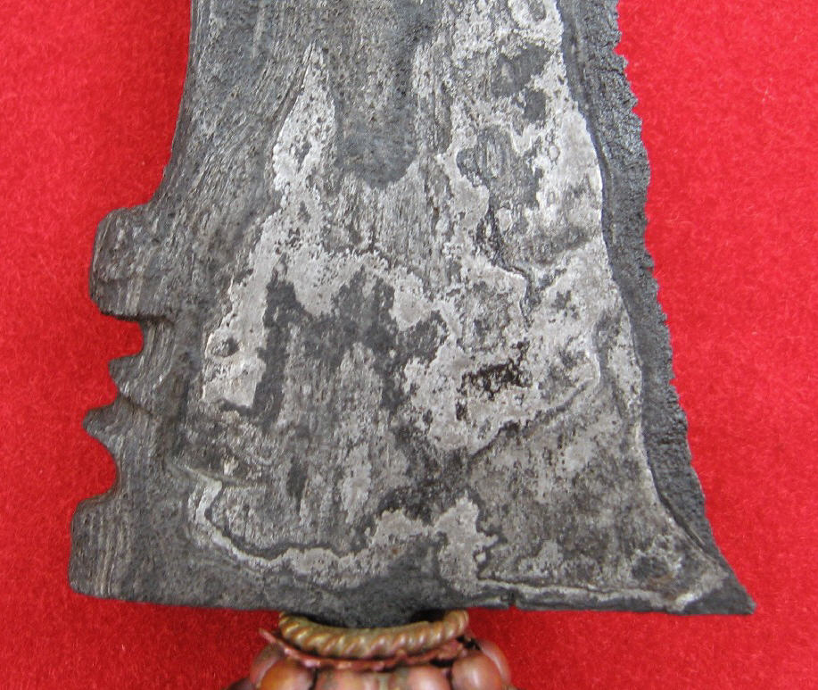

Pak Alan, I am wondering whether this betok putut is genuine or not. I have attach another photograph..How to identity genuine and rework puthut? I think below photograph is quite clear to be identified..
Thank you..

Karttikeya, its not as easy as just looking at something, and most certainly not as easy as looking at an image on a computer screen.
There are very many considerations when we try to ascertain if a particular feature, or form, is original to the blade. Sometimes this is as easy as using a jeweller's loupe and good light, but more often it is a matter of looking and touching the blade, and feeling the surface, and comparing various areas on the blade.
To make any supportable determination I need to actually hold something in my hand to be relatively certain.
From an image I can often make a fairly good guess, but I can very seldom make a guess that is good enough for me to risk my own money on a purchase, nor to advise anybody else to risk their money.
Money is what it comes down to:- every blade ever made is worth something, doesn't matter if its genuine or a considered attempt at fakery, its still worth something, so when we discuss this sort of thing it really becomes the same, or at least similar to, advising somebody to buy or not to buy investment property of any kind --- stocks, shares, real estate.
Nobody who has any integrity gives advice in the area of investment unless they can support that advice. In fact, under the laws of some countries it is an offense to give advice in respect of investment if it can be shown that the advice was given in the absence of good reason to support it.
It is almost impossible to support advice in respect of keris alterations, and many other things concerning keris, from images on a computer screen.
If a guess that I am not in a position to support is of any interest to you, my guess is that this keris was made from an original, much larger keris, and the puthut was carved into an existing gandhik.
