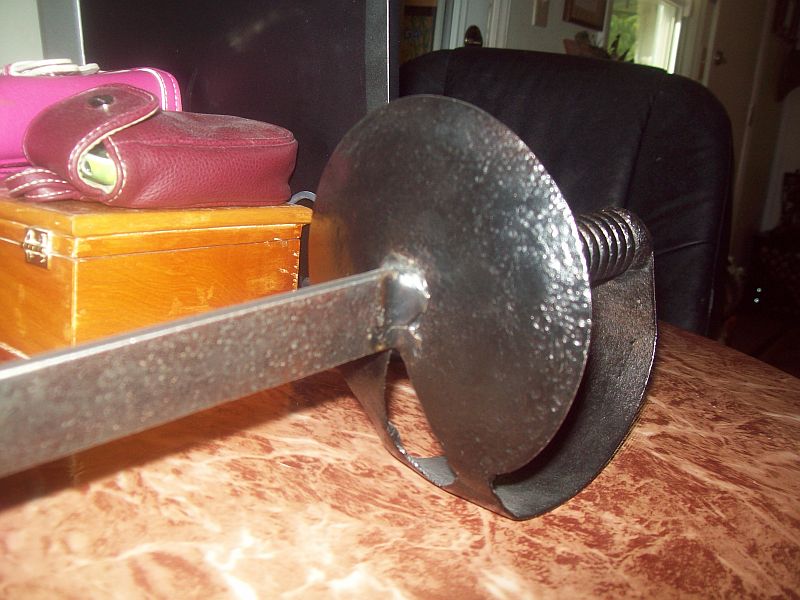

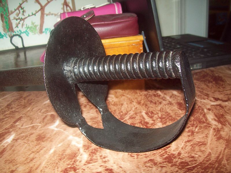

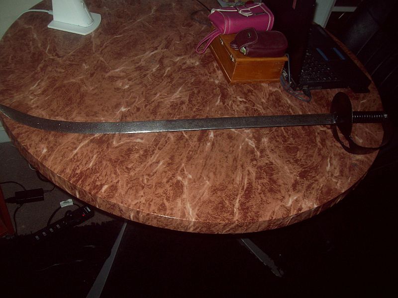

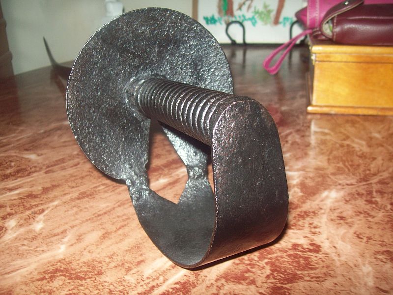

Sorry to visit old ghosts, but after my success with that old Dutch sword, I'd thought I'd give this old one a try as well. It truly appears to be an original piece, meaning, I don't think it's a theatrical or blacksmith piece made for fun. The blade, I think, is older and possibly one of those old Rev War imported (poorer quality) blades. Note the steep swoop on the end & many of this type in Neumann's.
My quandry is the construction. It appears the blade tang was inserted in a corrigated/ribbed iron hollow grip, brass was poured into the space and the sheet guard was folded over the other end and brazed
into place. You can see the darkened brass where the blade intersects the guard/hilt. I have seen one other sword like this that was very similar to the m1803 Brit cutlass, with brass securing the blade near the guard. So, is this just a "one off', made in limited supply, or has anyone else seen a sword with similar construction? There is a very primitive cutlass in Neumanns that has it's hilt tightened with poured lead, creating primitive langets for it, but that one still has the tang passing through the end of the hilt and piened, so not exactly the same thing. Anyway, opinions?

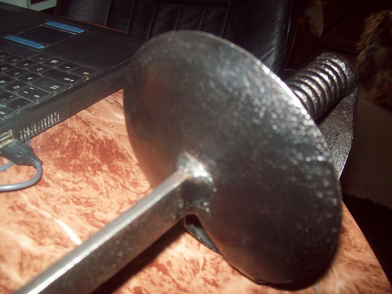

Are you sure it is brass indeed? Try to put a small magnet over it, or to make a small fine scratch in order to see the natural metal tone.
From here via the photo it sure looks like filled electric weld.

I have a confession to make and I'm not proud of it ( ), but the reason I know its brass is because I used a chemical to pickle its color black to match the rest of the sword. The brass was old and yellowed with age when I got it, but contrasted so smartly with the rest of the dark sword and looked like a wad of gum holding the blade in place, so...I altered it to look more appealing. No trickery on my part, just wanted to have a less ugly appearance. So the surface of the brass now looks "off". Unfortunately, I don't know what to do about returning it to its former state. I'm afraid I'll wash away the patina and then it really will look like a "put-together" sword, which I truly don't believe it is.
Does anyone have a suggestion of what I might do to remove the pickling to the brass??

photos look like it was arc welded, broken at the hilt & 'fixed'? the blade does not look right with that hilt to me.
edited: if it is brass as you posted later it could still be a repair...

brazing happens at a lower temp. than welding. the brass filler metal melts at a significantly lower temp than the steel being joined. when used to produce a fillet where two surfaces meet at right angles it can look a bit like a proper weld. if you know someone who welds, he can probably tell by looking at it, the photos are a bit hard to tell. brazing is essentially like soldering where the filler melts and wets the joined metals which may be dissimilar to each other as well as the filler.
the much higher temp of an electric arc weld not only melts the filler but the base metal being joined it requires the filler as well as the two parts to be joined to be similar (ie. all 3 steel) and would seriously affect the heat treatment hardening/temper of a blade. the temp. used to braze while lower is also high enough to affect the temper.
i've not heard of tangs being held into iron grips by melted and poured brass, i suspect if anything they would have used lead. cutlers cement (tar or rosin mixed with brick dust and occasionally a fibrous material) was used for similar purposes at even lower temperatures.
this site has info on arc welding, as well as brazing and other welding/brazing methods.
as everything is covered up by the brass, an xray may be the only way to tell what is underneath. the xray will likely cost more that the item did tho. or you could take it and give it a good whack against a tree & see what it looks like when it breaks loose tho this somewhat detracts from it's appearence until you get it unbent and re-brazed anyway .
modern electric welders like MIG and TIG types can also braze with a brass based filler, again at lower temp.

Finally removed the stain from the brass at the throat of the blade...and brass it is. A magnet didn't stick to it and it has an older yellowed patina to it. I'm still convinced on holding this one that it is legit. Worked on and repaired, yes, but a modern forgery with slapped-on blade, I don't believe so. IF it is real ( ), when would someone have had the technology to simply forge the knuckle guard to the grip without a peined tang? Wouldn't this still be an easy process that could have been done pretty early?

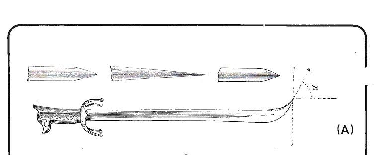

Excavation success!!! I found the article, an obscure reference from a French magazine in 1976 concerning blade types and sections......it is obviously a 'nimcha', well known in French context of course with thier colonial activity in these regions.
This curious 'uptick' on blades seems to be a subtle characteristic on the colonial blades of espada anchas of the early 19th century, and it is worthy of note that there seems to have been considerable association between some Spanish colonial swords and examples of colonial Maghreb weapons.

Well, after many months of debating, I finally took this one to a welding shop to have those more knowledgible look at the braize. It was agreed by all that it was a modern repair. After these folks tried to melt away the brass unsuccessfully with acetyline (turning the surrounding metal a cherry red and burning some of the old paint off), we decided on a differnet route. I had the braize ground smooth to see if my hunch was correct. Happily, it was. This old cutlass was constructed with the tang inserted into the hilt and somehow secured. The modern braise was done to repair a hair-line crack approx 1/8" from where the tang enters the disc guard. After it was shaved down, it looked much better, with the crack just barely visible and the blade still intact. To date, I have only seen one other sword made in a similar way in Neumann's book. Still, among naval collectors, there is no denying that private purchase swords had many, many different forms.
