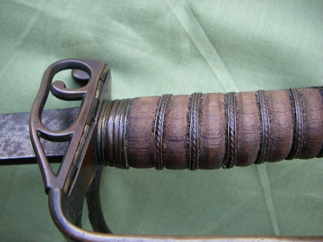

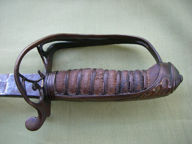

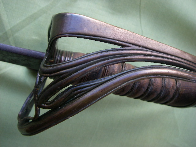

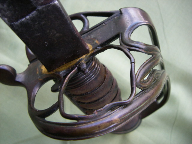

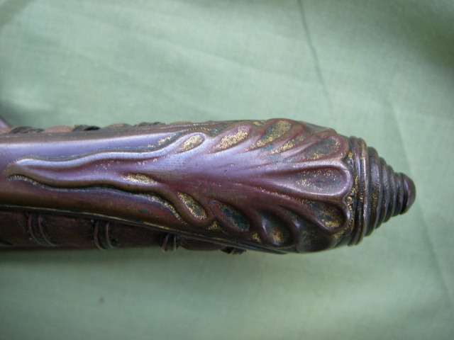

Hi all, I shall be most obliged if anyone can help ID this sword. 41 inches overall length; no markings at all anywhere; one slender bar on the guard is broken; half of the guard folds down. Advice always appreciated.

This is an 1845 model British infantry officers sword. This style was introduced in 1822, folding guard and pipe back blade. In 1845 the blade type was changed to the Wilkinson designed spear point single fullered blade but still keeping the folding guard. In 1854 the folding guard was replaced by a rigid one of a similar design. This would place the manufacture of your sword to between 1845 and 1854 although these dates have proven to be somewhat flexible as to when the different models were actually put into use. An internet search will bring up lots of complete examples as yours, as I'm sure you know, is damaged with the guard cartouche missing. Hope this helps.
