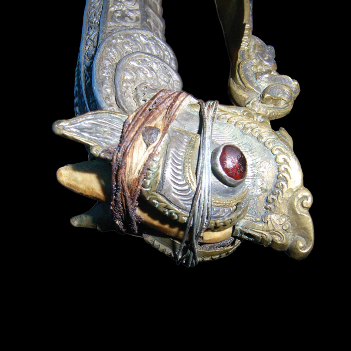

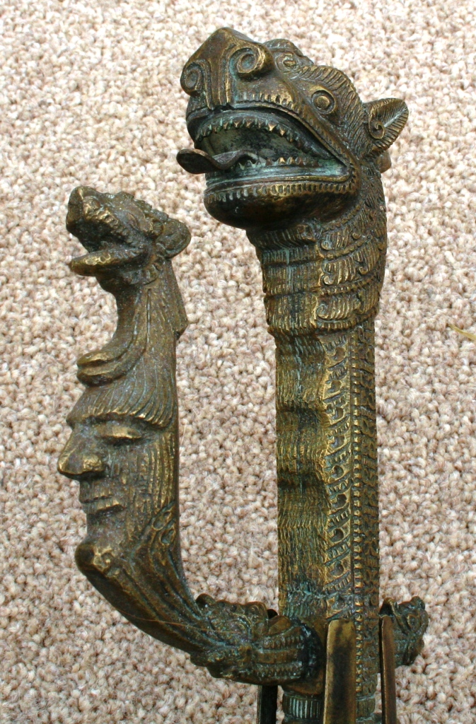

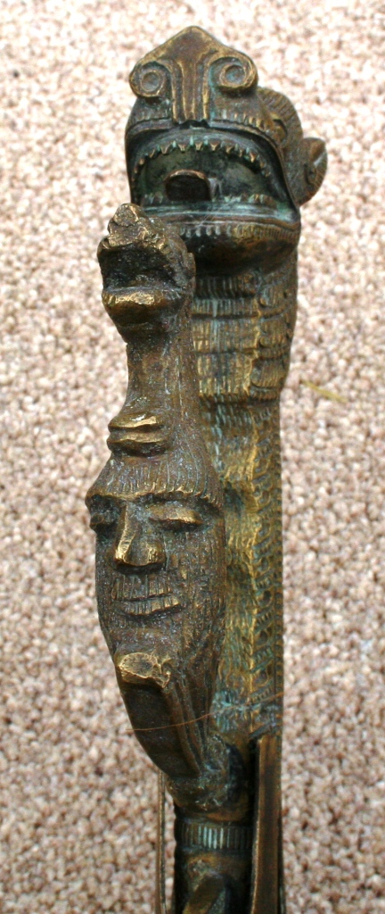

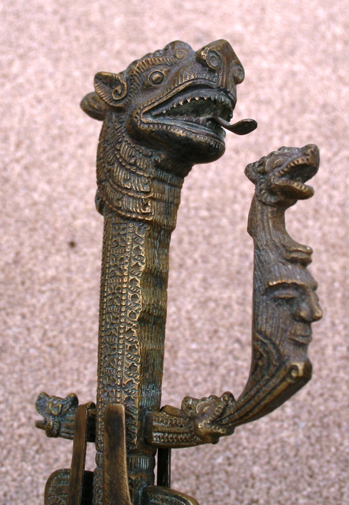

How many faces are there ?
Has anyone ever seen one like this before ?
Does anyone have any ideas about the faces and their meanings ?
All comments welcome.
I have only had 3 of these over the years and they are not really my field, but this one is so bizzar I had to buy it.
Royston

Fantastic !
I have never seen an example such as this before .
Cast hilt ?
Human face ?
New to my experience .
Could this be a repro; or a true variant ?
Either way, super sword !

Very unusual. The 'human' face almaost looks medieval european influenced.
I've never seen one like it, a nice find for sure. Well spotted!

Hi Royston, nice find
I hope Artzi doesn't mind, but found these images, not exactly the same, no human head but overall quite similar. What are the dimensions of the blade and do you think it is functional. The reason I ask is that awhile ago I found a Kastane hilted straight bladed example...which turned out to be a 'popular', suitably exotic looking sword ..often used by belly dancers (belly dancers ...not the sword )
http://www.jnanam.net/shastra/kastane/bellydancer.html
The European (looking) head is very interesting, and I hope that your example is indeed, old and not a 'copy', I have seen a couple that were Victorian wall-hangers...but the blades were just for show.
Kind Regards David

This maybe 'way off base', but the European looking head has the look of a death mask. Investigating the early history of the the Europeans entering Ceylon, I found this...
".......On 21 August 1630, the Portuguese began the march to return to Colombo but were attacked by the Kandyan army at Vellavaya. Most of the Lascarins betrayed the Portuguese – only 500 remained loyal – and joined the enemy. For the Kandyans this was an overwhelming victory: of the Portuguese expedition, only 130 men survived and surrendered. The captain General Dom Constantino de Sá y Noronha was captured and beheaded. His head was carried by Prince Mahastana (later crowned Rajasimha IIEmperor of Ceylon) and presented to the Emperor Senerat......"
Could the 'head' be a symbolic reminder of this event...I wonder I have not been able to find an image of General Dom Constantino de Sá y Noronha to help / disprove this theory.
Regards David

This really is an interesting piece! and actually it is not a 'kastane' (the word derives from the Portuguese term for a decorative walking stick) but an 'interpretation' of one. The Sinhalese kastane seems to be primarily an 18th century form, though the earliest example of the well established hilt form appears to have been in the early 17th century. The ancestry for the motif on these hilts seem to derive from Hindu iconography figures, the figure on the pommel of course the Sinha (=lion) while on quillons are makaras.
Most examples of kastanes have the distinct hilt with quillon system that is believed to derive from those of Arabian nimcha type hilts, which in turn likely were influenced by early Venetian types.
This piece appears to have some sound evidence of age, and reminds me of the old chestnut; "a camel is actually a horse designed by a committee"
The hilt shows all of the correct features incorporated in the typical kastane hilts, however the arrangement is incongruent. The inner vestigial quillons on this interpretation are placed entirely below the upper quillon, and the extended rouded langet has nothing to do with the usual triangular type seen on normal kastanes.
Most interesting of all is the face incorporated into the knuckleguard, which does distinctly show European influence, in recalling the faces typically seen in the man in the moon face seen inscribed on European trade blades. These moon and sun faces are of course cabbalist symbols reflected on many 18th century blades with talismanic/quality implications.
The scabbards on this, as well as on the example Katana has posted seem to reflect the pierced and repousse work seen on sword mountings of the 18th to early 19th century in Hyderabad for export to Arab markets (see "Arms and Armour of Arabia" Elgood, which shows these, many with piercing and brass of 19th century), and the figure at the scabbard tip reminiscent of Ottoman scabbards as well as the thum on Omani janbiyya.
I'm unclear on the unusual blade shape on this, but seems to concur, at least in age estimation, from what I can see, probably 19th century. This seems to be something more intended for presentation or award, and while it would be difficult to place geographically by form, it seems to have been created in that period entering the complex trade networks from SE Asia, India and Arabia.
Extremely nice example, and though not a kastane variant, a very attractive piece. Its a great anomaly, just like I like 'em!!

I suppose its too much to hope for that there are any marks on the blade?
It also has a Euro feel to me.
Reminds me of small hunting hangers.
I know its grasping at straws, but I was wondering if a local craftsman rehilted a European blade and retained a representation of an original decorative element.

Very nice find. The huge majority of kastane have never appealed to me, but I really like this one! Artzi's piece secondly. Like yours better.

In looking at this hilt I still see the 'man in the moon' face seen on so many trade blades, but it seems odd that this would be fashioned into this oddly arranged hilt.

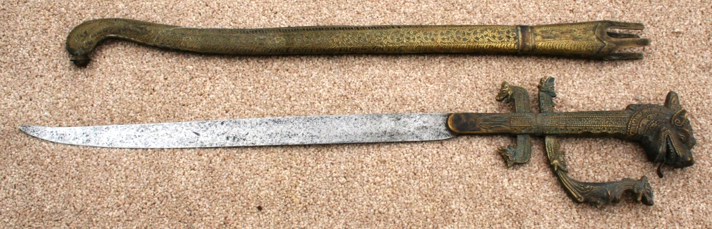

Thanks to everyone for their comments. I did not think this item would cause so much discussion.
I have owned it for a while now but know nothing of it's history as I bought it from a West Country dealer who claimed it came from a house clearance.
I can't get to grips with the " Quote " parts of the replies but to answer some of your questions:-
Katana, I'm not at home at the moment and did not bring the dimensions with me but the blade is approximately 14" long. As to it being functional, I have feeler gauges that are probably thicker !!!
As I said, I have only owned 3 of these. I have seen a few more but never one that I would have considered a practical sword. Has anyone else ?
Atlantia - Sorry but there are no markings on the blade.
Jim - So, if you do not call it a Kastane, what should it be called ?
I agree with you that it has some age but I would not like to say how much. The general appearance and "feel" of the item suggest older than 1970's as Vandoo suggests but I cannot varify this.
The comments that both yourself and Vandoo make about " Presentation " " Parade ", "Ceremonial " and " High-end Souvenir" all have a ring of truth about them.
I suppose one of the mistakes we must all try and avoid is NOT to get disappointed ( or even annoyed ) when someone suggests that one of our favourite items could possible be - dare I use the word ? A Souvenir.
I am sure that a lot of collected weapons were picked up years ago and bought home as souvenirs.
( By the way Vandoo - I really like the prefix "High-end" it sounds very diplomatic )
The hilt is solid cast brass. I had not really thought about the relative positions of the quillons so thanks for that Jim.
As to the man in the moon. I think this is the most fascinating part of the sword. It's the main reason that I bought it.
It certainly looks to me to be a copy of the blade marks in other weapons. Perhaps whoever made the blank for casting just liked the look of it ?
Again, thanks to everyone who replied.

I’m new to the list, but coming from Sri Lanka and for long involved in the study of Sinhala weapons I may be able to add to the discussion.
I am sorry to disappoint you Royston but this piece is definitely a replica like many that are being regularly made by the “antique shops” in the South of Sri Lanka. The brass hilt with a single piece molding for quillons and guards, the low quality blade and blade being fitted to the hilt with rivets are dead giveaways. and I would not be surprised if the blade rattles on the hilt when shaken. this is a recent mass produced item most probably from a antique dealer in Hikkaduwa or benthota towns.
The origins of the “Kastana” sword can be traced reliably to early 16th century and may even go back as far as late 14th century. The Portuguese influence in the name is a good possibility as this was the time of the wars with the Portuguese in Sri Lanka.

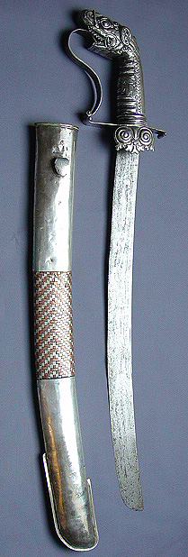

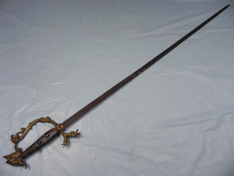

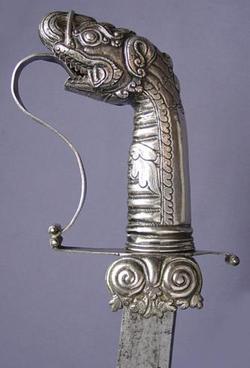

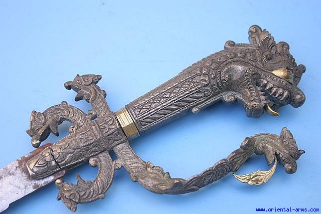

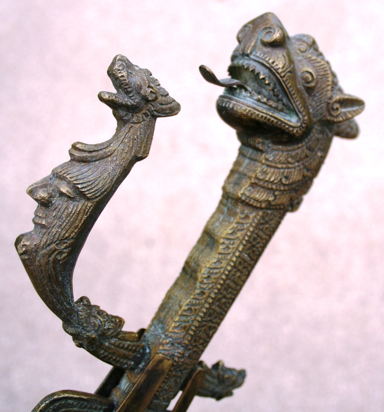

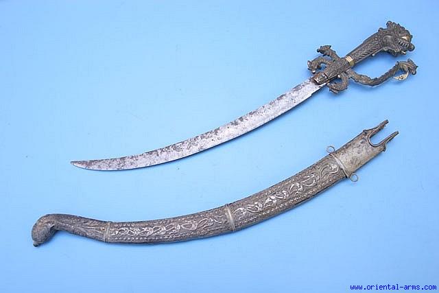

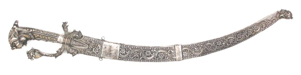

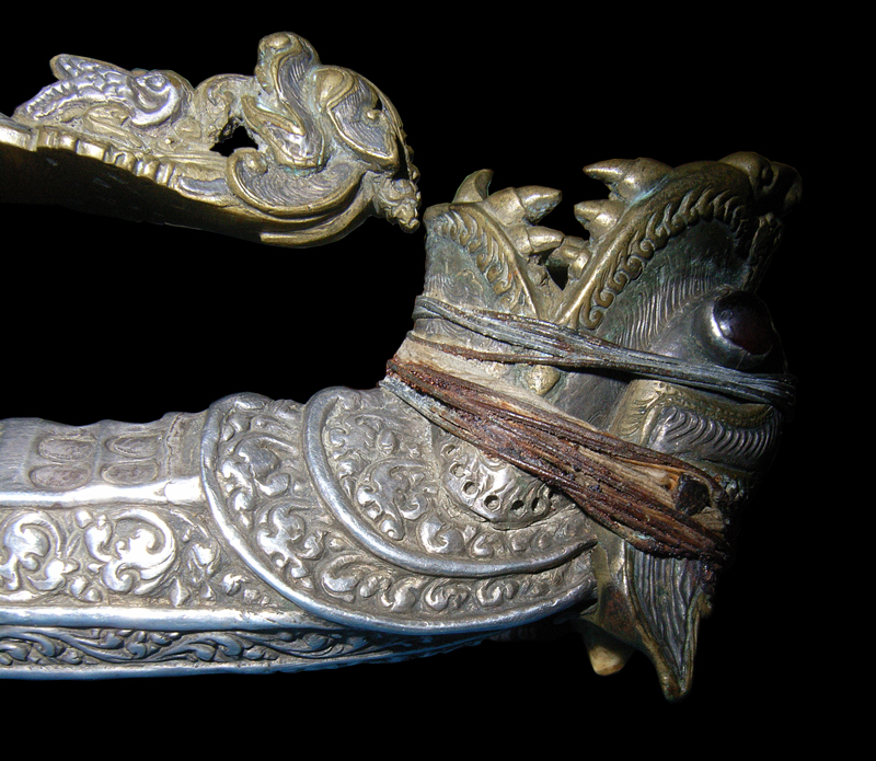

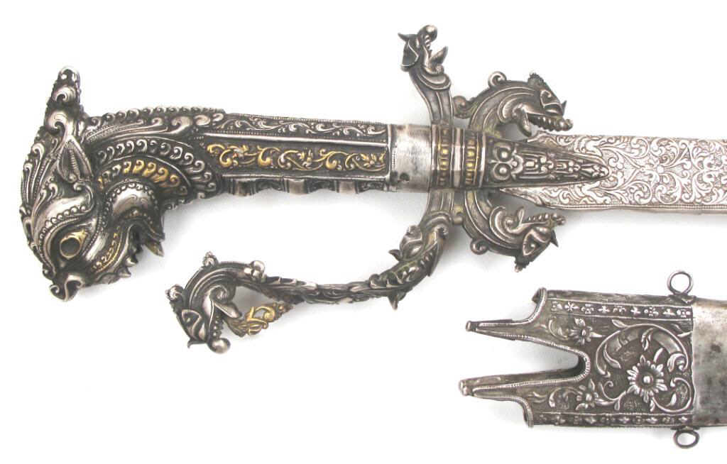

ITS GOOD TO HAVE A MEMBER FROM SIRI LANKA/CEYLON AS EXPERTESE IN THE AREA HAS BEEN LACKING. WELCOME
THE DESIGN HAS BEEN BORROWED BY OTHER COUNTRYS AND NO DOUBT THERE ARE SOUTHERN INDIAN VERSIONS AS WELL AS GERMAN AND DUTCH, ECT. I WILL THROW A FEW PICTURES INTO THE MIX FOR REFRENCE.

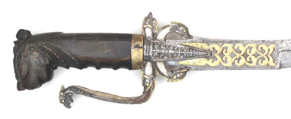

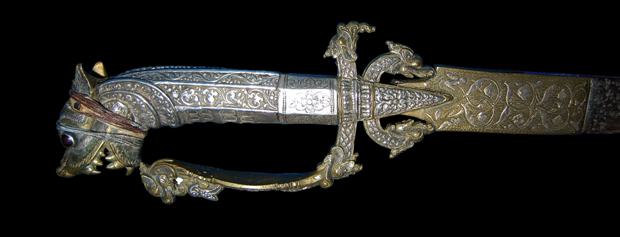

1&2 GOOD OLD EXAMPLES

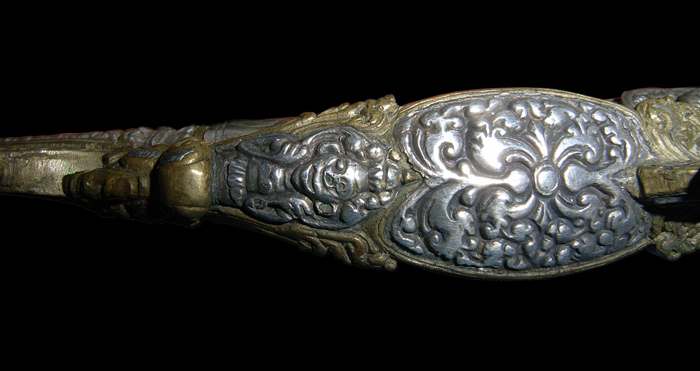

3 & 4 ODD ONE EITHER EUROPEANIZED VERSION OR PERHAPS THAILAND
5 & 6. GERMAN SWORD SHOWING INFLUENCE
7 & 8 SILVER WITH GOLD AND A COMPLETE SCABBARD, LIKELY MADE DURING THE EUROPEAN RULE.
ANY COMENTS OR OBSERVATIONS MOST WELCOME.

The first two with wooden hilts seem to have been put to some use compared to the last which would more likely been a ceremonial / rank weapon.
