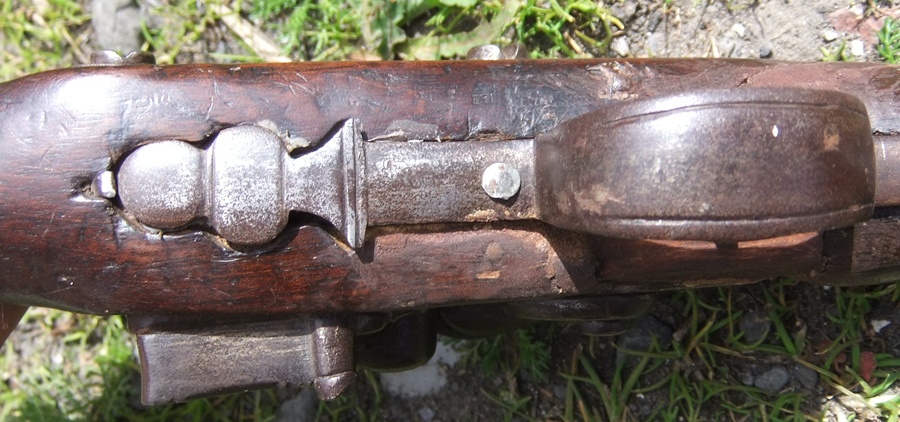

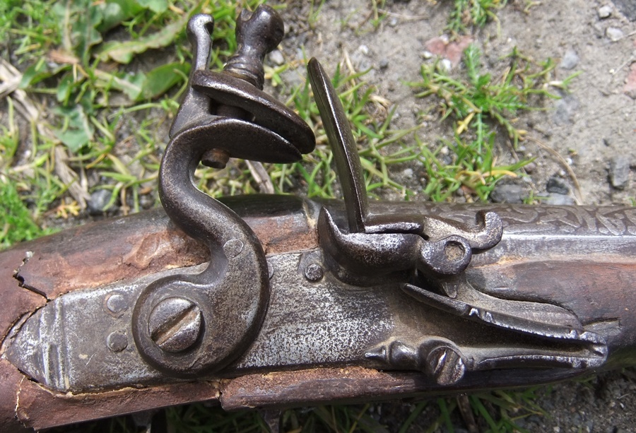

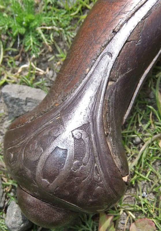

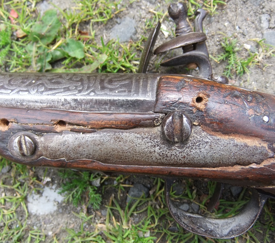

Hi all .. new to this form .. I collect and restore old English shotguns and collect old bottles and pottery .. so i set off on my usual run round the car boot sales and the last thing on my mind as i wandered around with not a item found at 6am .. then i spotted a dealer with what seamed like a "modern" Flint lock pistol screwed to a piece of floor board .. he said to the lady it was a modern copy which had been made to look old and was not worth here asking price .. when she would not budge on the price he put it back under the table .. i then picked it up and had a good look at it and it just felt right .. so a quick haggle and it was mine .. it was in a very bad state but once i had the board off it looked to me like it could date from 1840-50s if it was English .. but it was covered in an "Islamic" text .. so still not sure .. so i was wondering if someone hear can help me with the translation .. date .. and what it should look like as i am now going to strip and rebuild it .. would it be Blued or browned at this period
all the best and thanks .. more pictures to follow off the restoration project

Fantastic! What a thing to find. I was just saying in the display thread about the terrible things people used to do to 'display' old weapons.
welcome to the forums BTW.
Just concertrate on the woodwork. Leave the metal with the nice aged look that it's got (IMHO).

Such a beauty, congratulations. Welcome to the forum :-)
Post some pictures of the inscription and I think we'll get it translated soon enough.

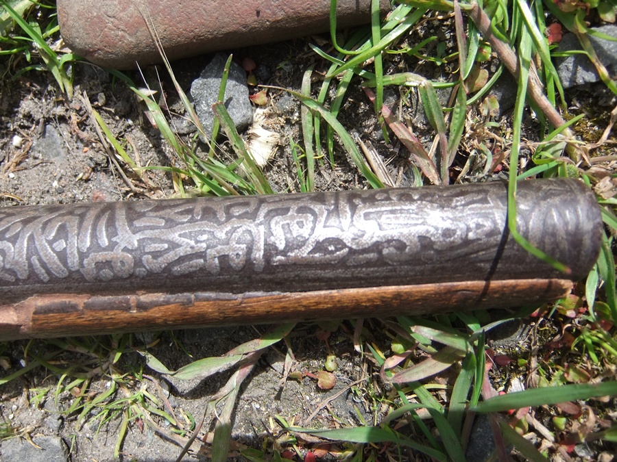

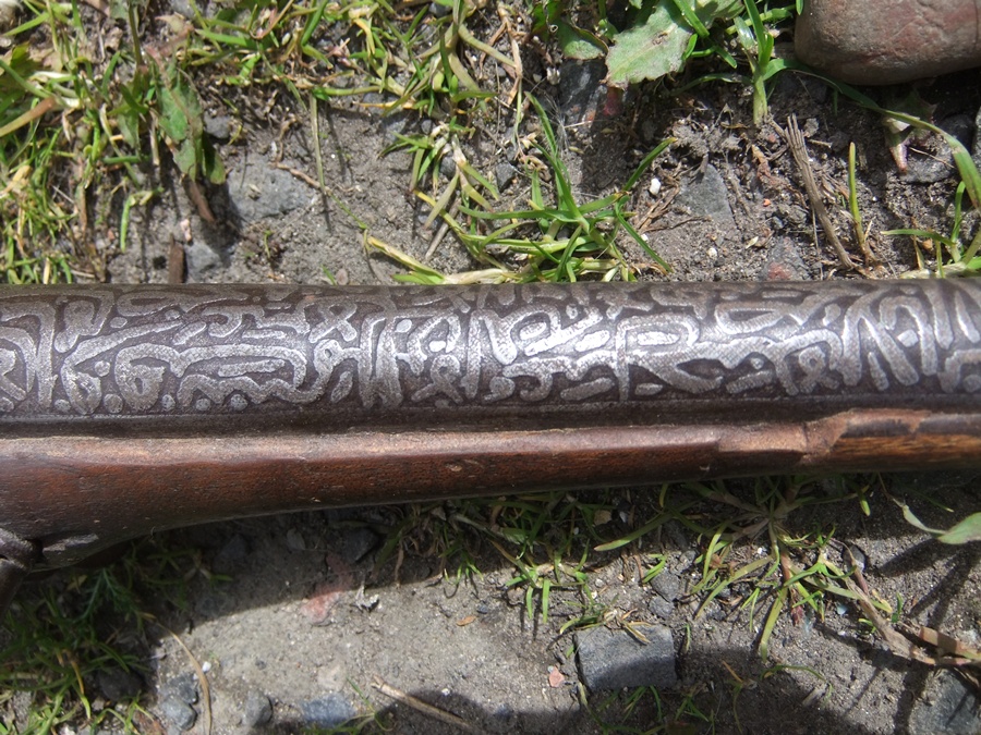

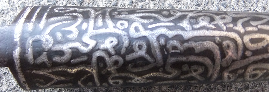

Thanks for the warm welcome
i have attached pictures of the text .. hope you can help

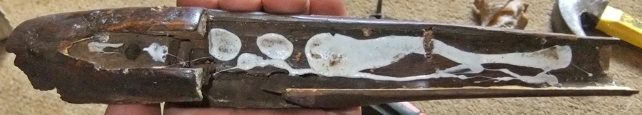

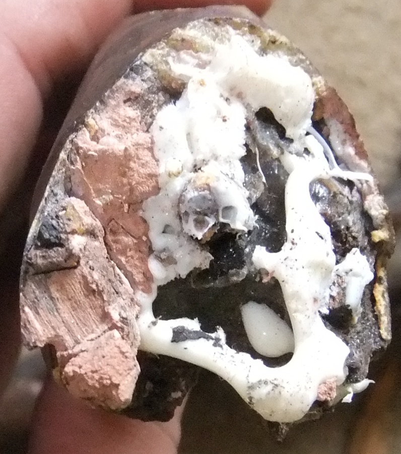

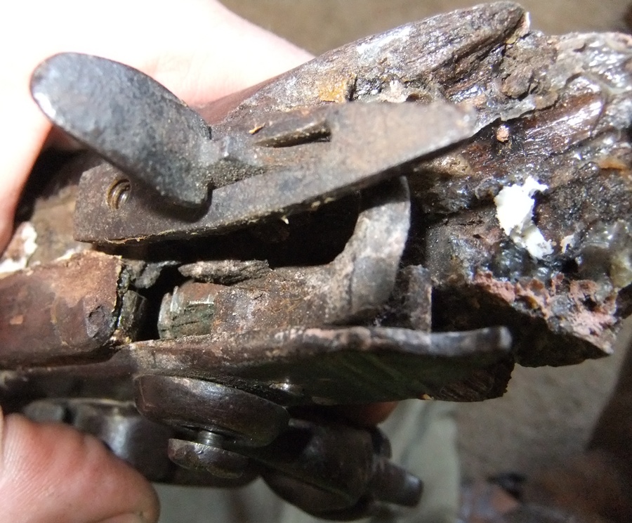

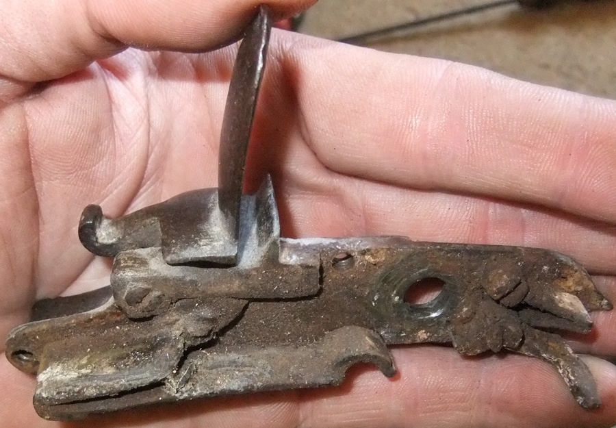

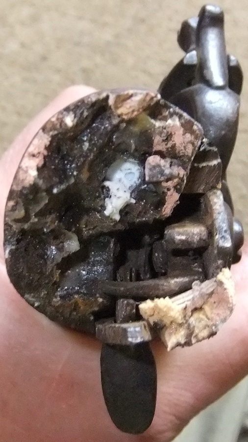

Whoops sorry .. had to be done when i saw the state of it inside ..
check out the state of the wood when i opened her up

More "yuck" photos

Hi Dooly
I know the damage is mostly modern, but often we see repairs and filled areas on these 'ethnic' guns. I would say that you have either the option of replacing the woodwork, or repairing it with infill and replaced areas.
Whats your plan?

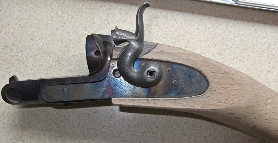

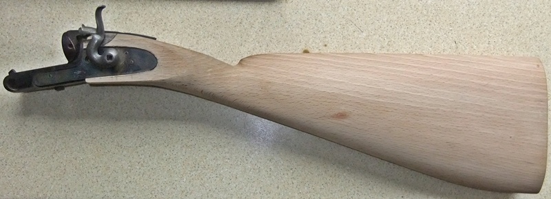

Hi .. I do restore my guns .. but i try to be sensitive And the wood work on this one could not be saved .. almost fell to bits in my hands.
I have attached a couple of pictures of a early hammer gun which was found in a farmers shed a few weeks ago .. totally rusted solid and the stock was snapped and rotten .. this is where i am at with it at the moment .. i have decided to "rainbow" the metal on this one and the hammers will be browned .. the stock is in the oversize stage and needs lightning once all the metal work has been fitted .. the wood is steamed beach and will be stained the the correct color once completed .. Luckily the Farmer had stuffed the barrels with oily rags before dumping it in the shed and the barrels are still in proof so hopefully this season it may bag a bird or two for the pot

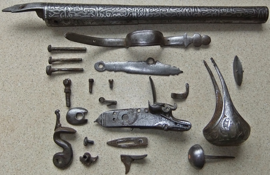

Now stripped and initial dip done

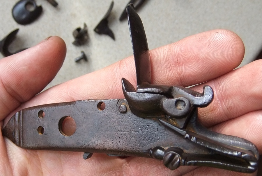

Well all done bar the barrel .. looks like the lettering was silvered or something .. will think about what to do with it ..
all barricaded now just let the oil soak in and next the stock .. still need to work out if i should make it with a ramrod holder .. what do you think

What have you done so far? Cleaned with an etchant, and browned with heat and oil?

...I think the writing is Arabic - acid etched thuluth script.

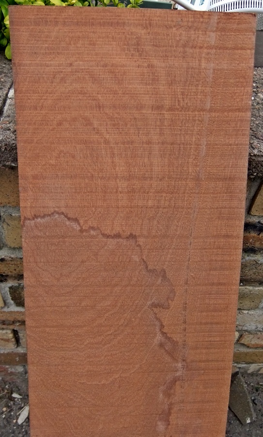

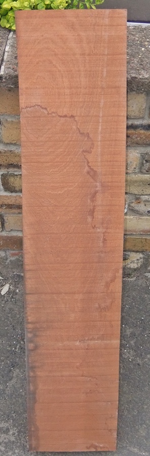

Thanks . not 100% on the wood as i dont think it was the original stock .. seemed to be a type of hardwood. it may have been made form an old English stock as it is simmiler grain to one of my 1870s shotguns.. for replacement i may try to use one of my old gun stocks .. or steamed beech which i will stain down .. this depends on the ramrod/no ramrod question .. and the thickness of wood required

hi thanks for the response .. The script is very similer to "ottoman" coins i have in my collection .. but they have been no help to me..
Rust and blue removing solution then heat and plum brown with fast cooling then barricade oiling .. i have also spent the last couple of hours hand blueing the barrel .. to late to do pictures tonight and it is in the proofing oil .. will sort a picture out tomorrow .. then i guess i will start looking for the wood for the stock .. thanks for the response

thanks for the link i can see what you mean .. i was thinking it was Scriptures or something simmiler..

IMHO get rid of the "rainbow". Obviously done with heat. English locks of this age were not as far as I am aware "case coloured", so need to be browned to match the hammers. Similarly all other metal should be browned. Vintage looks about 1880.

The acid etched script on the barrel is Islamic calligraphy known as 'thuluth' and seen characteristically in the Sudan on weapons during the Mahdiyya period in the latter 19th century. This was also known in Ottoman regions in Egypt and others in degree, though it had been largely been superceded elsewhere in Islamic inscriptions of Qur'anic verse by the Naskhi script.
This appears to be a trade produced flintlock made in the English style and the pistol is mounted in a style which appears much in Balkan style with the sharply angled neck and butt. These were often produced for native consumption , and these type guns were entering Cairo centers, often cheaply made in Leige in the 1870s or so. Apparantly mostly muskets were coming in, but it would seem flintlock pistols did as well in some degree.
The thuluth etching on this barrel suggests the pistol may have been handled during Mahdiyya times (c. 1884-1898) but as these were not commonly used by these forces, it is possible this may have been a special case issue or award.
The absence of the ramrod suggests also Ottoman style in the gun, as with them their pistols' ramrods (suma) were carried on belts.
Probably some interesting history with this one, and quite possibly some intriguing potential as a weapon from Egypt or the Sudan end of the 19th century.

Yes the rainbow .. was an optional extra i liked .. it came about when i was heating the springs for re-fitting .. you do get a few which were colored at this period but usually top end guns .. the workings are by Stanton & Co .. and the retailer is R.W Richards .. who i have not been able to find (i dont have the London book) but i would also put it about that date
thanks for the comments .. i should post some of my completed projects sometime

Dooley: Great job refurbishing the metal parts. Well worth a re-stock. By all means, please post photos. I have a Caucasian pistol project just completed that I will post this weekend. And an interesting story with it.

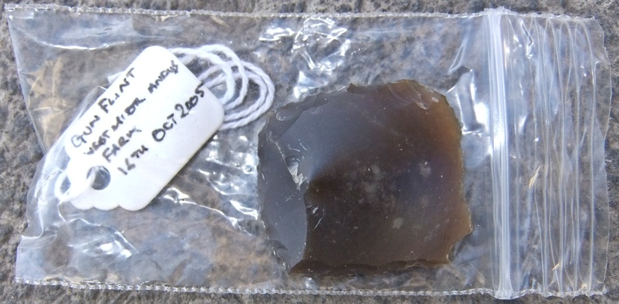

the second is of one of the flints i have found field walking ..

Now back to the gun .. well my timber man did not let me down .. I have attached a couple of pictures of the bit (1 meter) of Cameroon Sapele i have chosen for the gun .. (the timber is FAS registered). I think this is as close as i can get to a appropriate re stocking timber for this gun ..
link to the tree
http://en.wikipedia.org/wiki/Sapele
Now the next hard bit .. pick the bit to cut out the new stock out .. !!!

Question is what would they have used in the country the gun was used, Lead / Leather / felt ??
Lead for the jaws was usually issued to European and American military troops. But not exclusively. I would think that leather and fabric (maybe thick felt) would be more plentiful in that part of the World. But I'm only guessing. One of the questions that comes up with Middle Eastern flintlock type guns is why the mainsprings are so strong compared to their European counterparts. Their are a couple therories. But the one that makes most sense to me is that the "quality" of flint in that Region was simply not as good as English black or French amber flint.

Great news on the timber!!! please keep us posted, and this pistol is gonna look great!!
