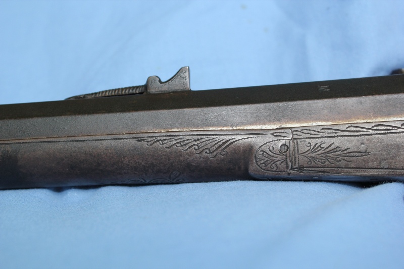

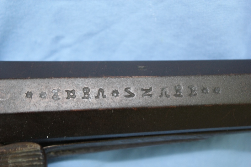

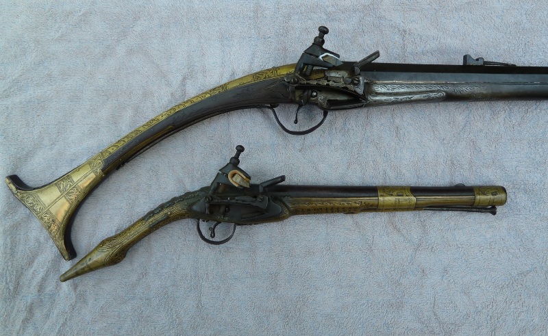

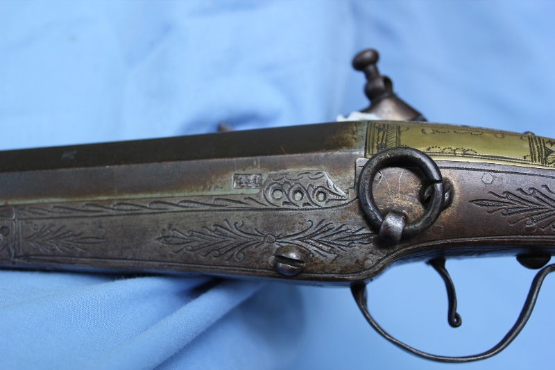

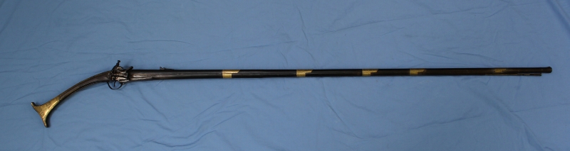

Can anyone help me interpret the inscription on my Tanckicha rifle, or identify the proofs?
Marcus
This is the gun:
The inscription:
Proof on the barrel:
Proof on the lock:

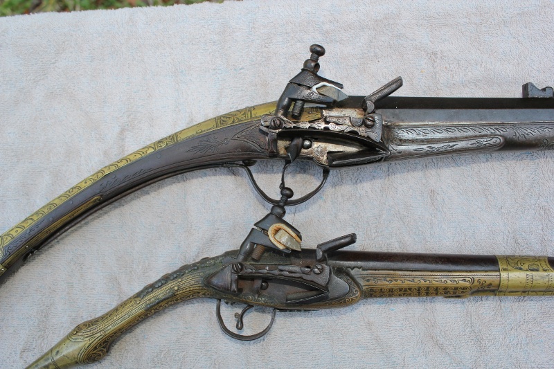

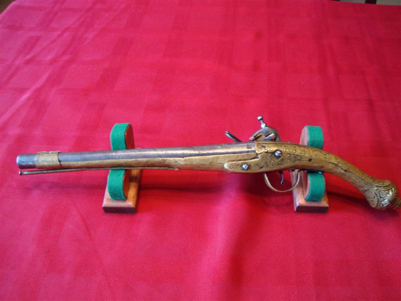

Here it is compared to my pistol:

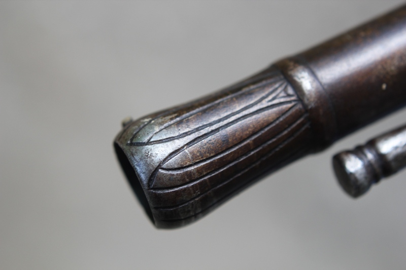

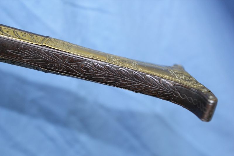

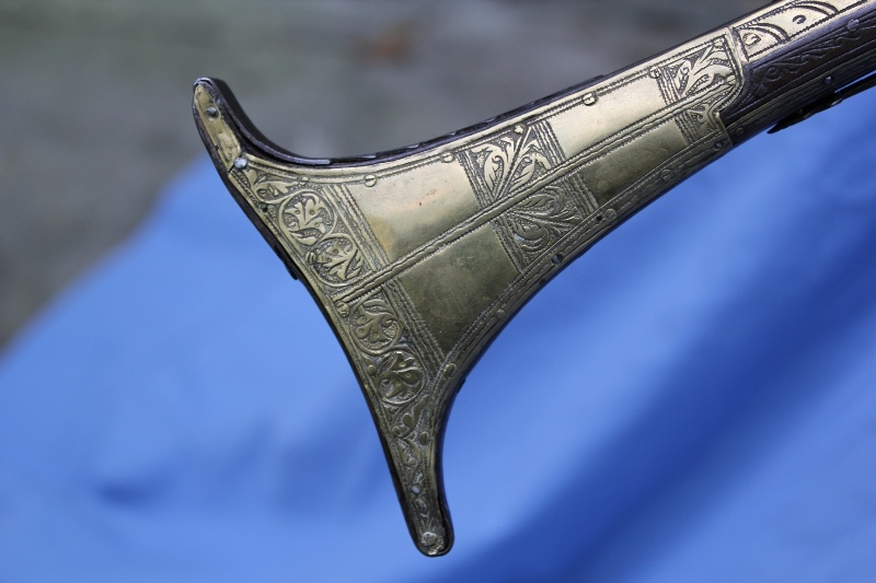

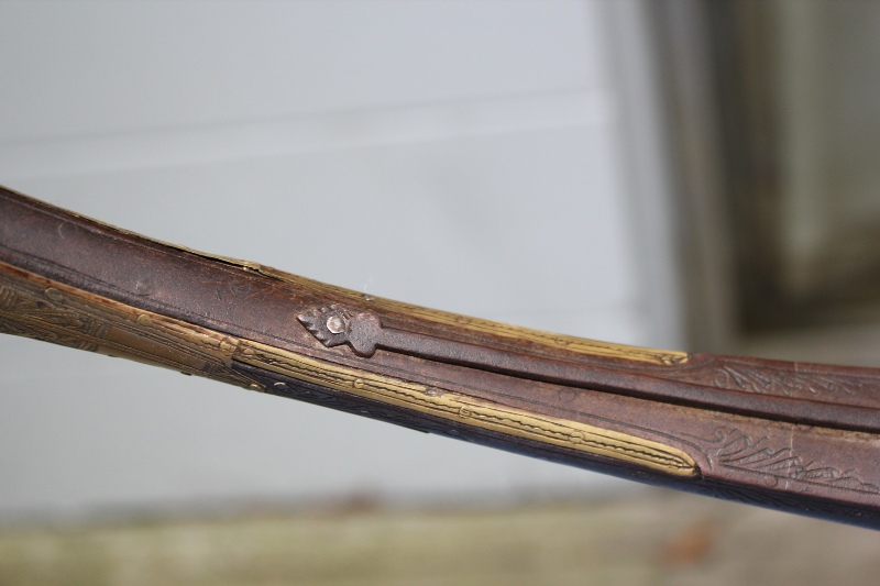

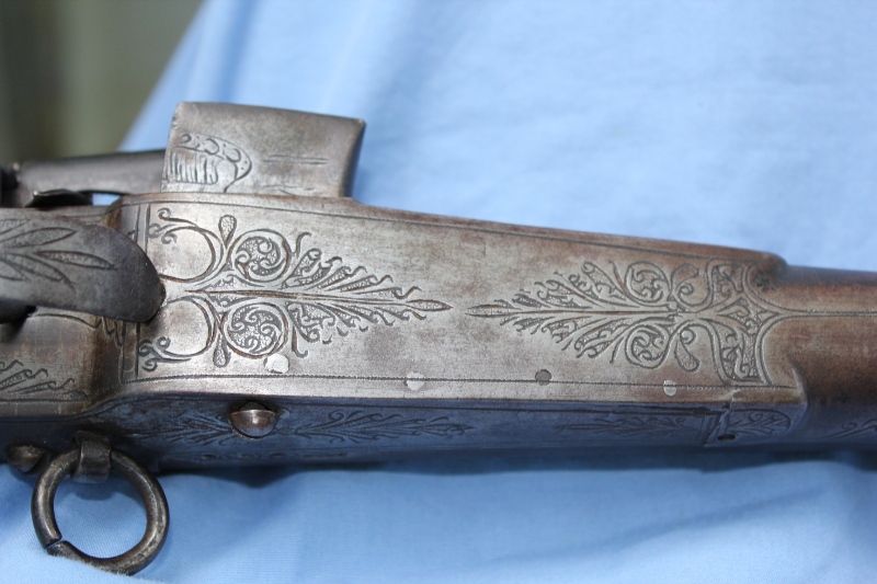

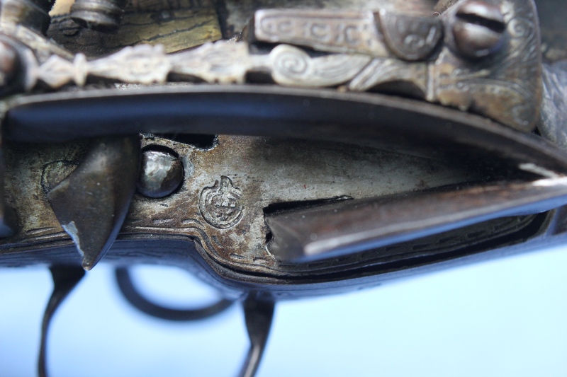

Here are some close ups:

Marcus: That's a very good looking T-Stock rifle and Rat-Tail pistol. Have one of each myself. Unfortunatly, can't help with the inscriptions. Again, nice guns.

Am not much into guns but thats one beautiful rifle. Congrats.
Its not written in in turkish nor albanian it looks georgian to me. i could be wrong though (most likely :P)

Well, i am sorry to say that the inscription...is not an inscription!
This is a balkan rifle and the barell locally made for an individual, not an "army contract". All over Balkans people at these times recognised the superiority of Western European made arms, made in organised workshops, and therefore clients prefered to buy "european" instead of local guns. Put it an other way, the seller could sell for more money if it was a "branded" european product. This leaded in 1) so many fake inscriptions (eg Lazaro Cominanzo etc), and 2) to the practise of just putting latin letters assembled with no order or sense on the barell! Well, the client was illiterate anyway, and even more on a foreign language! But he was happy because he had a gun with a "high quality imported european barell".

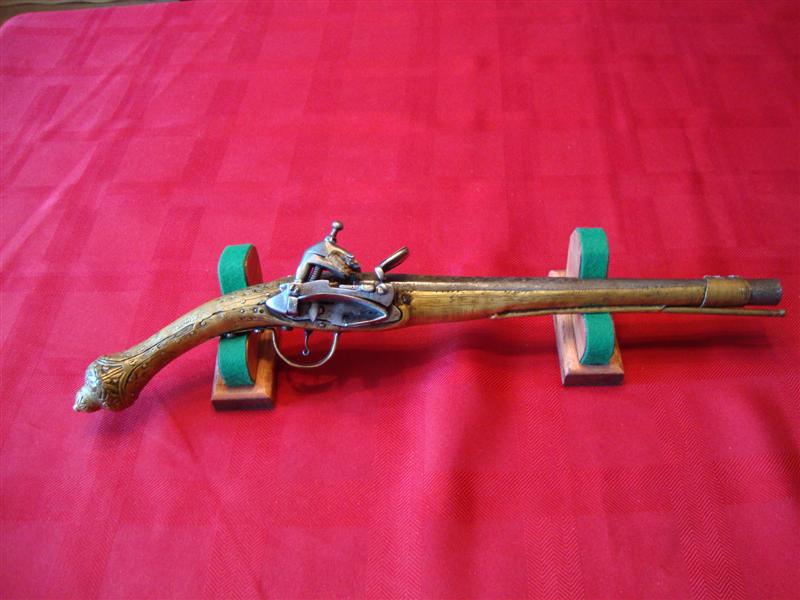

Hi Marcus. Well, I'm finally back home. Thanks for the heads-up on your post re Rat Tail pistols. VERY interesting thread!! My first guess is that either case could be made. That these guns were made and used virtually unchanged for at least 200+ years is probably the reason so many specimens are still available today.

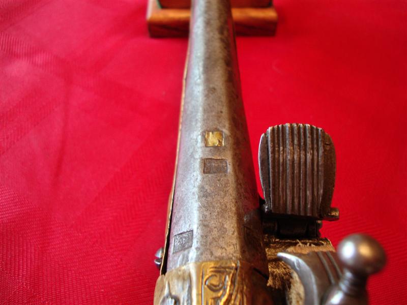

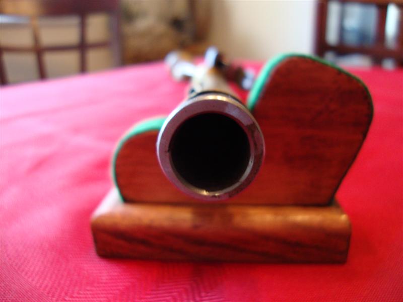

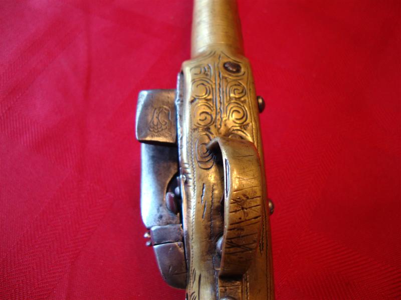

Here is one of mine. This is the other (besides rat tail) butt style often encountered on Albanian pistols. This one I use for shooting. It has a mechanically good re-worked lock and a modern steel barrel liner for safe shooting. It is .59 caliber. Fun shooting!!
