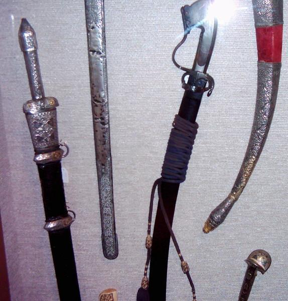

I'm thinking this sword is 19th century as I think are the swords in the following photos. I know there is a lot of ambiguity about when this type of Omani sword appeared but Sotheby's attribution of 16th century is extremely early though it certainly seems to have paid off.

I would have thought a few of those you picture, Michael, may be a bit older than 19th century. But I have seen so very few of these; I really do appreciate your sharing these examples.

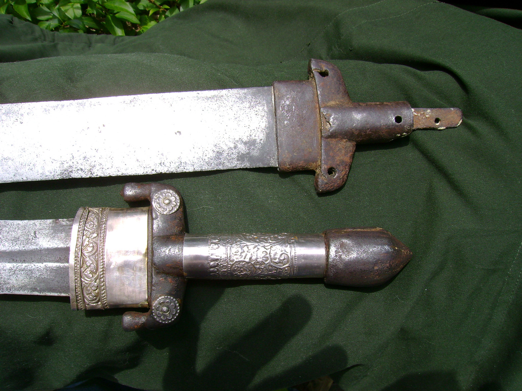

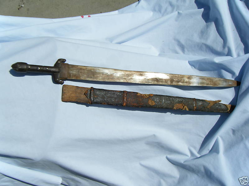

I followed the Sothebys item very closely... and I was also stunned to see the price. I must have handled half a dozen of these variants in my time . I had a good look at that one and discovered it was a wootz blade and had an inscription in the pommel which would have been the owner or the maker.No one has cracked this one yet. It just seems to have appeared sometime out of the blue! Similar relatives appear to be Persian perhaps from the Greek and or Roman short. For sure if it is as old as they now suspect... 10th century? then it is certain to be up the value scale. In terms of quantity left in Oman my estimate is their could be 10 left dotted around .. though I do know a collector with 24 ! and another with 18. I have to say the 2 that I have may not be wootz but I ve not cleaned the blades yet..
In my view they arent kattara since the blade is completely different with a predominant wing cross section and not flexible like the Omani Long Kattara. The hilt is totally different compared to the cylindrical Long. The technique for fighting is different altogether from the Long because the blade is short(a lot of the Shorts Ive seen are about 30 inch total length. Its a hacking weapon.. for up close work , like the Roman short...or like a 2 edged cutlass / short claymore.. and the shield therefor must also have been different to the Buckler(terrs) and must have been big... Heavy infantry as opposed to light speedy nip in slash and snick which is the technique for the Omani Kattara ... Therefor if the weapon is structured differently and used very differently its not a Kattara. I would suggest that this short variant came in early from Persia and was the weapon of choice for fortress or strong point guards up until the Omani conquest of Zanzibar (1652) which then became a conduit for African swords into Arabia. Thereafter I can envisage a tried and tested sword living on as a fortress weapon in Oman well into the 19th century..and other infantry employing the newer Kattara.

It is my view that the Omani Short sword with turned down quillons and a spiked hilt with the rigid pointed blade does indeed relate to the Nasrid Dynasty 1232 to 1492. The fact that this sword has a short blade and seems related to Greek or Roman derivatives is in my opinion purely fluke. There is no evidence that the style originates in Persia. I believe it is simply parallel sword blade development in an unrelated region i.e. Spain.
