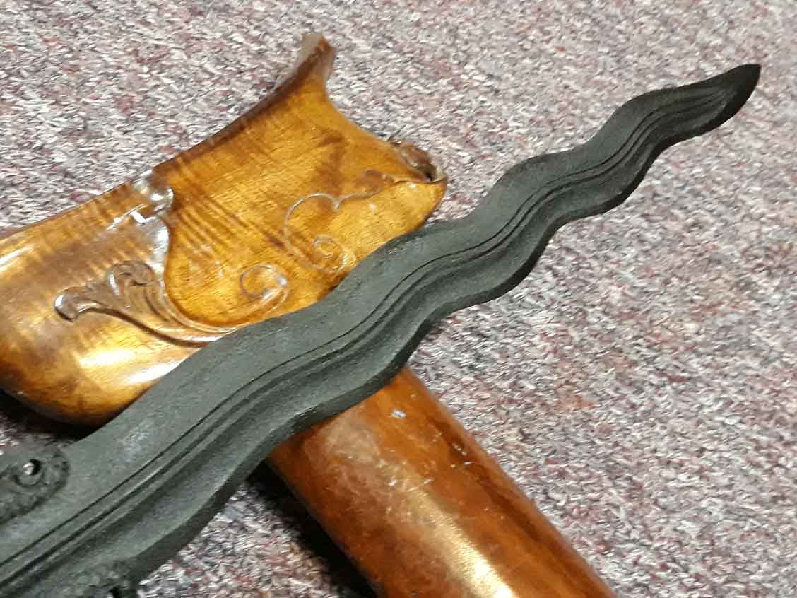

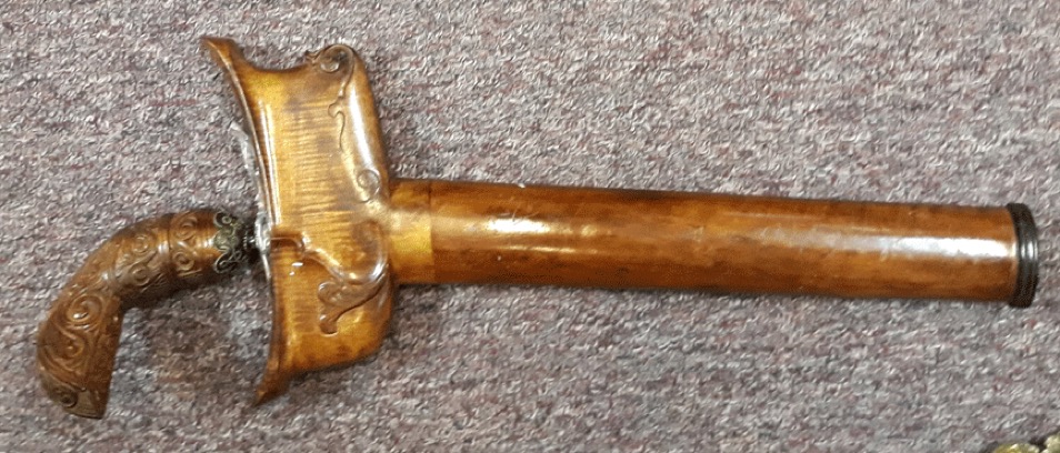

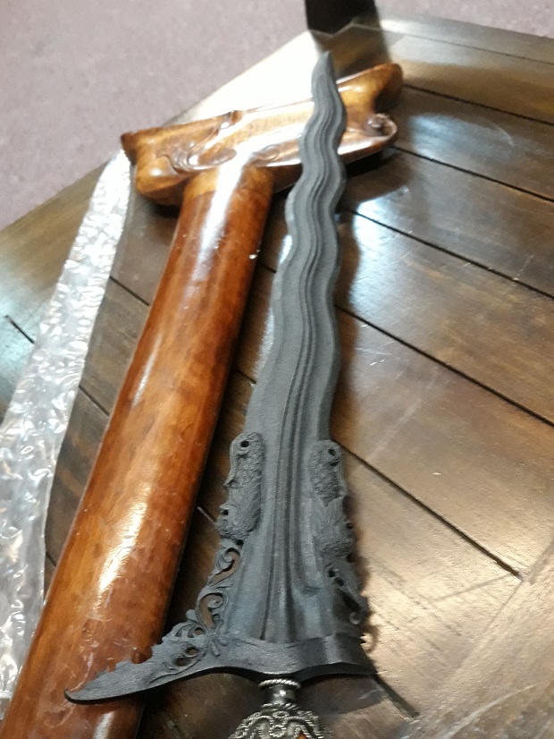

Default Uniquely Singapore Merlion Keris inspired by unduk-unduk

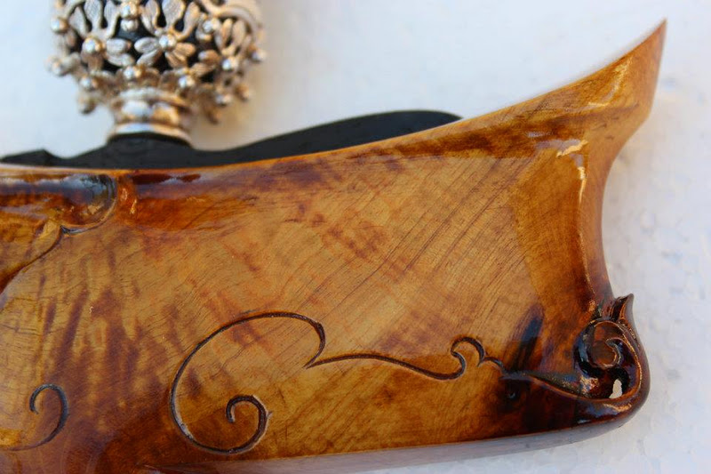

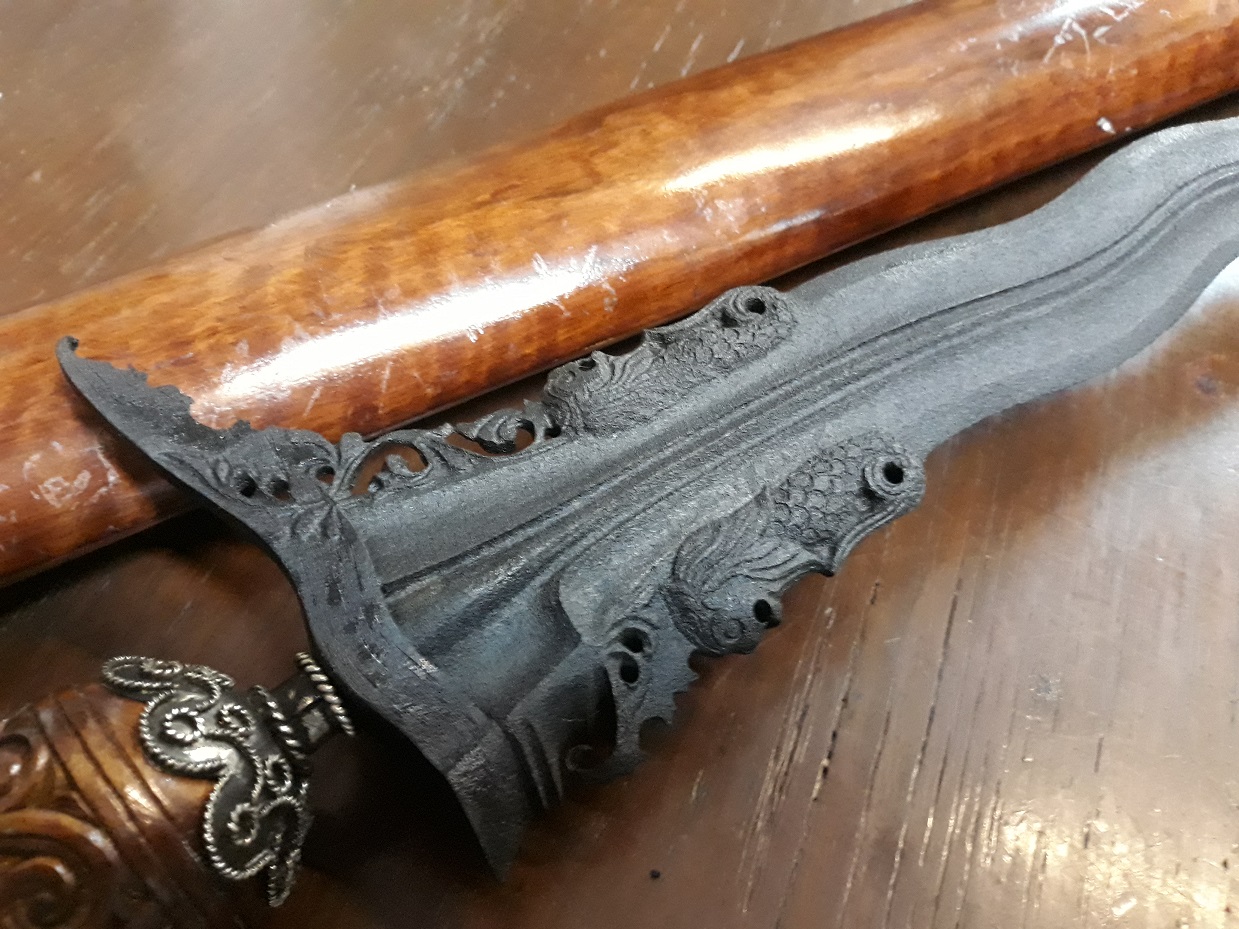

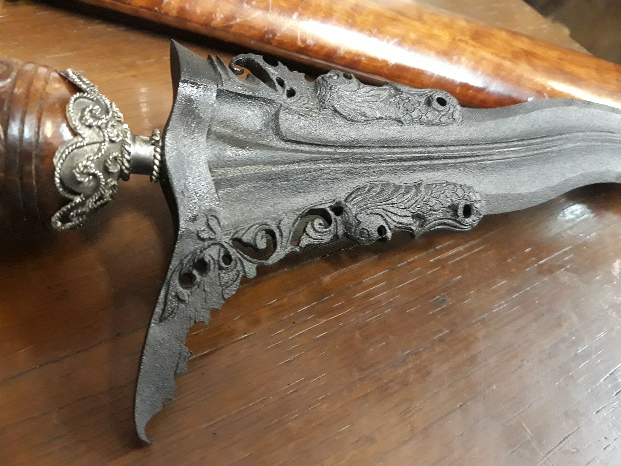

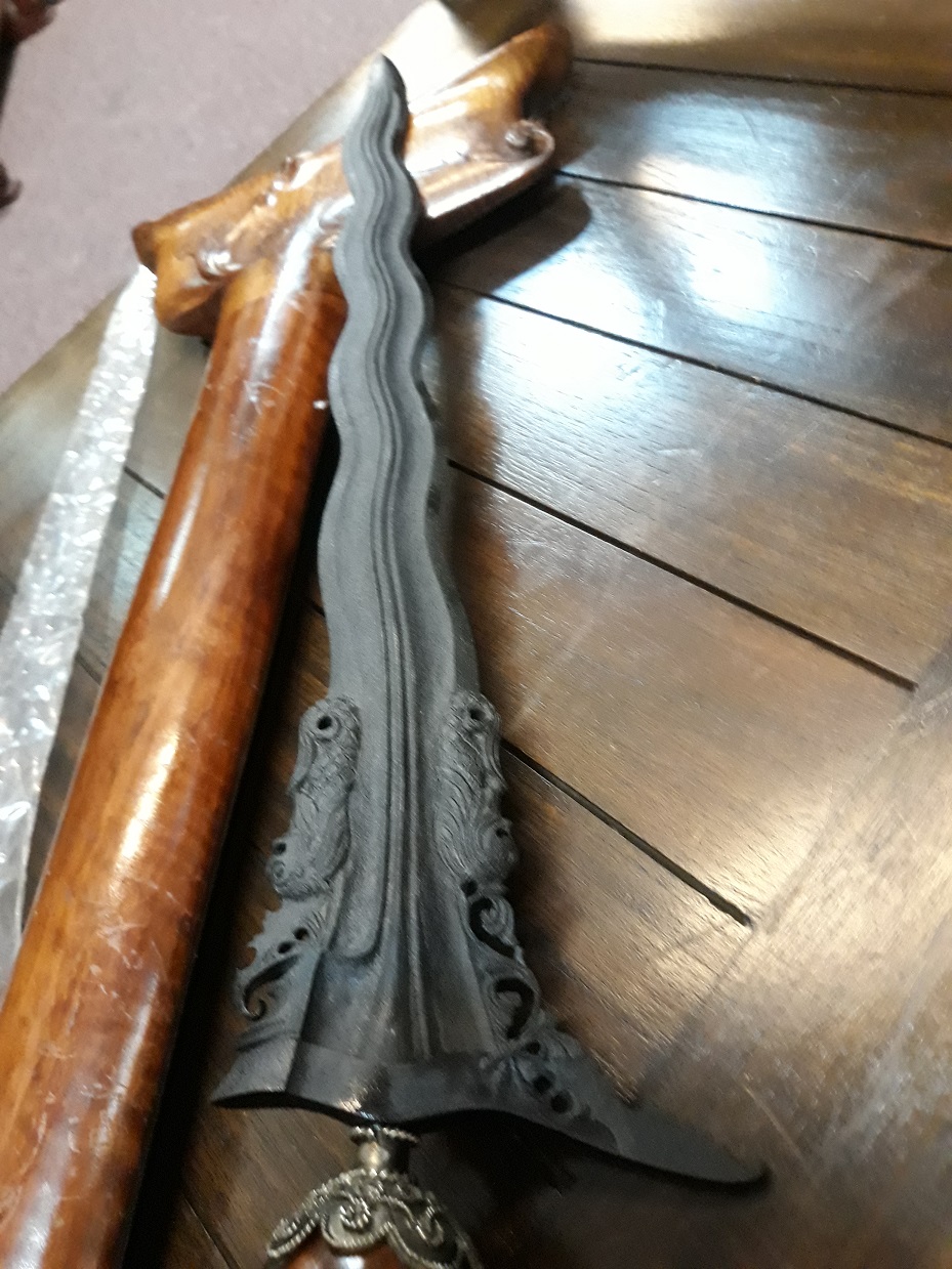

A uniquely Singapore keris inspired by the national icon of Singapore - the Merlion, as well as by the peninsular unduk-unduk keris.

Actually, this keris is inspired by the unduk-unduk (seahorse) keris of Terengganu state, peninsular Malaysia. Please see attached image. The sarung is a traditional form called Kusriwo, which is also associated with Terengganu state of peninsular Malaysia.

Alexis, an unique keris indeed. I cannot recall the Merlion ever being used in keris design before and find it a strange choice indeed. As far as i can tell the Merlion is a completely modern and commercial construct. The following passage from Wikipedia discusses it's origin.
The symbol was designed by Alec Fraser-Brunner, a member of the Souvenir Committee and curator of the Van Kleef Aquarium, for the logo of the Singapore Tourism Board (STB) in use from 26 March 1964 to 1997 and has been its trademarked symbol since 20 July 1966. Although the STB changed their logo in 1997, the STB Act continues to protect the Merlion symbol. Approval must be received from STB before it can be used. The Merlion appears frequently on STB-approved souvenirs.
So you have placed a modern "mythological" beast created by a British ichthyologist for commercial purposes (promotion of tourism) on your keris as a replacement for the more traditional seahorses (unduk-unduk). I placed "mythological" in quotations because as far as i know this is a completely fabricated beast with no local mythology actually attached to it. Seems rather spurious to me. Also sounds like you might have transgressed some local legalities since the symbol of the Merlion is still apparently protected by the STB and permission must be granted for its usage. Someone might take this keris for an official STB souvenir.
IMHO there are only very few nicely chiselled unduk-unduk and even fewer well-sculpted blades with this feature.
Legalities and the merlion being some kind of commercial modern idea aside, I don't think its placement in the pudhak sategal area is well advised: IMHO the stocky body completely breaks the flow of lines of the whole blade. If you have to, it might possibly work out reasonably well as a figure at the gandik area though...
I don't think this rather non-traditional version will "fly" with northern Malayan aesthetics. Got it carved on Madura, too?
You're certainly rattling the cage with those creations. However, I believe this is too much of a mix'n'match approach with too many influences from distinct cultures to be digestible from a more traditional perspective.

Aside from the blade, any of you fellow collectors have any further opinion on the Sarung, which I think is quite a traditional Malay Kusriwo design, even though it was carved in Madura?

Well Alexis, no one has a "patent" on the Merlion other than the Singapore Tourist Board (STB). One can apply to the STB for permission to use the image of the Merlion and my understanding is that if they approve you may use it at no charge. Your Singapore dealer may have made such arrangements with that board.
I really know only one Singapore dealer, but i do not believe his identity is pertinent to this discussion.
Your "Malay Kusriwo" sheath does indeed seem to be based upon a traditional Malay form, but i believe the carving flourishes and the manner in which they are carved gives it away fairly easily as a Madura product. As for the blade itself, this does not seem to be one of the better quality ones you have shown in the past. Is this the same smith who did your "Minangkabau" keris, because if so it does not seem to be at the same level of craft or execution, especially when we examine the carving of the greneng and the open carvings around the base.

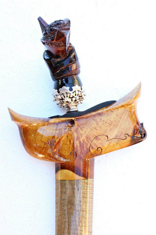

Default Sarung - Original Designs
Dear Collectors,

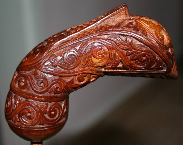

These are the original sarungs that inspired my piece. Any opinion whether these are traditional designs?
alexish is offline   Reply With Quote

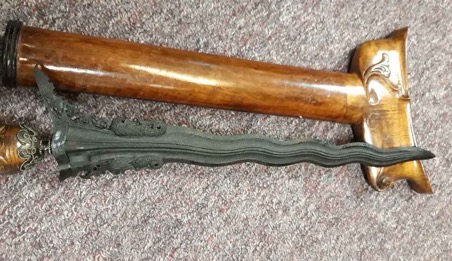

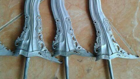

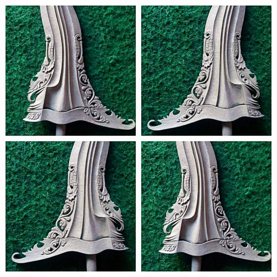

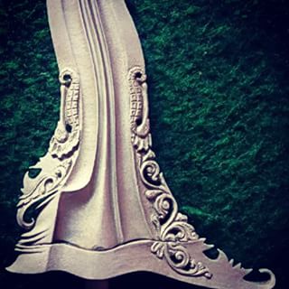

Default Original Unduk Unduk Blades

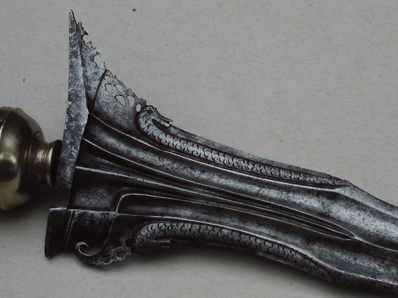

Here are the original designs of the unduk-unduk blades that inspired my Merlion piece. Any opinion?

Any idea what kind of material is used to make this modern contemporary keris-like keris?
Well, the first thing i see in your models is a modern interpretation of an unduk-unduk keris design being mass produced for market. You show three exact copies of a keris design here. I don't think i have ever seen three keris made so precisely like the other. Same dhapur, sure, we see that often, but with nuanced differences, not carbon copies of one another. All these keris and the dress are very contemporary and more along the nature of commercial art pieces than ethnographic weapons. If a feeling of authenticity was your goal i feel like you would have stood a better chance basing your design on a nice pre-WWII example of an unduk-unduk keris than these modern clones. Then you take your copy one more step removed from traditional ethnographic weaponry by adding the Merlion, a symbol created for the Singapore Tourism Board by a citizen of the former colonial power (Great Britain), to be used by sports teams, in advertising, for branding, tourism as well as a symbol of national personification. The symbol appears frequently on STB-approved souvenirs.
We often ask ourselves here what defines a keris? What distinguishes a keris from a work of modern art or a keris-like-object? I believe the answers to that question will be slightly different from each and every collector. But i do think it is fair to say that what you commissioned here stands firmly outside the realm of ethnographic weaponry. Of course, your mileage may vary.

I believe that the sampir/warangka is made of kemuning wood, as seen from the flashing grain; while the blade is besi kelengan without pamor.

Isn't besi kelengan not considered correct for making heirloom blades from? Here's a reference: http://www.kerispusakajawa.com/2017/...aja-untuk.html

Well, this website is the first time i have every seen that written about keris kelengan. I'm would need to see some cross-referencing to take that more seriously. I might also add that what is true for keris Jawa is not necessarily true for keris from other regions of Indonesia and the Malay Peninsula, so even if we could find some verification of such a restriction it would not necessarily apply to a keris form the Peninsula. Keris Tajong are most commonly seen with pandai saras that are generally pamor-less. I think you might get an argument from numerous collectors if you were to discount all of those blades as invalid for the distinction of pusaka.
Of course this blade isn't actually a Peninsula blade, is it? It was manufactured in Madura in the form of a Peninsula style blade, or at least, with the intention of appearing that way. Though it is a dhapur that is completely new at the same time. So i don't see how any rules of iron types or lack of pamor can apply to such of keris even if they do exist. At the same time i don't see modern art pieces like this likely to be applied to a pusaka scenario down the line anyway so it seems a bit of a moot issue.

Pardon me but is the steel used a recycled steel? Any iron and nickel involve?
