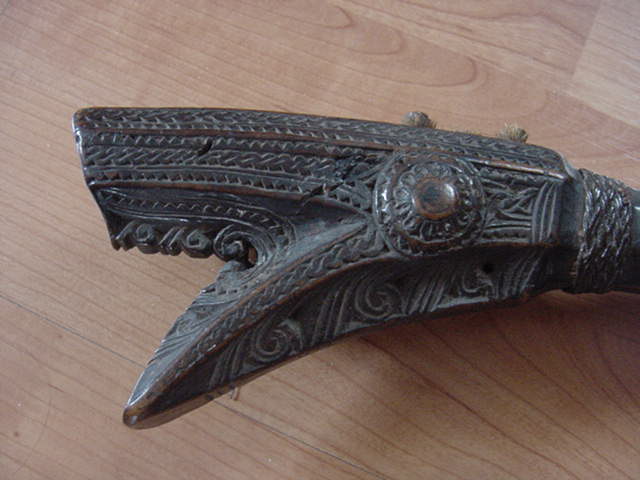

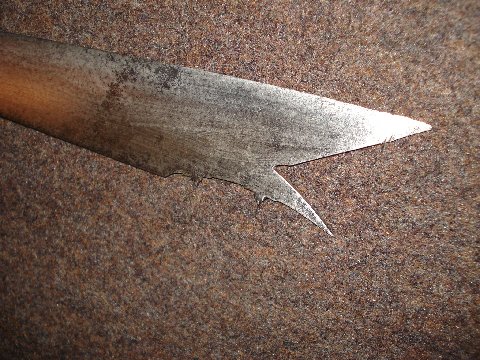

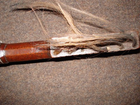

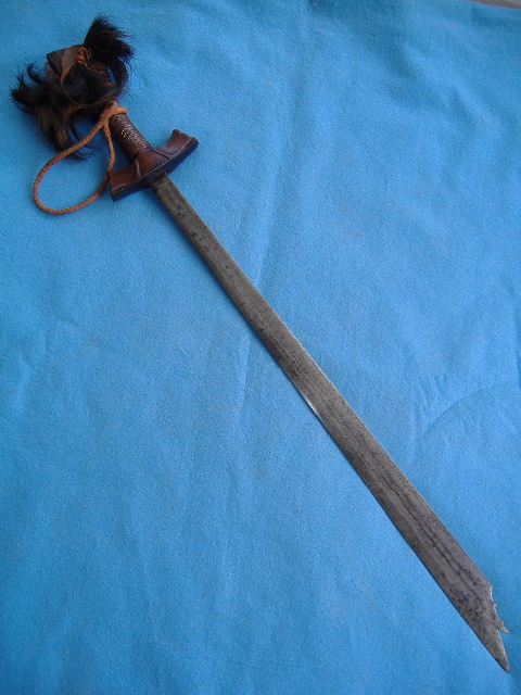

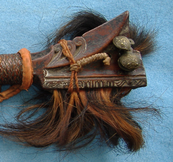

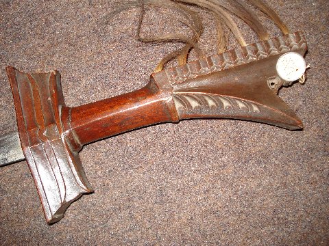

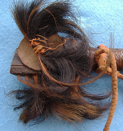

I have just received this kampillan and once in hand it really got my curiosity up, because it has a lot of somewhat unique features. I am wondering if it is Moro at all, but I think if it is Moro it is not from the Philippines.
VVV and I had a nice discussion this summer regarding the widespread use of the kampillan, and I am wondering if this piece may be from Borneo or even Sulawesi.
The blade is nice, yet not unique...it is a standard nicely laminated blade, but what is unique:
*short "crocodile jaws"....very little "open mouth"
*smaller hilt overall, with shorter, thinner crossguard
*hair is not attached in plugs glued into holes, but is attached in a long thin groove-like
opening rather than holes
*unique talismans; other than the tiger bells, these do not appear to be typical to
Moro kampillans
I'd like some feedback from others on the possible origins of this sword. I am wondering if anyone is thinking like I am??

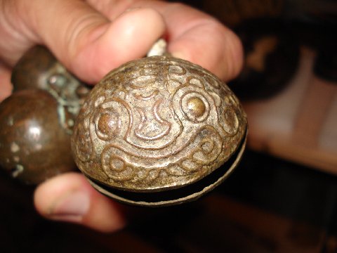

You get the most interesting pieces. I do not know enough about Kampilan to comment but an interesting example and those look like tiger bells but I could be wrong. There are references for tiger bells on Kampilan nad tiger bells can be found in Sulawesi
http://park.org/Guests/Tiger/indonesi.htm
And tiger bells are seen in the Philippines
http://park.org/Guests/Tiger/details.htm
Old 7th August 2007, 02:33 AM   #3
Bill
Location: Chicago area
Posts: 327
Tiger bells look a bit like the ones of the Iban. http://park.org/Guests/Tiger/details.htm#start but far from definitive.

can you id the hair at all? orangutan?

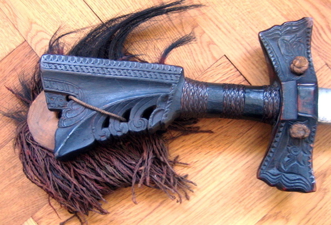

Great Kampilan!

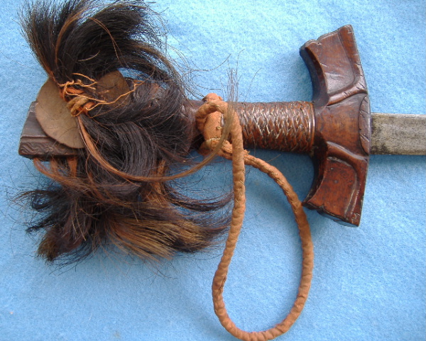

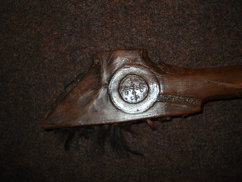

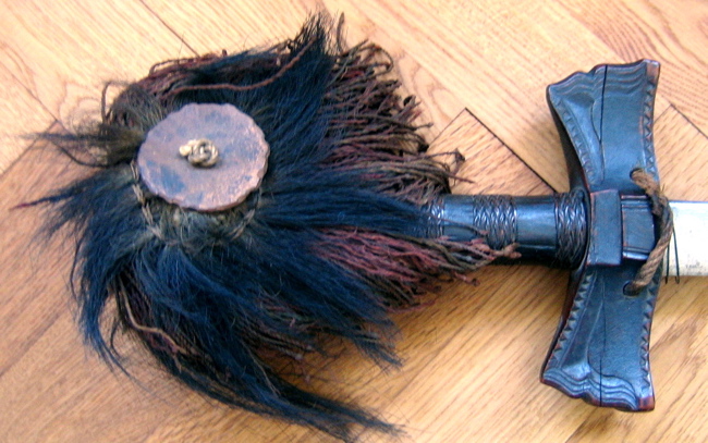

I think this is another example of the older style, maybe pre-mid 19th C, of kampilan before the later, large "crocodile jaw" became more popular.
It seems as those were extinct already during the Spanish American war which probaby is the reason why they seldom are seen in US collections.
The talismanic (?) hairy "hang-on" are also sometimes found on those kampilan (example below).
Another even more rare style is the horse head hilt. Examples of those are found on the pictures in Cato p. 53 and van Z p. 93.
My understanding is that the kampilan is a tribal (Illanun tribe), not a geographical weapon. This nomadic sailing tribe is found in Mindanao as well as Sabah (Borneo), Sulawesi and Timor.
Among people who has emigrated from their original culture old style and habits lasts longer.
An example is my mother who left Denmark in the late 50's. A Danish friend of mine was excited after talking with her because even if she of course spoke perfect Danish it was like "watching an old movie". Her Danish hadn't changed since the 50's and she had no new expressions from the last 50 years as well as some expressions and words that nowadays no modern Dane would use.
But of course it's still Danish as your kampilan still is Illanun...

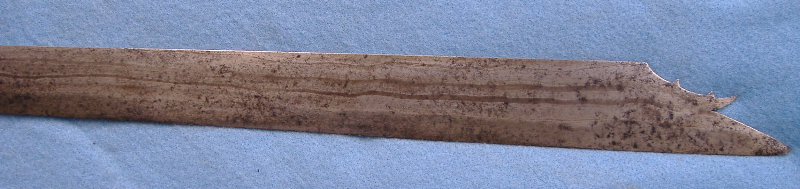

I also neglected to mention that the kampillan is about 6 inches shorter and considerably lighter than any other in my collection.

Hello Charles,
Thanks for posting these pics! You really get the nicest toys! <drooling>
I wonder why nobody mentioned it yet: If you ever want to let this piece go, please drop me a line, pretty please...
I don't think this was ever intended to represent an animal.

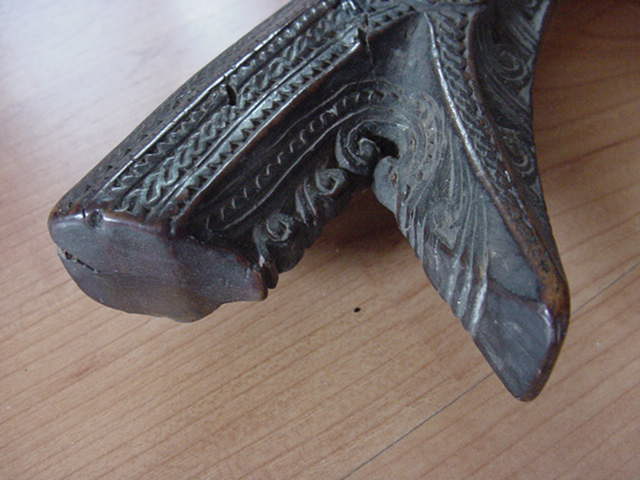

*hair is not attached in plugs glued into holes, but is attached in a long thin groove-like opening rather than holes

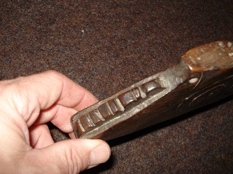

Could you please show a close-up? The decoration at the bottom side of the hilt still seems to be applied in tufts.
*unique talismans; other than the tiger bells, these do not appear to be typical to Moro kampillans
The attached tassle seems to be close but slightly different from Michael's.
BTW, attached bundles of hair like in your example seem to be more widespread in the area. Are these documented from any non-headhunting culture?
Illanum seems to be a good guess - possibly more East than Borneo...

Tiger bells where used from thailand india Philipine to Borneo
It is no indication off country or people.
Ben
Old 15th August 2007, 01:15 AM   #20
Posts: 7,412
Ben
Although this is true, in the Philippines, most Moros did not use them and you are more likely to see them among the Bagobo and other Lumad tribes. None among the Igorot tribes in the north for example.

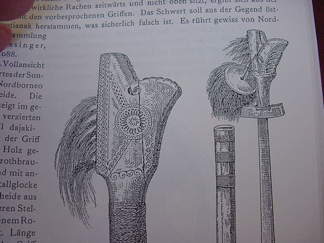

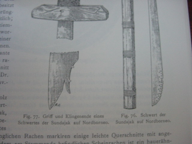

Hi I found the drawing in the book off Hein he tells this is from the Sundajak on North Borneo page 347 fig. 76
Ben
Old 18th August 2007, 08:48 AM   #22
Dajak
Dajak's Avatar
Posts: 952
Default drawing
Drawing
Old 18th August 2007, 09:24 AM   #23
VVV
VVV's Avatar
Posts: 1,637
We discussed those pictures in this thread
http://www.vikingsword.com/vb/showthread.php?t=2820
I suspect when Hein writes Sun dayak it's the Dusun tribe. And that he mixed up the Dusun with their neigbours the Bajau tribe. At that time most of the Illanun had disappeared because of intermarriage with the Bajau according to Ivor Evans' book mentioned in the thread above.
I find Evans' several years of anthropological field research in Sabah better for separating the tribes than Hein's armchair studies.
On the tiger bell issue I agree with Ben. I find it hard to believe that all the large Kampilan with tiger bells you see now and then are Bagobo?
Michael Evan s did not study the indonesian and Borneo swordhandle s
Only the malay people as far as I can see
and it is also relevant wich time they study because 20 years difference make s a lot off differens between the aerea wich what was going on and there where also sulu s
living in the North part off Borneo .
I can t find nothing that he mean sundajaks that they are Dusun otherwise he would call them like it.
He is the only one that pictured the handle off the rare parang sankit .
I cannot find that in Evans books .

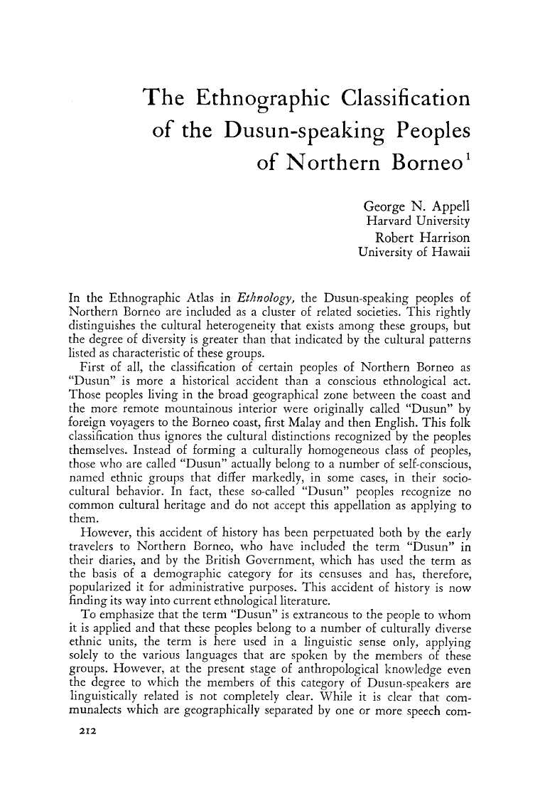

The Ethnographic Classification of the Dusun-Speaking Peoples of Northern Borneo
George N. Appell, Robert Harrison
Ethnology, Vol. 8, No. 2 (Apr., 1969), pp. 212-227
doi:10.2307/3772983
Ben

Hi Ben,
Hein didn't visit Borneo but made his studies in European museums and libraries.
Evans based his research both on older local sources as well as field studies among the different tribes.
Visiting villages and interviewing f.i. swordmakers about what weapons they produced and what weapons their ancestors produced.
He also researched what weapons that were used by the different tribes and where they came from if not locally made.
Evans' book is focused on in depth describing the Dusuns (p. 79 - 193) and the Bajau & Illanuns (p. 194 - 273).
Hein based the name Sundajak (see note 2 on page 348) on the publication by Dr Eduard Sonne; Die Bewohner Britisch-Nord-Borneos mit besonderer Berücksichtigung der Badjohs, Tumbonoas und Sundajaks (1893).

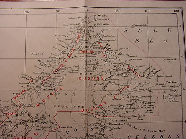

Badjohs is probably Bajaus. Tumbonoas is probably Tambatuan (which isn't a tribe but a district inhabitated by the Dusun tribe) and I find it quite probable that Sun is Dusun.
The reason for that is that no other source I have read about dayak tribes in North Borneo mentions the existence of any tribe named Sun.
If it exists, or ever existed, please give me a reference for this and I will of course change my conclusion?
I have gone through the major 6 works on Sabah Dayak tribes but found nothing on any tribe called Sun.
Also it would be extremely strange if Sonne didn't include the Dusun when describing major tribes in ex-British North Borneo?
That would be like neglecting Iban if describing tribes in Sarawak.
The reason Evans don't mention Parang Sangkit is that he doesn't write about the Muruts in his book.
Hein isn't 100% impressing on this as he isn't sure if the Sangkit is from Borneo or Sulu (see p. 343) ...
doi:10.2307/3772983
Ben
Please explain how this, probably interesting, article contributes to our discussion?
What's interesting is that Evans describes the weapons of Dusun as "largely procured from other tribes".
He lists the pida (barong), the pedang, parang ilang/gayang and sundang/serundang/kris as the Dusun swords - not the kampilan.
In the Bajau & Illanun weapon descriptions he writes (p. 253-254):
"...while the long Illanun sword, the kompilan, with its curiously carved and flattened handle, and its blade, narrow near the hilt, but broad and heavy at the point, came from Mindanao, the place of origin of the Illanuns themselves. Types of handle and blade somewhat similar to that of the kompilan are, however, found in islands farther to the east, notably Celebes and Timor."

some pic s off my kampilan I think this one is from Boneo
Ben
