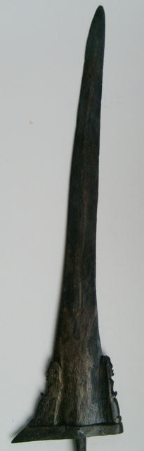

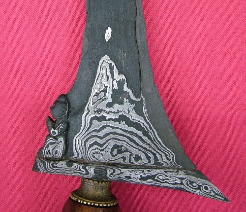

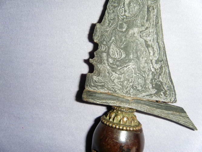

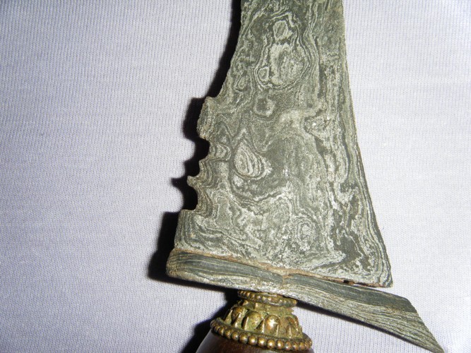

I put this keris up for coment and discusion to learn.
I bought it from a older collector , this keris was in his collection for a long time
but i like to hear what are the meanings of other,s ?

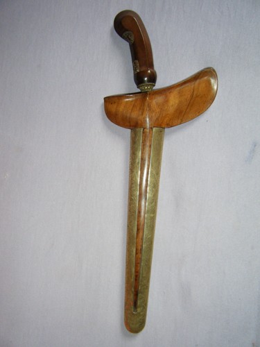

Of course there is a waraka and hilt for this blade but i wan,t the focus on the blade .
Dapur Petut Kembar
Age Pajajaran Segaluh ????
Al coments are welcome.

Please post the fittings later on!

Looks like a reworked (chisel marks and allocation of rust pittings on the back side putut) huge (Tuban?) blade.
Yet I don't understand, how the front side Putut is done. Was this a sort of Kebo, or is it welded on?

it looks like tangguh Tuban-Padjajaran based from the pics

In my humble knowledge, although possible and example may exist, contrary to western believe that many putut and other blade with character carving are rework pieces, they simply are not.
Not likely a 16 c./older in my opinion. I would conservatively date the first half of 20c.
Would like to learn the philosophy behind dapur Putut as well (also similar dapur like Semar Pethak) and how long they have been around.

Hello all,

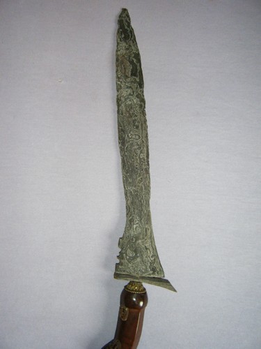

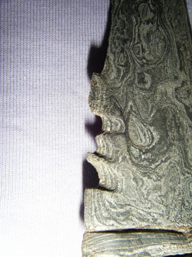

like I write Danny by e-mail yesterday I am the opinion that this is a reworked blade. The characters are to sharp at the edges. I have asked Danny if the characters are thicker as the blade byself, I think that this is a good first indication. The front figure is thicker so I think it is welded on like Gustav assumed. I may be wrong but this is the impression I get by the pictures.
I don't want to foreclose that this is like Chandra write a blade from the first half of the 20th century.

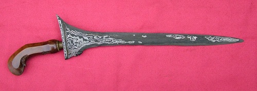

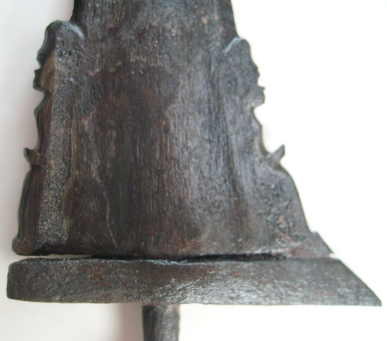

Attached a picture of one from my putut blades which is genuine (I think and hope ) for comparison.

I realy have no idea if the blade is a reworked keris , i only strong have the feeling that the blade is old , when i look to te collor and the structure of the iron. ofcourse it can stil be reworked .
Kai was asking for the dress , i think it has no use to show it , it,s made for the keris and ofcourse younger .

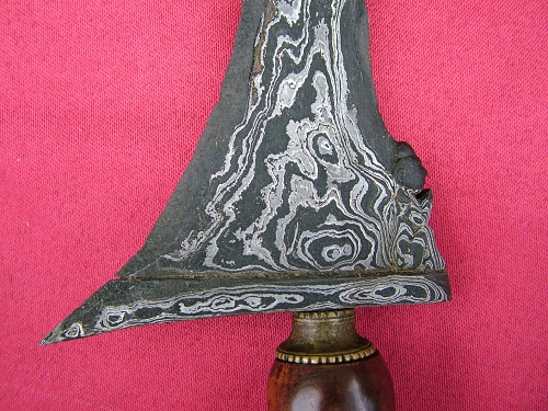

Detlef , yes we talked about it by email. one petut is a little thicker and one side almost the same thicknes as the blade . The edges are sharp, but i know keris here in collections in Holland that can be proven to be old but stil have sharp greneng,s and almost no wear on the blade , so...
I can make aditionel pictures when needed , this wil be a intresting discusion

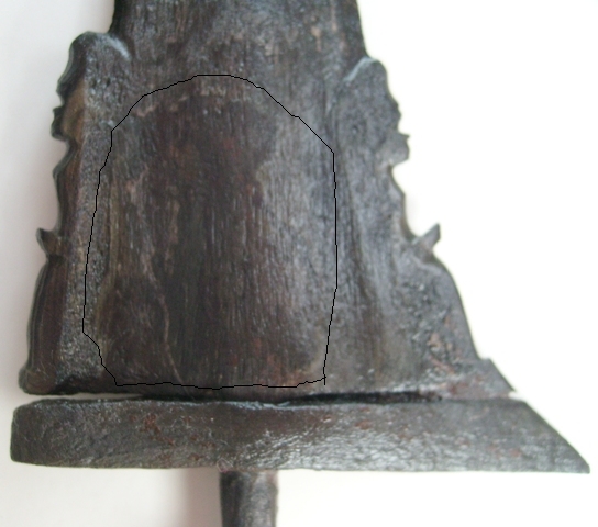

Has anybody noted the weld pattern in the sorsoran?

Do you mean this area I have outlined (rather badly) Alan or just the area between the figure on the left side and the blade
Drdavid
Old 22nd March 2011, 08:27 AM   #12
Posts: 7,255
Yes David that is exactly what I mean, plus the other border of the same material that is above it. Effectively we're looking at an added piece of material.

So, can we think that the blade had one petut and that they put a second one
from a other blade on the other side ?
Or did the reshaped it and aded the two petuts ?

looks like a large piece of metal has been welded in at some stage. I suspect by the shape that both petuts are later additions. They are not particularly elegantly done. The gonjo is not too convincing either, especially when you look at the relationship to the gandik. I also suspect that the blade profile has been 'adjusted' at some stage. Just my opinion though, i am a novice

My feeling about this blade is as follows, and it has my usual qualifications that if I had the blade in my hand I could alter what I have said, but in this case, not by too much.
I believe that this keris started life as a big, old Tuban blade.
A piece was cut from the point end of the blade and fire welded across the sorsoran.The existing gandik would have been incorporated into this weld.
The two puthut figures were carved from the added material, the blade profile was reshaped, and the gonjo reduced to fit.
The alteration of ordinary old blades to turn them into something more attractive from a commercial point of view seems to have been a very long standing practice in Jawa. My guess is that it goes back to the early part of the 19th century.
David, for a novice your guess was pretty good.Possibly demonstrates that most medicos are skilled observers.

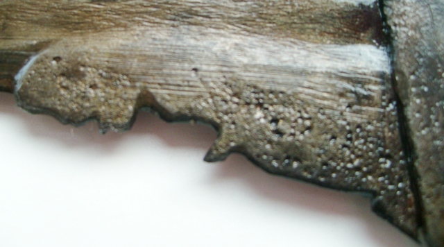

Yes i did observe the blade and the ''welded piece'' is only vissible
on one side of the blade . I did take a risk by purchasing this keris
and that is why i wrote ..i,m less happy with the blade , not because of the critic but because me buying it

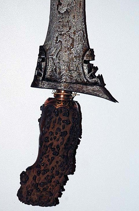

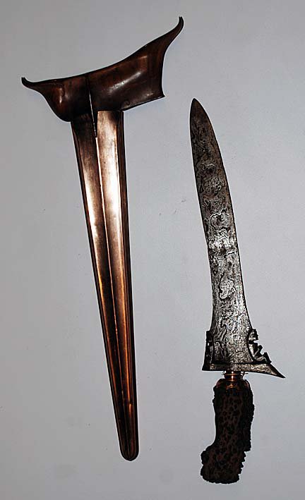

Apart from that, I'm also interested in seeing what an original keris puthut (perhaps photos from a museum) looks like, if anyone is willing to share.
Old 26th March 2011, 02:27 PM   #25

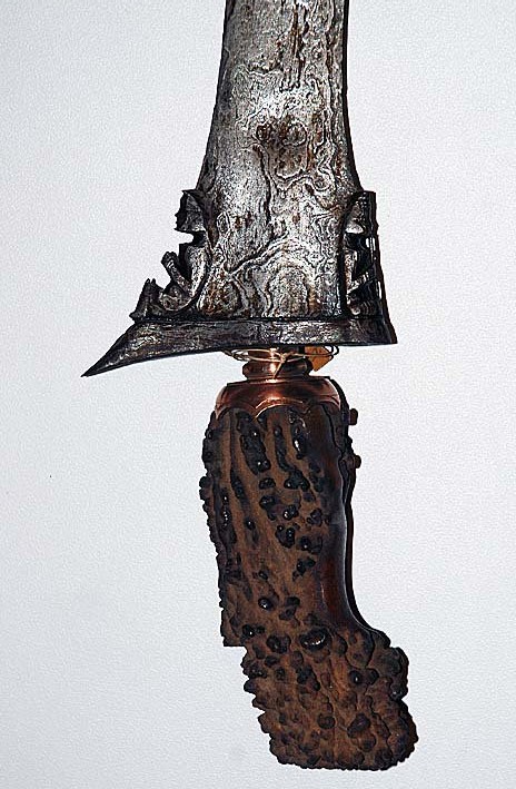

Hello Kai Wee,
This is my keris puthut and I am pretty sure that it is an original old one. Here some pictures from it. It is also a pichit keris, I hope it is clearly to seen by the pictures. Would be interesting how you call a keris like this.
Pictures courtesy of pak Ganjawulung. Taken from National Museum, Jakarta.
Featured with a Banten styled sheath, a keris estimated to be from the Pajajaran period, with dapur Puthut Kembar. Believed to be the property of Sultan Muhyi of Banten, with its unique hilt, probably made from horn.
Old 29th March 2011, 04:01 AM   #29
semar
semar's Avatar
Join Date: Jul 2007
Posts: 272
Default fore compare
petut
semar is offline   Reply With Quote
