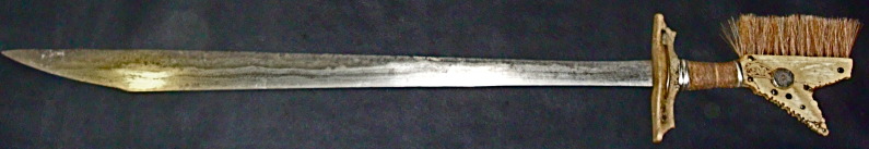

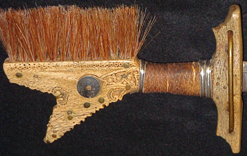

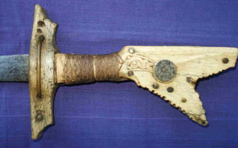

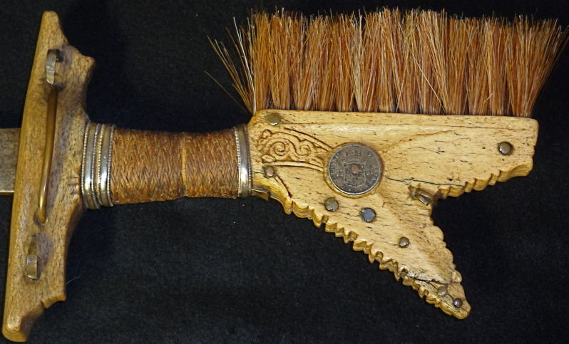

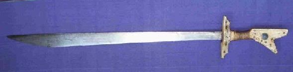

Well, here is another restoration I did for the present owner of this famous whalebone kampilan. Here are before and after pictures. The new bands are silver, the hair naturally colored horsehair, and I made a brass hand guard bar to replace the missing one on the other side.
Enjoy!

Great work Jose. What did you use to condition the braiding on the hilt and the whale bone itself and could you please show a picture of the other side of the hilt?

Sure I'm game - here is the other side with the brass guard I made - matches the other one.

Nice silver work Battara. Did you use sterling?
How was the length of the hairs determined?
BTW, I don't know why this Kamp is so special ........sigh.....
Old 11th March 2011, 06:10 AM   #7
Posts: 7,406
Hi Kino,
Yes I used sterling. They often used sterling to coin silver. Occasionally higher grades of silver, but that then becomes too soft.
The owner wanted it cut, so I loosely based it on others like this and my own ivory kampilan hair.
