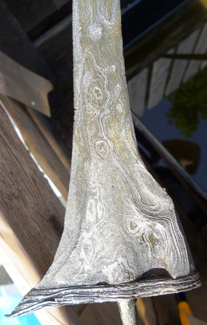

Photo 1 : my luxury washing tube The blade are drying after cleaning
with detergent and lime .

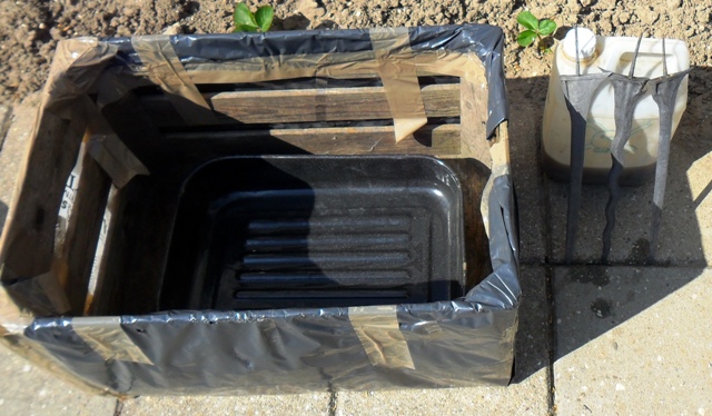

Photo 2 : Drying and heating up after the first soak .

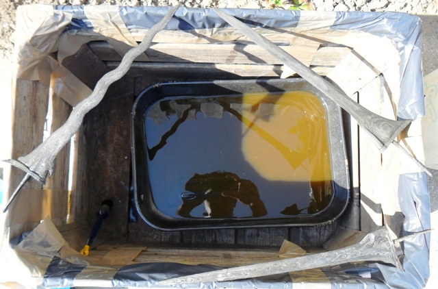

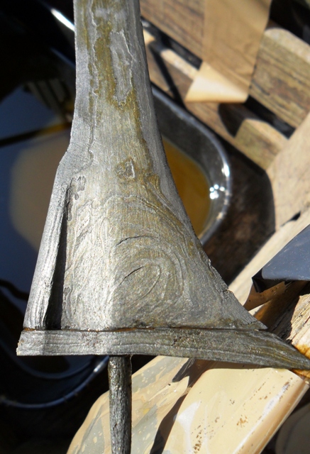

Photo 3/4 The pattern is coming up .

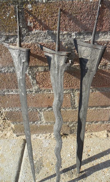

Photo 5 : Finished the soak and drying in the sun before oiling .

And the result .
After a night drenched with WD 40.
You can see clearly the differences in color of both blade,s because
the using of material and the time when the were made.
