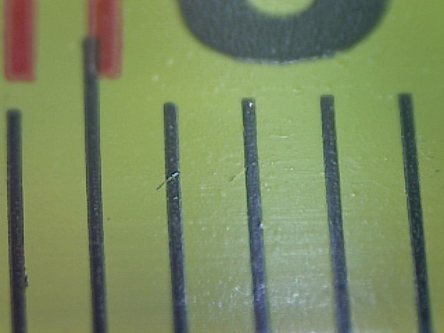

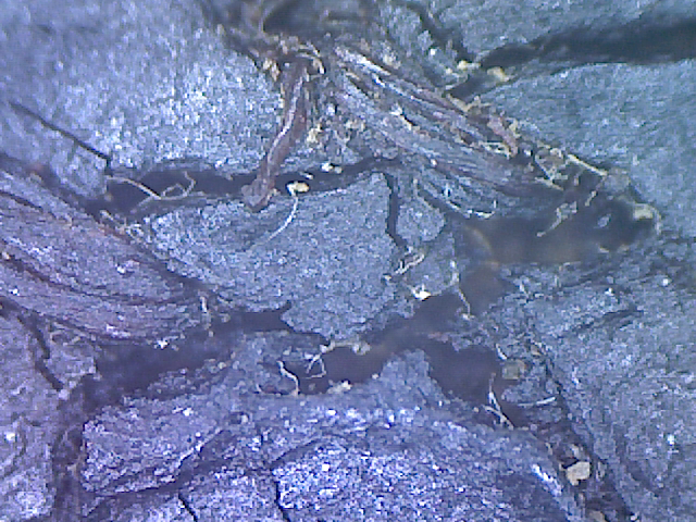

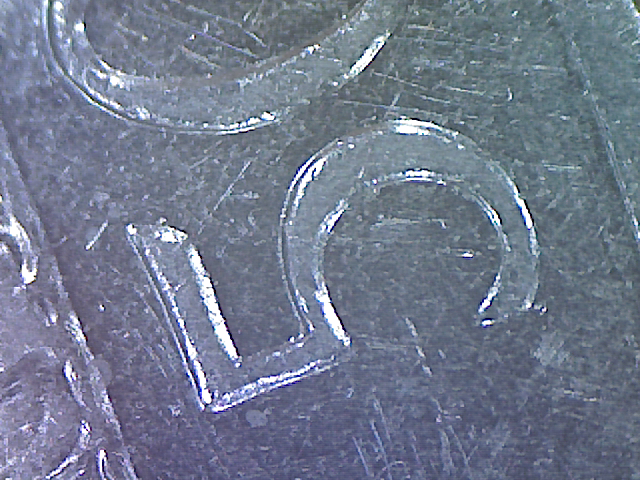

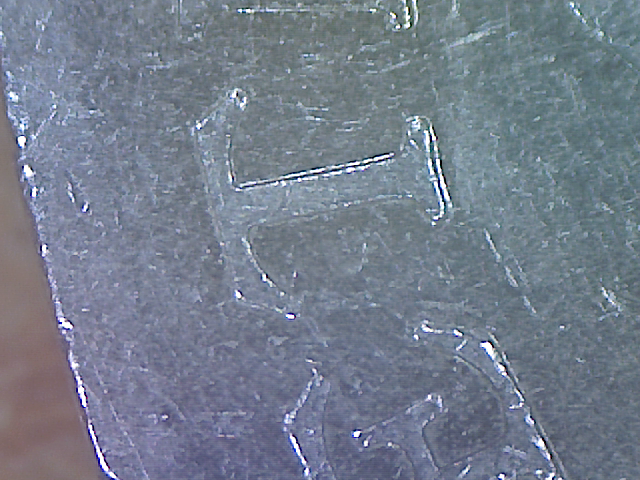

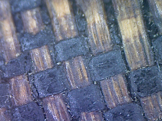

here are some quick images including a blade, stitching and woven reed pattern (reeding less than 0.75 mm in width) on an african scabbard, a British 50p piece, human hair and a metal tape measure (each graduation = 1mm)
I am suitably impressed
Regards David

As Thilo has stated, the 200x mag seems a little exagerated (I never believed it would be that good) but, nevertheless certainly seems to be at least 30x. The pictures I have posted are not 'photoshopped' ....so there is further 'scope' to improve the pictures. The illumination is provided by LED's intergrated into the 'telescope' and seems to be sufficent without causing glare from shiny surfaces.
They certainly are 'fun' though and bought it to investigate some of my collection.
Regards David
