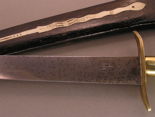

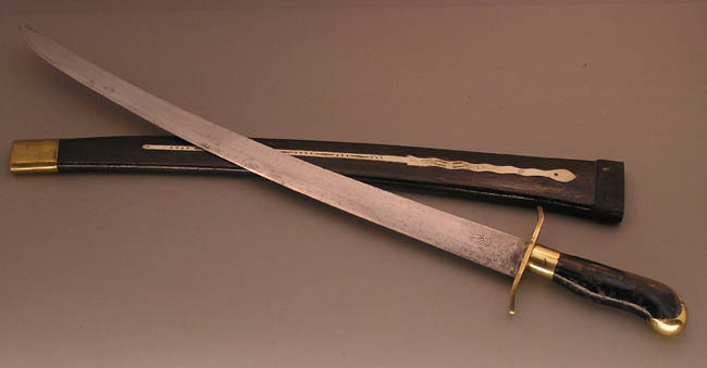

This sword showed up recently on ebay, and was described as a 19th Century Korean blade. It did not attract much interest, perhaps because it did not look particularly 19th C. nor much like the Korean examples from the History of Steel exhibit cited as similar. I figured it was a decorative copy of Korean sword, but threw a bid at it anyway because a friend of mine is studying Kuk Sool Won and has been badgering me and another swordsmith for a Korean sword with which she can do the sword forms of that martial art, and I figured there might be some useful info to be gleaned from even a decorative copy.
The auction ended with my bid on top, and when the sword arrived I was pleasantly surprised to find the blade not only heat treated, but also made of folded steel! The heat treating is of what I presume to be a distinctive Korean style, one that I have only noticed in the few historic Korean blades whose images are on line. The hardened edge starts well above the hilt, and as it approaches the point it dips down towards the edge and stays close as it sweeps around the point of the blade. This style of tempering would almost guarantee that your sword would not snap off at the hilt or lose its point in battle, though I bet you’d find it more likely to take a bend down by the hilt if the blade were subject to lateral forces. It would be interesting to find out if Korean martial arts take this style of heat treating into account in the way the sword is used, especially in comparison to the martial arts of cultures that have a more uniform heat treating style.
Due to the simplified blade geometry & construction as compared to authentically old Korean swords, as well as the character of the steel, I suspect this is an example of a revivalist Korean sword maker’s work, from the 1960s or 1970s…however there is not much info out there to help confirm or deny this suspicion. If anyone finds a reference that has info on Korean swords like this one, dao-based geometry without a collar on the base of the blade, it would help me place this one in its proper history.

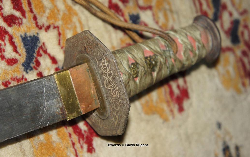

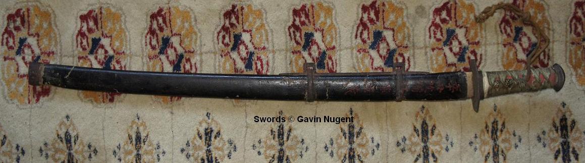

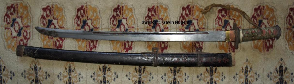

Thought I'd bring this ole thread back to life with an example recently found.
Named and dated too, a little rough around the edges but overall a fine piece.
All steel fittings are silver inlayed, all parts present except for the throat fitting.....a cleaning project for later in the year.

Interesting Korean sword Gavin! It is always interesting to see such rare swords that show an interesting blend of the influences of their neighbors China and Japan!

You stole the words right out of my mouth (or type right out of my keyboard?)... The hibaki, ito and menuki (and to a lessor degree the blade profile, tsuba and seppa) all show a strong kinship to their Japanese counterpart, while the pommel and scabbard appear distinctly Chinese.
Gav, I'd be interested in seeing some close-ups of the blade steel, and to hearing your thoughts on the bladesmithing...

Patience grasshopper
It wont be this week coming but I will try a small window etch to see what gives...I'd love to think it has a horse tooth pattern like one found in the initial link but I'll have to wait....the blade is I think is just a very finely laminated pattern.
It is a stout blade at 67cms long and would take the leg off a horse that is for sure....

This example is made in the Chinese manner being the tang through the pommel to secure it.
In this piece it is the blade, then the habaki, a seppa, guard/tsuba, another seppa, iron collar, the hilt slabs, the pommel, a small washer and peened tang. Grips bound in painted ray skin, grip cord in the Japanese manner with the menuki to each side in Japanese manner. There is a lanyard through the grips and I imagine the tang too.

An interesting point I thought was worth noting is the presence of what in the past was called a brick; see post 1 in this thread started by Bill M;
http://www.vikingsword.com/vb/showth...hinese+pitting
The interesting thing is, this sword only has one that is able to be seen in the current polish but why it is seen is that it looks to have never been filled. I am uncertain why it is there as there is little wrong with the polish surface, it appears all original???
Image to follow with further updated.
