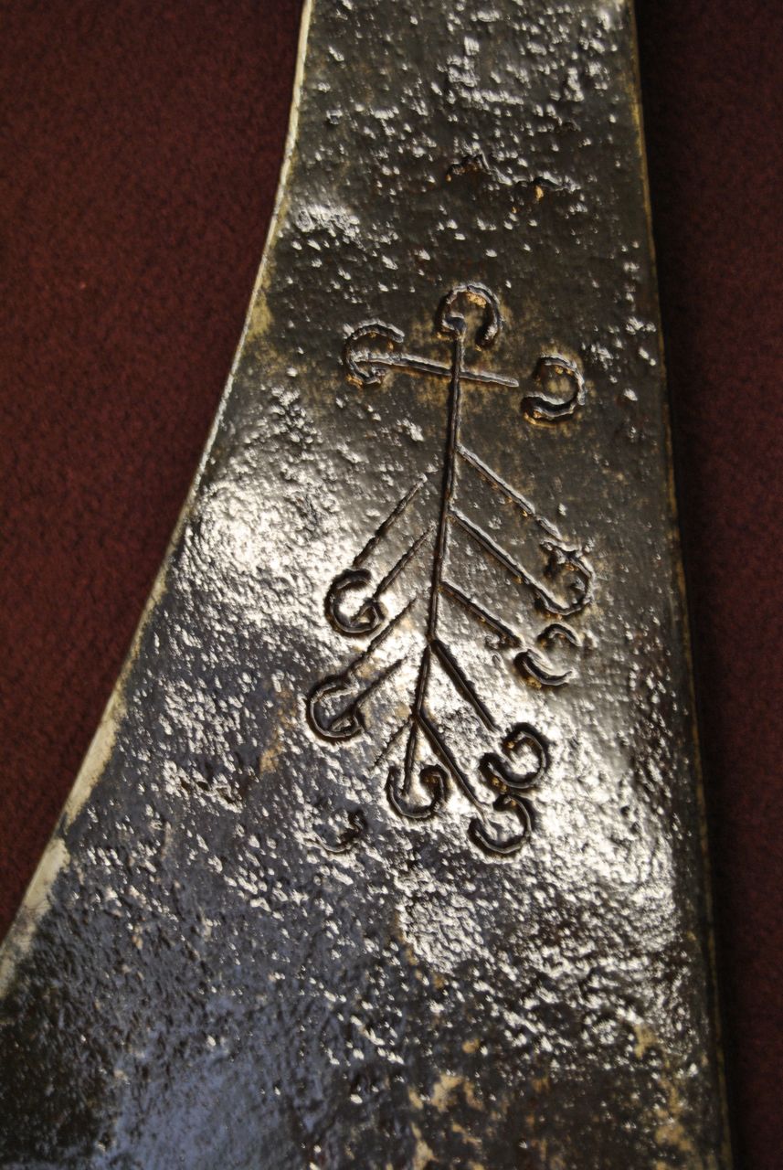

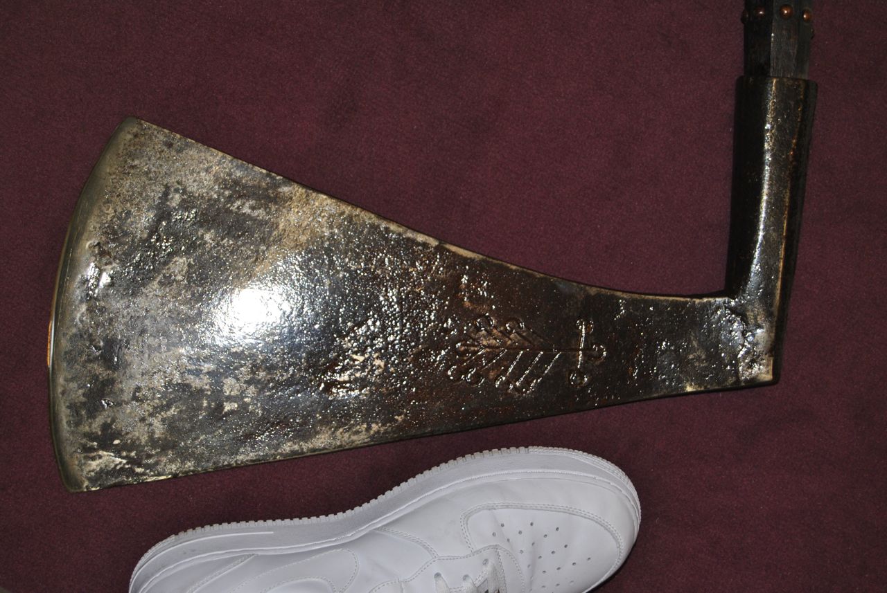

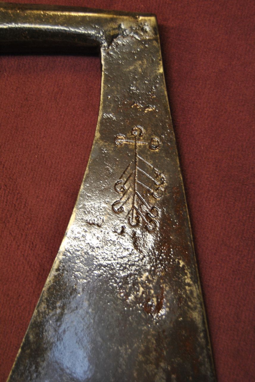

Hello everybody,
I found this big European axe with this mark of smithy.
Someone can give me information about this mark ?
Thank you in advance for your answers.

To my best knowledge this is not a smith's mark but a religious symbol. It is not uncommon to find similar marks on plenty of european steel tools dating from the late middle ages to the industrial revolution. It is some kind of a code, with repetitive marks usualy meant for good luck. It looks like the 'tree of life' merged with a trinitary cross.

I agree with Broadaxe, this is certainly not a makers mark, but a symbol which may have been intended to carry certain magical or talismanic properties. I am not especially well acquainted with axes, but this thing seems unusually large for a war axe and even more so as a tool.
As far as the marking, it is indeed in a sense quite possibly religiously based, as such marks typically were in early times, but may also have other symbolism.It seems like the letter 'G' appears at many points on the figure, which is situated in the configuration of a cross with many added arms at different angles. In many ways it resembles the 'anchor' which is a cross disguised with numerous added patibulum and serifs and seen on many Solingen blades (esp. with Spanish motto) of 18th c. and on many earlier Spanish blades.
On the other hand, it very much resembles a much earlier kind of marking in this kind of configuration known as a 'carroccium' which in actuality was a full size standard assembled on a wagon and used in Germany and N. Italy in medieval times (after mid 11th century). In these standards were religious devices and typically topped by a cross. Markings resembling these armed are known on some sword blades as early as 12th century (Oakeshott)but probably continued later and may have inspired the later 'anchor' type figures.
Again, not familiar with axes, nor the types of markings usually found on them, but it does not seem unreasonable to see such marks on various weapons in N.Europe. I would defer on the age of this piece to hands on examination. How long is the haft, if there is one on it?
Also, with response to the letter G, as well as the note to the 'Tree of Life", in esoterica such as gemetria and Cabbalistic lore, this letter is also associated to the Hebrew 'yod' which among its meanings represents the seed of the Tree of Life. Im not sure exactly how that would fit in here, but thought it would be worthy of note in examination of the mark.

As far as I can see, this axe, by its typology and form is very similar to English headsman axes of late 16th-early 17th century. While I see what appears to be genuine age pitting consistant with a weapon this old, which seems to have been cleaned, if it is of period that would rule out being a later ceremonial or fraternal type accoutrement or regalia item. What brings that to mind is the fact that the letter 'G' is well known in Masonic symbolism, and though the Tylers sword as a ritual piece is established I know of no use of large bearing type axes used in thier ceremonies.

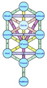

One such element of Cabalistic symbolism was the 'Tree of Life' which seems to have representation in many religions and traditions in varying form. In Jewish mysticism, it occurred in a strikingly similar configuration with the top and bottom and branches having orbs, and ten in number. These represent the ten Sephiroth and thier enumerations. In the case of this example on the axe, there appear to be 11 capital G letters at the terminus of each 'branch'.
While this discrepancy can fairly eliminate the distinctly Cabalistic connection, it does not eliminate the potential for it being evolved from or mindful of the original configuration.Though its actual meaning ,now out of context,cannot be determined without further evidence, it does seem to be a 'Tree of Life' related symbol. It is unclear what the G means, and though I thought it may be connected to a Hebrew letter with symbolic meaning, I have not yet found satisfactory support for that, so I will leave the capital G significance as undetermined.

I had mentioned earlier similarity to the 'anchors' or cross type figures with numerous crossbars with serifs in variation and number. These occur as noted on various blades in about early 17th century from Germany and Spain and seem to have evolved from Cabalistic sigils. These were not makers marks (though sometimes associated with certain ones through variation), but actually talismanic applications often accompanying other inscriptions.
That was what I referred to in considering the configuration of this marking, which at this point seems most closely connected to the Cabalist figure of the Ten Sephiroth, or Tree of Life.

Probably more likely is that it is indeed a tree of life depicting all eleven of the Sephirot. Actually you already have an image of this in your attachments. The configuration of ten is:
KETER, CHOKHMAH, BINAH, CHESED, GEVURAH, TIFERET, NETZATCH, HOD, YESOD, MALKUTH
The addition could be DA'AT, which usually replaces KETER in later versions but I guess could appear side by side.
The capital G letters may be nothing more than what the smith had at hand to make the terminal shapes and might have no greater meaning.
My only problem with the tree of life theory is that there are two extra lines present (without terminals) and that the arrangement of the branches does not fit within the normal configuration of the Sephirot, where the main trunk should also carry some of them rather than all being branches - this is important due to connections between the symbols. However this may be chalked up to a smith who didn't know better?

The handle is not original, and its length isn't sure.
