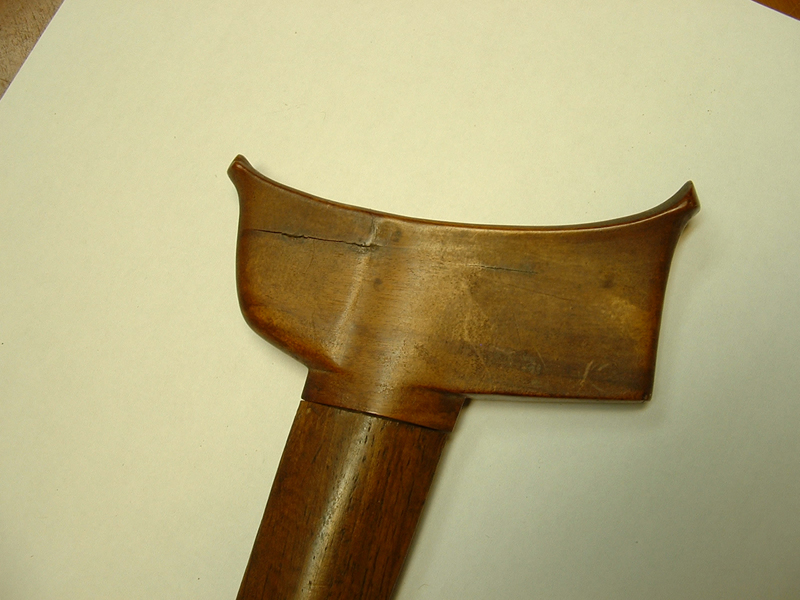

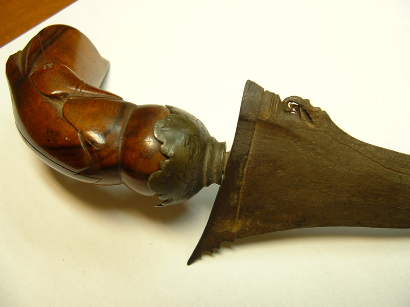

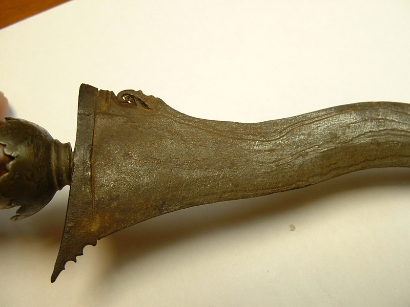

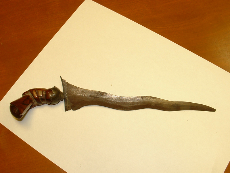

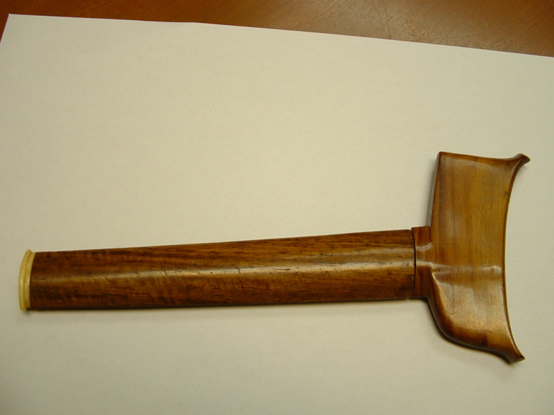

I am considering whether or not to clean up my recently acquired keris.
I'm sure many of you are aware of the TV program "Antiques Road Show",
and they always say don't clean or refinish old pieces because it will
greatly reduce the value and patina of a piece. This advice is most
often geared towards metal objects (guns, knives etc.) and wooden objects
such as furniture. Are there any major do's and dont's in this regard?
I've also noticed that people regularly switch parts around such as the
hilt. Isn't it better to keep the piece in original condition?

It is with great care and consideration, and after reading all the
responses, that I have decided to clean the blade only and let the rest
of it grow old gracefully. I like to think of the slight dirt on the
hilt, which has a greyish appearance, not as mere dirt but as grey hair
on a well traveled, old wise man, which (in my opinion) helps gives the
piece character.

Dave,
I think you should clean the dress of your keris so that the grey layer disappears. You certainly will not honour the maker and spirits by neglecting the house of the keris. If i come home i don't feel comfortable when the house is dirty with everwhere layers of dust. The spirits of the keris and the maker will think the same way.
Your grandfather? I don't know. If the dirt on the keris reminds you of your grandfather and i mean the fact that his hands touched that surface and you want to preserve that memory, fine.
But if you want to do justice to the keris, clean it!!

I do have to agree here. Dirt is not patina and cleaning the dirt from the dress will not destroy the patina, only enhance it.
Personally i would use some wood oil to clean it up and keep the wood from drying out. This will help preserve the dress and prevent further cracking. I also use a bit of Butcher's Wax as a protection for the surface afterwards. Gives the wood a nice low luster look as well.

Arjan, of course overly aggressive cleaning can eliminate patina. We must be careful and thoughtful. However i would never encourage someone to leave active rust on a keris blade nor dirt on the blade or dress as these are not patina and can be removed without damaging patina. Of course keris blades for the most part are intended to be maintained and stained to bring out their pamor patterns so i don't think that you can apply the rules of care for, say a mandau to that of a keris. It's apples and oranges really.
As for not having seen the blade yet, this is not so. We all had a chance to look and comment on Dave's new acquisition in this thread:
http://www.vikingsword.com/vb/showthread.php?t=13136
And it is really difficult to do much damage with 0000 steel wool. It will not leave scratches on your blade no matter how hard you try, though i suppose that with some effort it might remove the patina from wood.

I don't think that the opinions here are as diverse as they might appear. No one would suggest that you aggressively refinish this keris. There are degrees of cleaning. IMO removing dirt and oiling the wood of your sheath and hilt is not going to make your keris look any less aged. Likewise removing dirt and rust from your blade and oiling it will not make it look less old, just less rusty. And active rust is a destructive force and will over time eat into the metal of your blade cause irreparable damage to the blade.
All this work can easily be done without any loss to patina.

David, as I said at the beginning of my post, I was giving an opinion, not providing advice.
If I were to provide advice, it would be more or less in line with the advice that has already been given:-
glue the scabbard together, use a good furniture oil to to clean it, I prefer Sheraton, then a good furniture wax, clean the hilt the same way, lightly clean the pendongkok, do a complete clean and stain of the blade.
If it were mine, that's what I'd do with it, and for a segment of the keris market this would also maximise value.

I have not recommended staining or even re-gluing the sheath, two things that i would probably do with this keris were it in my hands.
