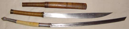

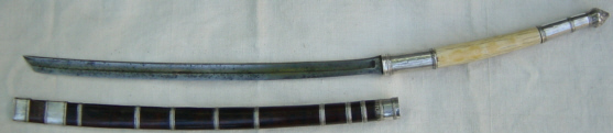

While enjoying a brewed elixir, I was rather stupidly perusing ebay and ended up with this. This sort of behaviour is out of character, the ebay part is anyway. It does have some damage but not unexceptable for the money or too my surprise its age. The tip is fine and purposely fashioned. It handles beautifully what practitioners would call a fast weapon. I like the ivory grip but I do not really know a lot about it. Can I join the dhamented, please Tim
Old 10th October 2005, 12:58 PM   #2
Posts: 5,992
Marks I have just found, has anybody seen the same ones?

Hi Tim
That is a rather nice dha you picked up It shows very nice workmanship on the hilt and the blade is old. I can't quite place what tribe it came from. The point throws me a bit? Mark this is one for you to figure out. I leave this up to the experts.

Nice sword, Tim. Congratulations!
I've never seen that blade marking before, so I can't help you there. As for the origin, I believe this is in the Thai style (we're revisiting the rough typology we started a few years ago, and the tribal nomenclature is less helpful.). The handle/blade proportions and the stylized lotus-bud pommel make me think this, although these features do appear on swords from other areas in the region (long handles often apear on Laotian swords, and variations of the pommel appear on Burmese swords as well). I'll let Mark address this more definitively, as he's really doing the heavy lifting in our research.
Age is a tough one, particularly from photos. This thing looks pretty old, but in nice condition. I'd say late 19th/early 20th century. It may be older.
The blade is nice, and that broad central fuller is not rare on Thai swords. The blade tip is interesting, and it looks like the fuller extends all the way to the end? Any chance you could post a close-up of that feature?

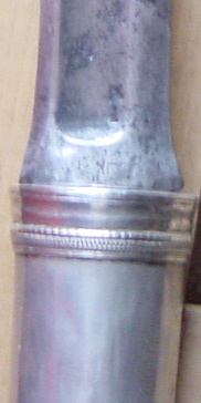

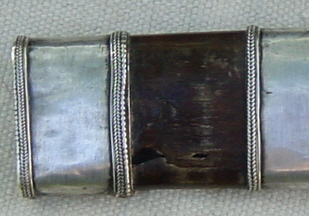

Posts: 5,992
I hope these help. The seller said it was from Malay. The pictures show where the sword ends inside the scabbard, just short of the peg in the scabbard, pegs have been discussed before. Thanks for the help, I was very worried I had bought a pig and a poke while waiting for it to arrive. Tim

Curiouser and curiouser.
Other than claiming a Malay origin, did the seller provide any provenance? I'm unaware of any sword of this form originating from a Malay culture, but it's possible this traveled down through the peninsula on its way to you.
I think this blade has been shortened, but I'm far from certain. I've got a few dha with squared or convex tips that have a wide fuller extending through the tip. However, your scabbard is a bit long for the blade, and I think I detect a slight upcurve to the bottom edge of the fuller which might have indicated the beginning of fuller "resolution" if the blade were originally longer.
I think Mark may have a sword with a very similar blade.
The peg might have been placed to repair the scabbard (do I see a crack in the wood?). I've never seen a dha of this length and a chape cap with such a peg. When I have seen them, they usually appear on knife-sized weapons, or occasionally on newer, lower quality swords. This is not one of those.

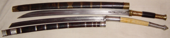

I have to join with the others in saying what a great find that is. I have seen similar hilts but never have seen that tip style or makers mark either. Its a shame Dan is not still in Thailand to find out about the mark. I have seen several dha now with the longer handles with a more dramatic curve. Andrew is the evidence now that this is mostly Laotian ?
The only one I own that is similar is this one
Again congratulations on the find and beware dha are addictive. I am sure the surgeon general will soon require warning labels on them.

Hi JT. I still favor Thai for Tim's example. Probably Ratankosin, according to Mark. A similar one appears as #4 in the second photo in this post about an Oldman Catalog:
http://www.vikingsword.com/vb/showpo...97&postcount=2

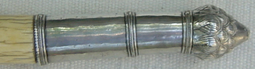

I take it I am in then, you will let me know the password or secret knock . This is a drawing of the mark but it might not be a good strike, looking from the handle at the bottom of the drawing using a +10 loop. I do not know if it helps. I thank you all for the reassuring comments as although not a complete stab in the dark I was a little concerned that I had spent a touch more than usual. Tim

Originally Posted by Mark Bowditch
I am going to go against the tide of opinion and say that it is Burman (as in the tribe after which Burma is named). The wide fuller and floral lotus pommel say Burma to me. Compare it to this one, which I am certain is Burman based on the presence of koftgari (plus the Burmese script is a dead give-away ).
Hi Mark.
Notice I hedged my bets on the pommel?
Have we seen many Burman swords with handles of this length? I know this is not a "cast in stone" feature, but lotus-bud pommels do appear on Thai swords as well, and if the handle was shorter and three-sectioned like your example, you'd have complete agreement from me. Perhaps an example of cross-polination?
The struck marks at the forte are interesting. I suspect a smith's mark (no great guess).
