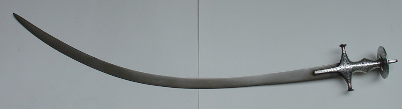

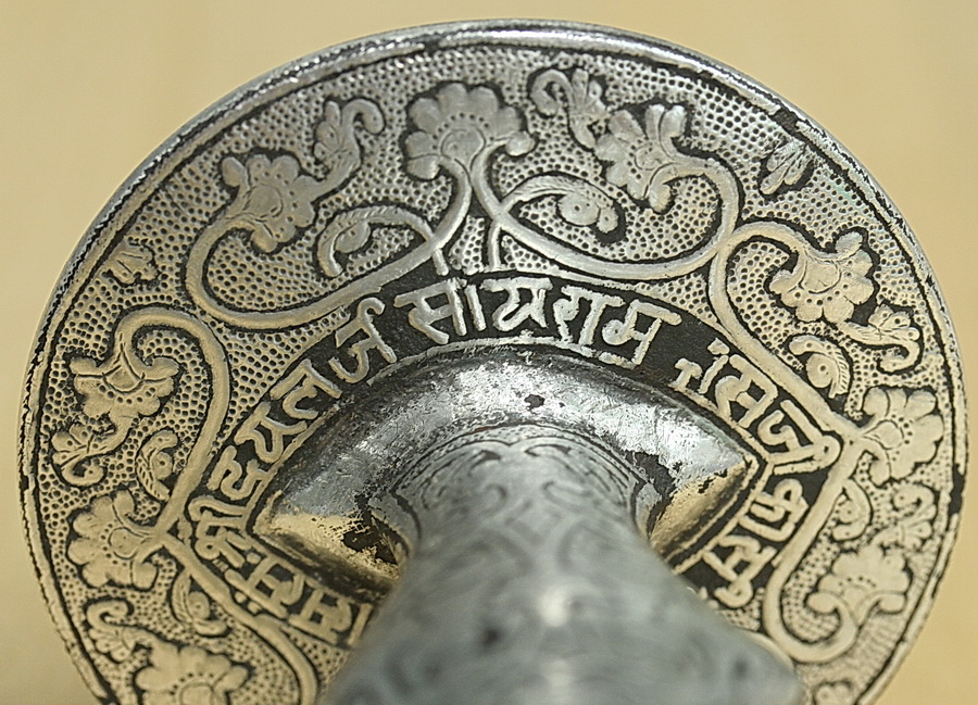

Not so long ago I got this tulwar, but I need the text translated, can anyone tell me in which language it is and what it says?

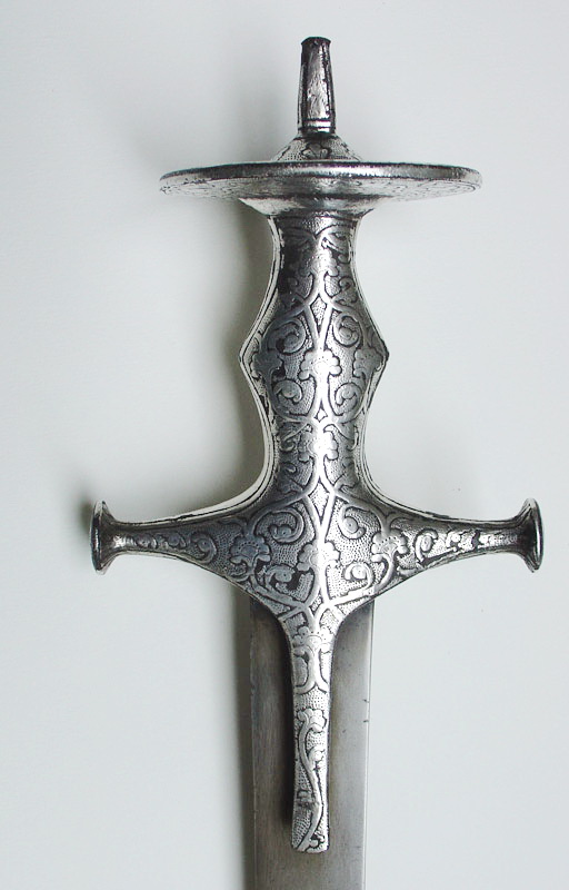

Nice Udaipuri hilted tulwar!!! Wouldnt this be Devanagari script ? Where is Olikara??

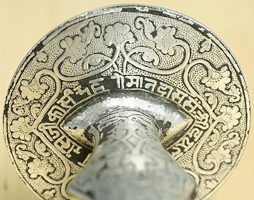

The legible half reads as:
'Shri Dayal (Ji) Sairam (Das) Ji' which could be a name of the sword maker or owner. Dayal is a common North Indian Surname. While Sairam is actually the name of a God but also used as names of countless Hindus all over.
Since the koftgari in the second half has peeled off I cannot connect the words and so any translation would be meaningless.

There you are!!! I was hoping the UFO's didnt get ya. Thank you for adding that translation. It seems pretty unusual to see inscriptions on these, but Jens always comes up with these unique examples.

Nidhin, thank you for the translation, and Jim, I am a bit uncomfortable with the Udaipur expression, as none of us can be quite sure from where exactly it origins. I would feel better to say that it is Mewar/Rajput till we know more about it's origin.
It is however a fact, that these hilts are seen on variations from very slim, to slim, to 'normal' and to rather thick. This could be an indication of origin, but it could also be an indication of fashion - an interesting thing to research.
Jens

Thank you Jens, and of course you are right, when trying to think of the somewhat vague attempts at typology in Pant, it becomes more apparant that distinctly classifying these hilts is at this point not likely. As you know the same diamond grip feature and the extended and squared langets rather than flueret is termed 'Udaipuri' on one page and with similar features, "Shah Jahani' on another.
As there is, as far as I know, no formal study of classification of tulwar hilts aside from Pant's benchmark work, it is often tempting to reach for his ambiguous classifications to condense descriptions. It is probably of course more reliable to rely on the more detailed description than to attempt such arbitrary classification.
As you note, and we have discussed many times, there is truly a great deal of work yet to be done in understanding the styles and variations of these hilts.
All best regards,

Very nice tulwar, Jens
Do you have an approximate date for it?

It is probably late 18th to first half of 19th century - but it is one of the things I intend to research when I get some more time.
