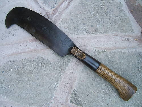

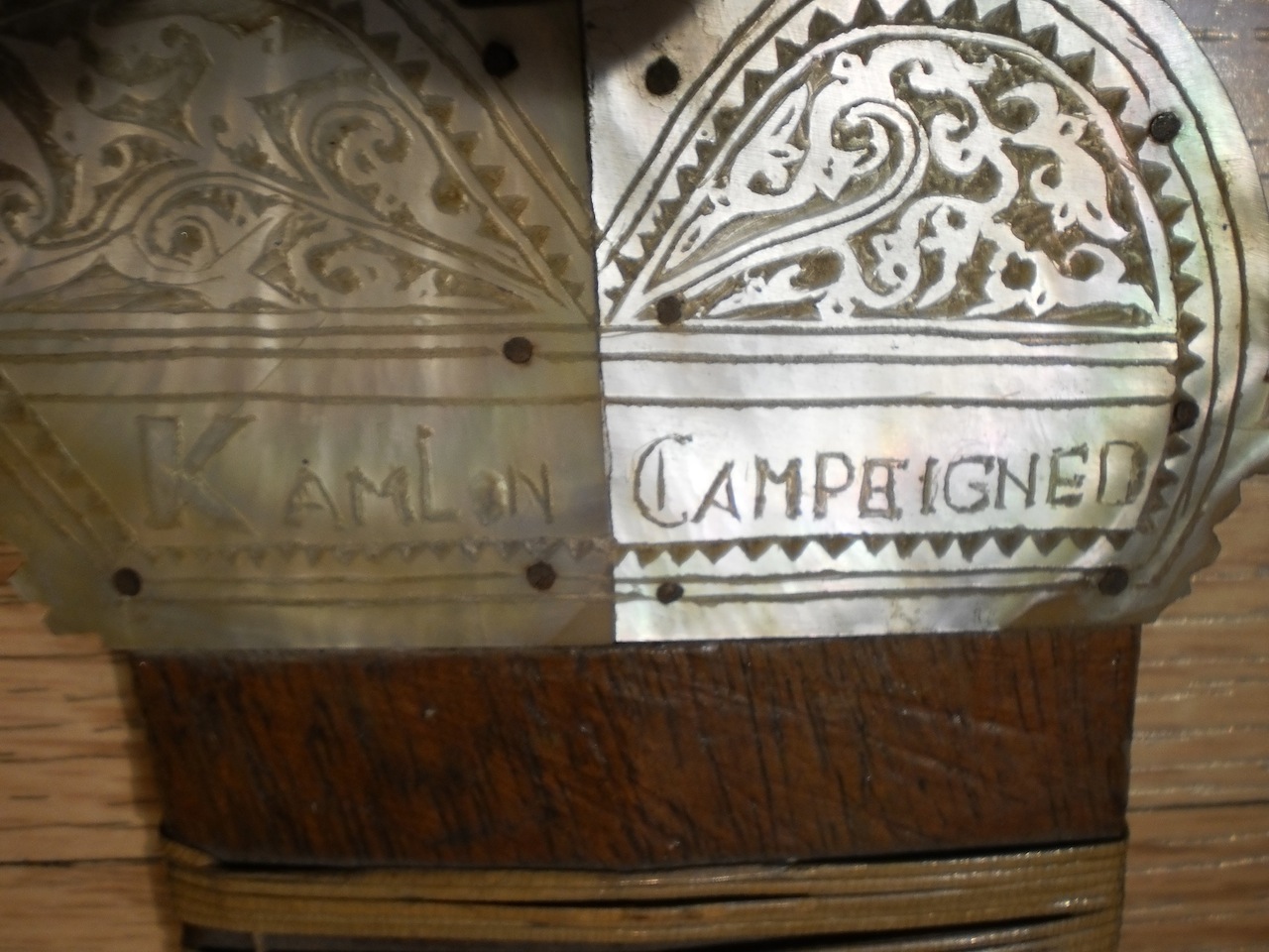

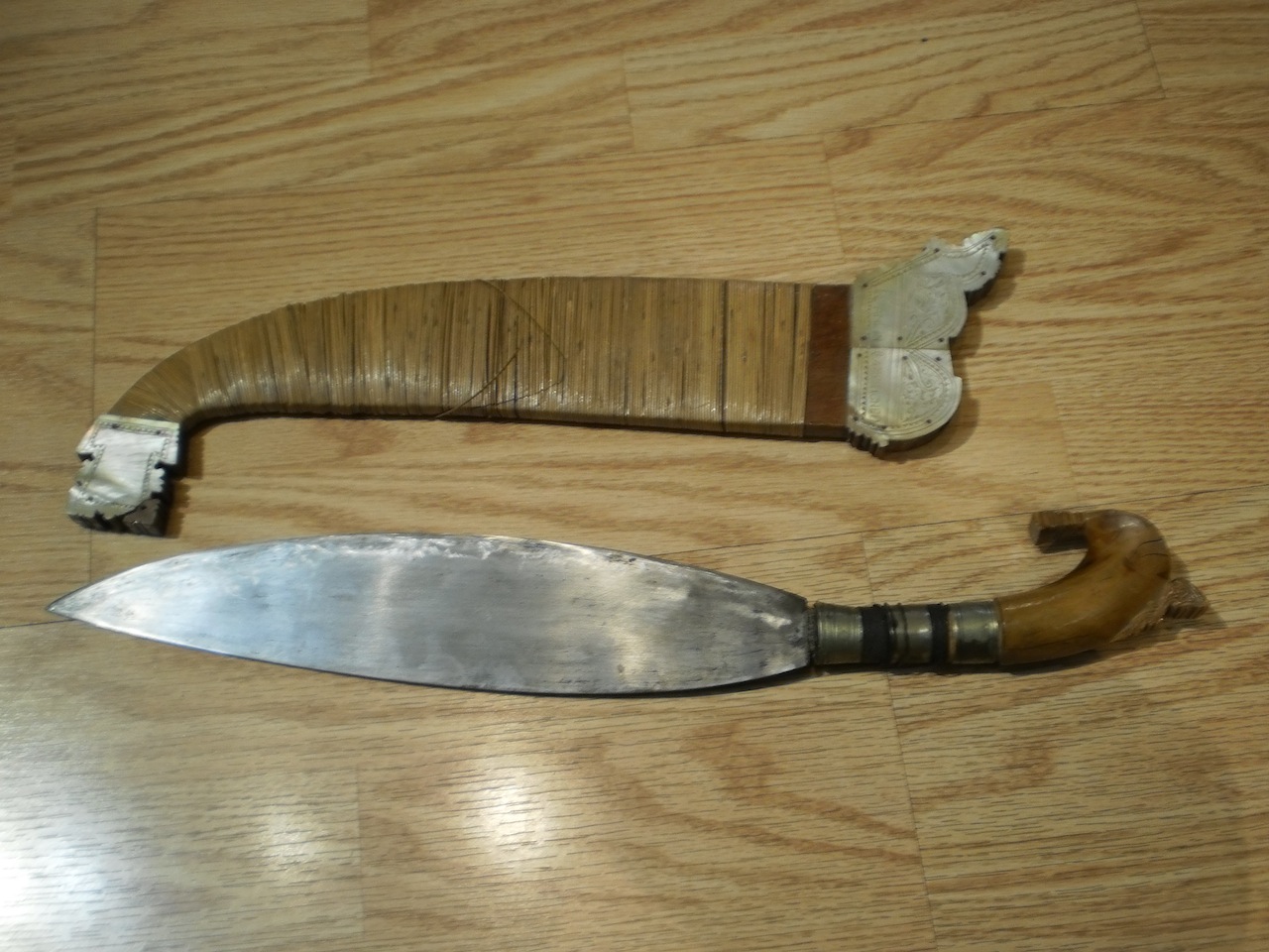

I found this at a flea market near me. I'd like to know what everybody thinks. The blade has a really nice distal Taper. I would like to clean it up enough that I can see if it has an inserted edge, so I'm probably going to use very fine crocus cloth to polish it up. The handle is totally loose, and I'm not sure what to glue it back in with. The scabbard is marked “Kamlon Campaigned".
Any ideas?

Looks like it is a tourist piece to me. If it is you can just crazy/gorilla glue it.

Real. Kamlon was Jikiri's version in the mid 1900's. A distant relative of mine fought in that campaign...

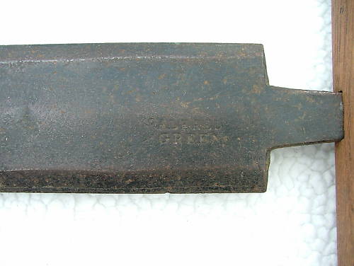

Hello Montino Bourbon, If you could, please post a close-ups of the hilt and blade. Could you also tell me how thick the blade is at the hilt? There is the possibility that it could be a good blade with a poor quality replacement hilt.
Robert
Old 19th December 2010, 08:20 PM   #5
Montino Bourbon
Montino Bourbon's Avatar
Posts: 301
The Blade is one quarter of an inch thick at the hilt. Is it worth cleaning up? Would I use fine crocus cloth or some other thing to polish up the blade?

I agree with Spunjer. I would go ahead and clean it up and give it an etch just to see what happens.

So nice to know that this has a chance of being real, especially since I picked it up at a flea market nearby from some gentlemen who didn't have the faintest idea what it was, and wanted to sell me some brass daggers from Spain that are real tourist pieces at about twice as much as what this cost me. What would you clean it up with? Or can you please direct me to a thread that would tell me how I would go about the process?

Thank you so much; I started cleaning it up now. There are, unfortunately, some pretty deep scratches near the edge where it was probably put on a grinding stone. I'll do my best to take them out.

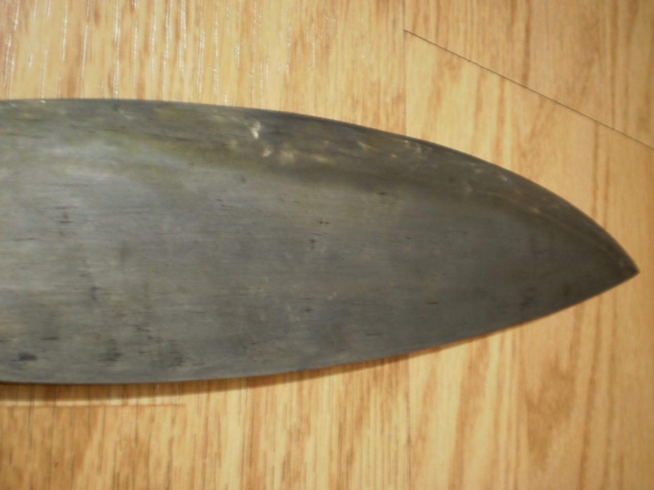

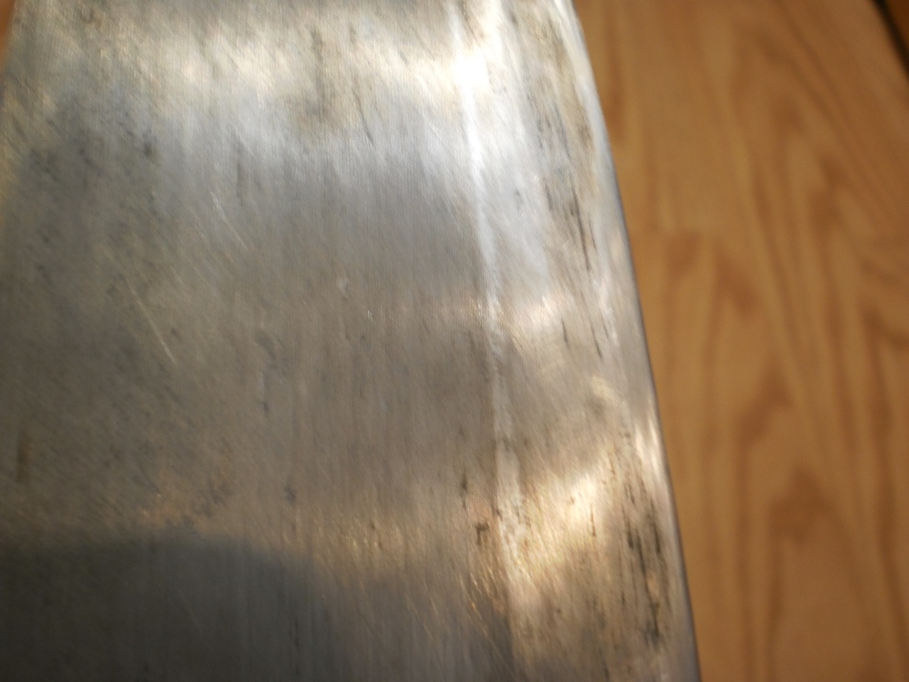

so I went ahead with 600 grit, followed by 1000 grit for the edge, then edged it with vinegar. Result; nothing.
I then tried again with ferric chloride diluted 4 to 1, and behold! Either a temper line, or an inserted edge, I'm not sure which, but it's very very clear.
Opinions, please?

Looks like an inserted hardened edge to me.
Robert

does this mean that it's a better than average blade? Is an inserted edge normal? Is it usually found on tourist pieces? Please excuse my excitement. When I find something at the flea market for less than the price of dinner for one at a restaurant, and it turns out to be something decent, I'm always turned on. Thank you so much for your input and your knowledge.
Oh, and I almost forgot; what would I use to secure the blade in the handle?

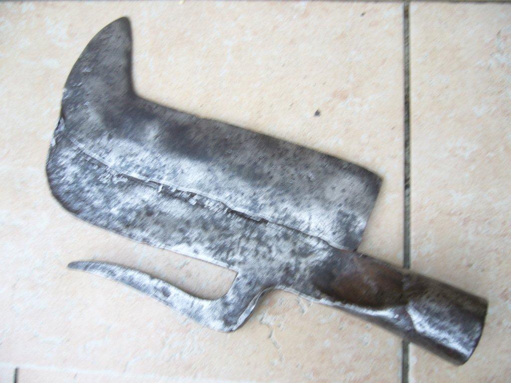

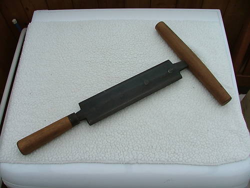

Ref insrted edge - you guys must be sick to death of me going on about edge tools, but here is another instance of tool making technology that can apply to making swords and other weapons....
English scythe makers forge welded a sandwich of high carbon steel with a mild steel back between two pieces of wrought iron. This minimised the use of the more expensive carbon steel, gave a tough flexible body to the blade and protected the carbon stel during hardeneing and tempering. This technology continued up to the 1940's in Sheffield, and the 1960's in Belbroughton.
See http://www.youtube.com/watch?v=AqV3jtkQSe4 for the Clay Wheel Forge in Sheffield - a similar DVD/video of the Nash Works can be obtained from the Belbroughton History Society....
Other makers such as Elwell used their own rolled 'sandwich' and even offered it for sale to other edge tool makers..
Billhook makers also used the same methods in both France and the UK, although more commonly a high carbon steel was face welded to a softer body, giving a very pronounced weld line... Axe makers tended to insert a steel bit into the body, a method also used in the vineyard hoes of Bernard Solon (Maison Alexis) in Orléans, France
http://philippebachelier.com/Portfol...rtraits06.html or http://dytic.over-blog.com/article-d...-59608149.html there is an article in a french blacksmiths' magazine showing the stages in the manufacture - I do not have the web-link handy, but he won the annual prize for his work a few years ago...
The weld line clearly shows in the edge of the currier's knife made by Alfred Green (UK) and the difference in patination on the William Swift (UK) billhook, and very clear on the French billhook blade..

Hello Montino Bourbon, While I cannot say that it is a better than average blade, I will say that if it was made just for "those who travel" I can not see the person who made it going to the trouble of putting a hardened edge in the blade but this is just MHO. I have been waiting for those who are far more knowledgeable on these to join in on this discussion. As far as what to use to reattach the blade to the hilt, I would use pitch.
