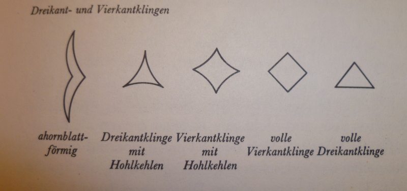

Hi Guys,
How would you describe this crosscut?
It has a high ridge on one side, with hollowed facets, and a "negative" valley on the other.
I have always used the term "foliate", since it seems akin to a leaf, but I wonder if there's a more precise denomination.

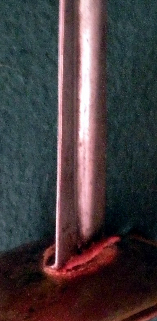

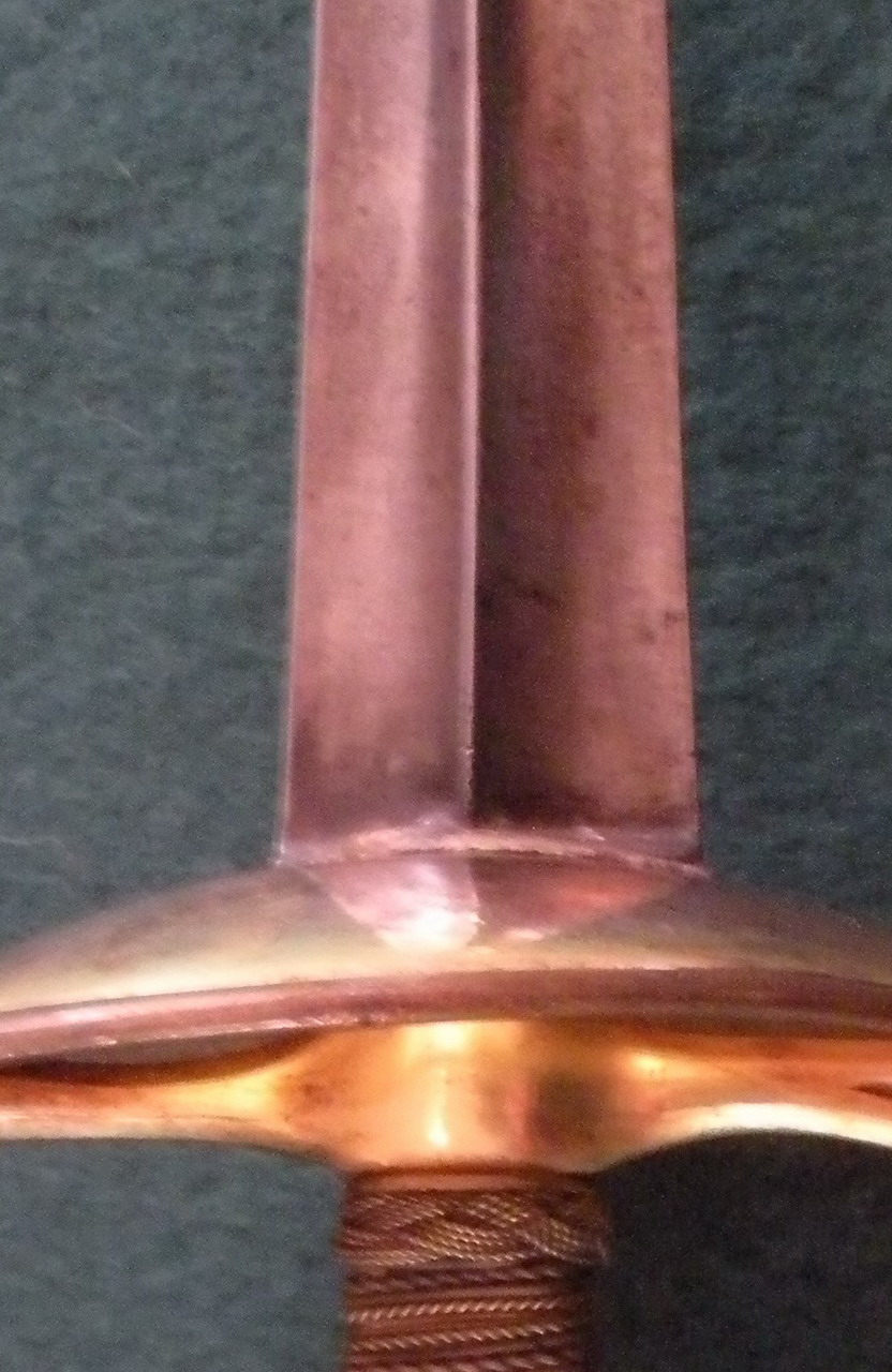

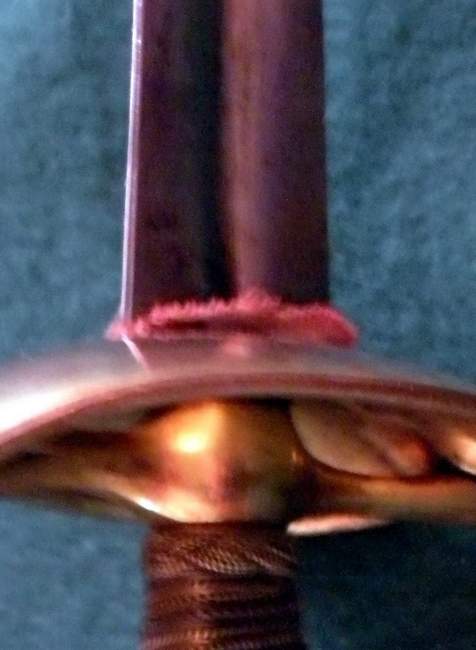

Better photos recently taken. Note that the reverse face is actually a valley made by the two mesas/tables/sides of the anverse. Not the typical third face of a pyramidal blade. The effect is very elegant, almost dainty, yet the 3 cm wide blade (at ricasso) is very robust.

I would say i have already seen this type of cross section, in a much smaller scale; in fact the short blade of a sword cane i had.
If we were talking graphics, this would be a circumflex accent cross section
Go figure what would they call this profile sword wise .

Aylward ("The Smallsword in England", 1945, p.38) notes in a paragraph on 'triple edge blades'.....
"...it is customary to refer to the typical blades of the 18th century as 'triangular', but the term is not quite as accurate as might be wished. In section, the broader side of these blades shows a slightly curved base line from the center of which rises a median spine joined to the extremities of the base line by arcs; in consequence we have a blade which is, in fact, a triple edged one, and the design has come so near to perfection as far as a purely thrusting weapon is concerned that even army bayonets were made in this manner up to a comparitively recent period."
On the next page he notes that these triple edged blades were called 'hollow' blades by those who made them.

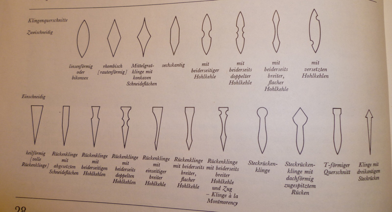

This kind of crosscut is called ahorn leaf, in europeische hieb und stiechwaffen by Mueller and Koenig
Best regards

Danke Schoen, freund!
At last, proper terminology.
See Nando? _Leaf_, like in "foliate", 'member?
I was right, you were wrong Nah, Nah, Nah, Nah
Best
(Der) M (eister)

herewith also some other cross blade shapes
best,
best,
Thank you so much for that, Cornelis; a good thing to save to our records
Pity is not (also) in english ... not to mention portuguese
