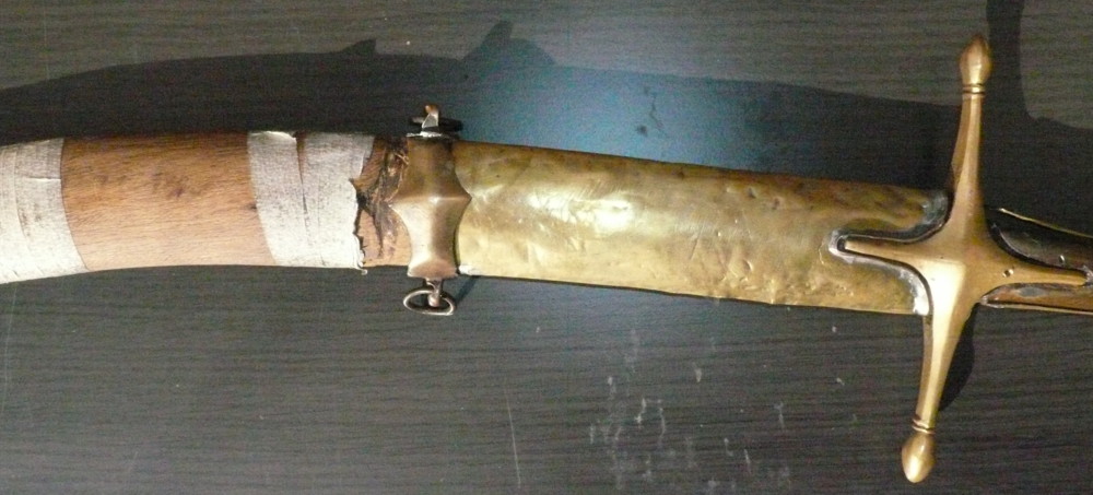

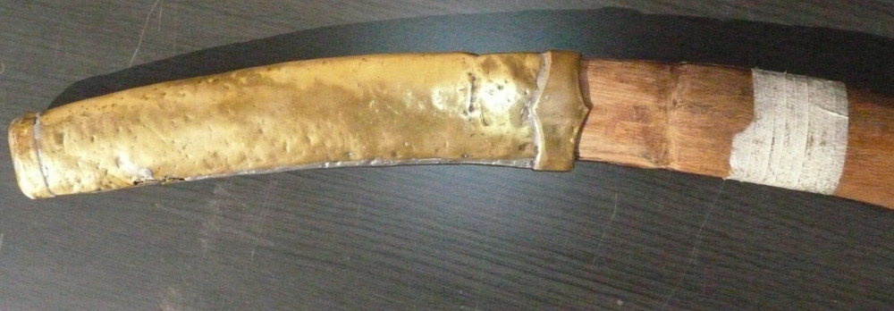

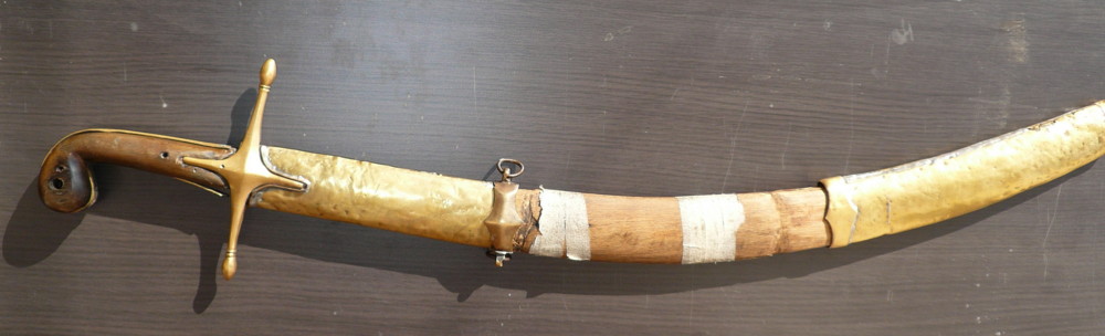

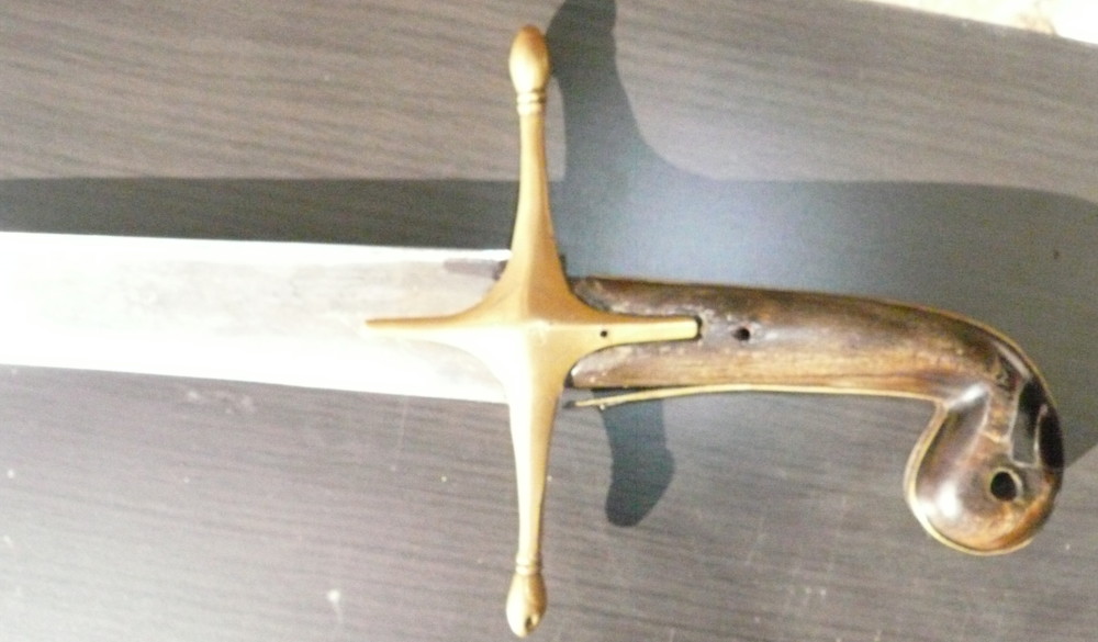

Here is the Pala at the start.As you see the scabbard and the qillions are in bad condition.The only parts that I have kept are the woods at the scabbard,
the horn plates at the grip,the side strap at the grip and of course the blade.

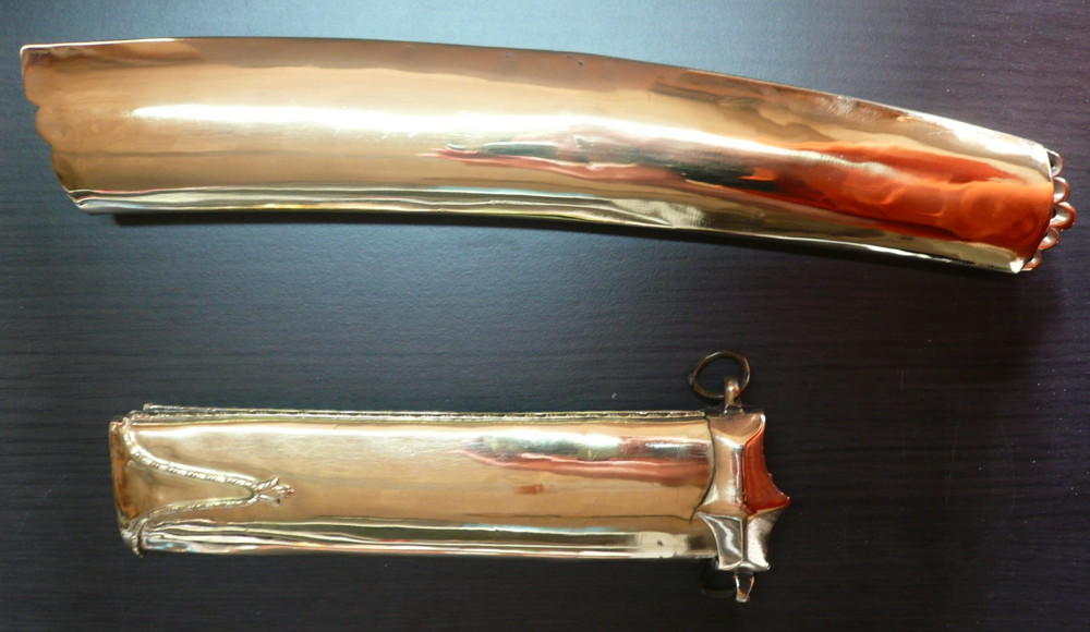

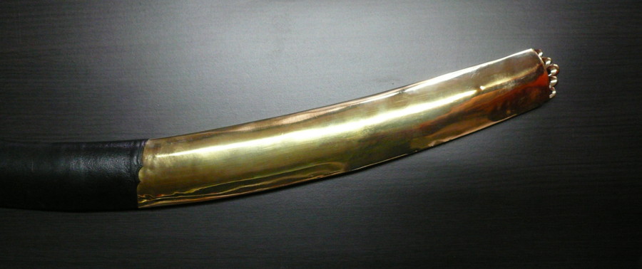

Here the new scabbard parts that I have made .The friend of mine didnt want any patination at them so they are shine enough.
libra is offline   Reply With Quote

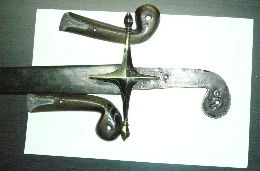

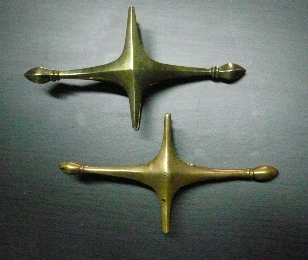

The new quillions and the old one

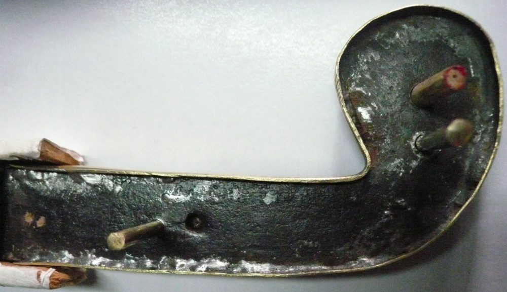

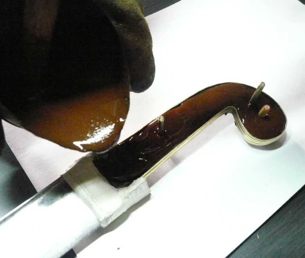

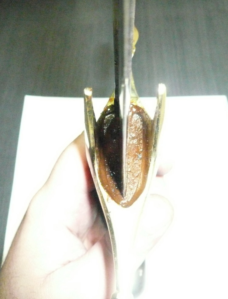

Here i fill the space beetwen the grip plates with a mix of resin,sealing wax,brik dust and plaster.

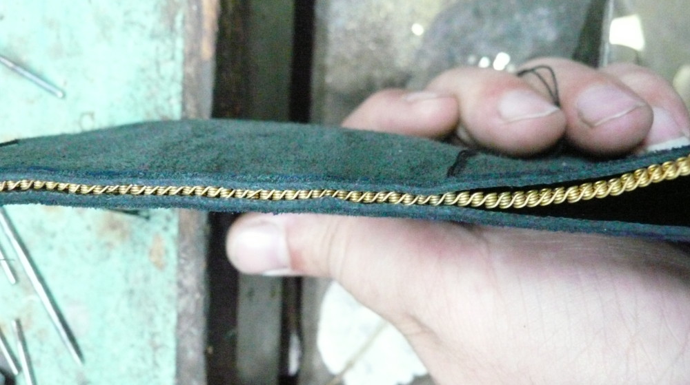

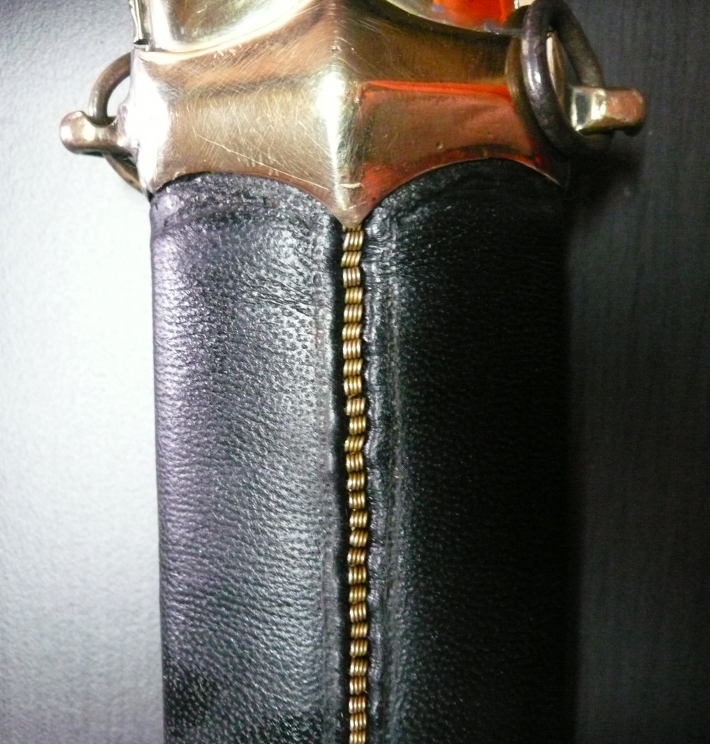

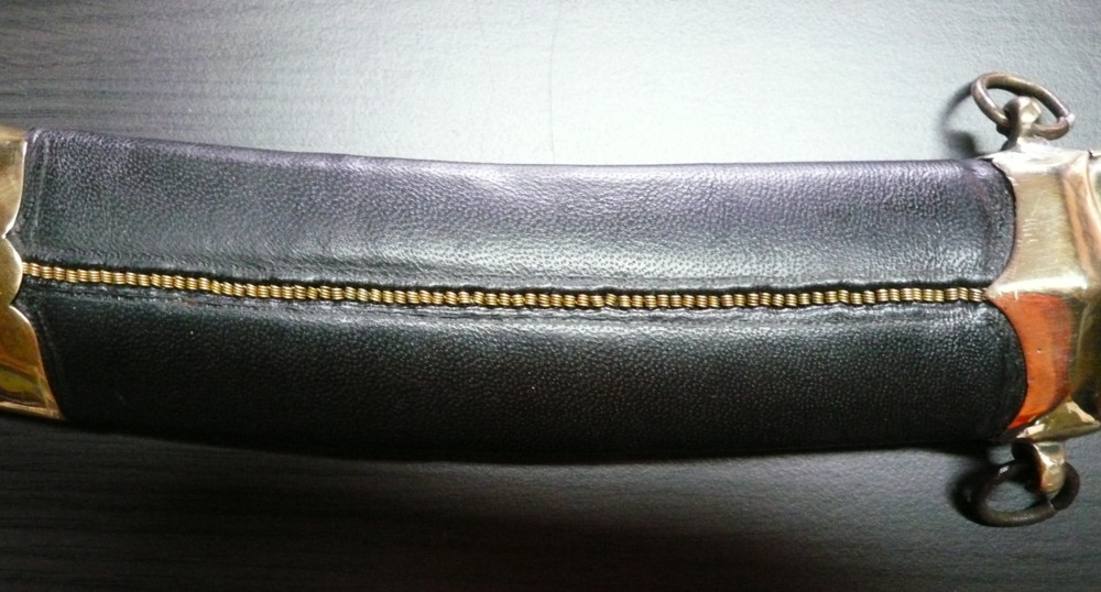

Here I stich the leather with the brass wire.

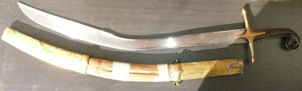

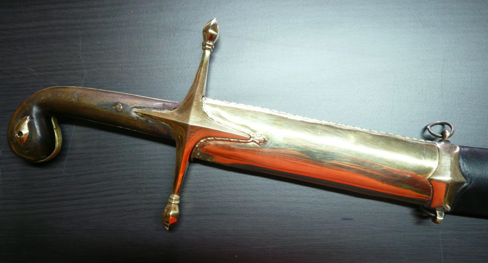

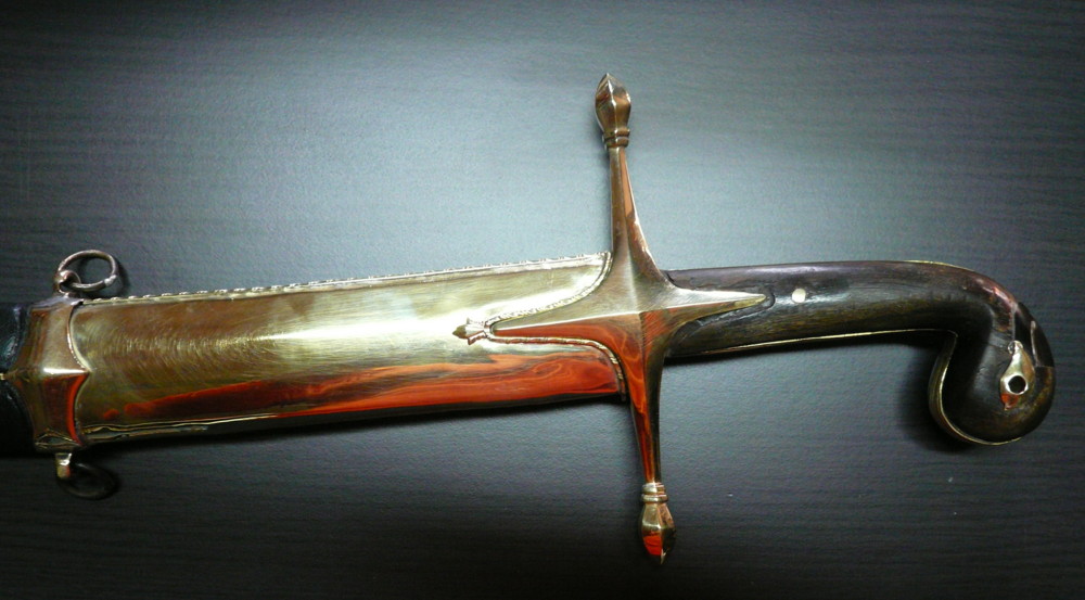

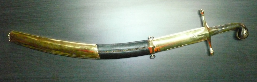

And now the sword with all the parts together.
ENJOY!!!
All the best
Aristeidis

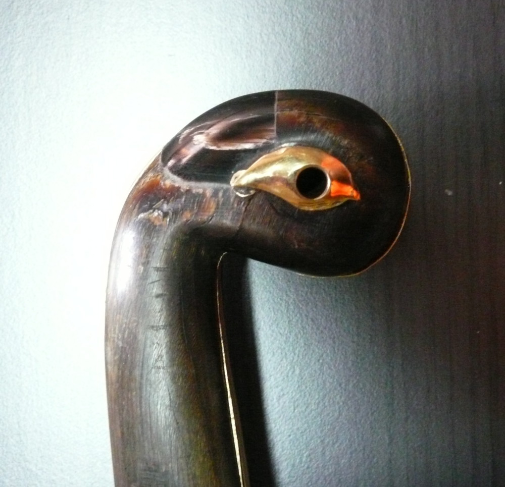

The last three

Could you please give more informations about :
- the sewing of the leather with the brass wire
- the making of the brass wire
- the making of the brass embellishments (repousse ?)
Very nice work !

The brass embellishments it isn't repousse is massive brass. I have soldered on the brass plate and I engrave it.
The wire I make it first round spring then I open it and I sewing on the leather as you see at the photo!
I hope these to help!

Beautiful sword and good work, but I am one of these collectors who feel that much replacement of the original parts was excessive. The original scabbard chape and mouth and crossguard appear to have been in decent shape and I would not have replaced them. Now basically you have a nice old blade in a replica scabbard.

Can you provide more detailed information on the preparation and heating of the sealing mix?

Delor the sealing composition I find it my self afterwards from a lot of failures!
We have seen that a lot of swords have something like this,the main
component is resin.
The only report that we have is from Robert Elgood's book THE ARMS OF GREECE.
Ariel
I dont have exact quantities of the materials that I use because I make it through my experience.Several times I start with small quantities of each material and judging the result an then I add parts from the material that I believe that is missing.So it is more due to my experince than a standar recipe.
You heat the recin on the fire and you put first the brik dust then the sealing wax(red)!
When become all homogeneous you put the plaster and you mix them!
As more plaster you put you make the mix more stroger!

Thanks for the " recipe". I am also intrigued by the crossguard: did you put a newly-cast one instead of the original? Do you actually cast them yourself? Are they for sale?

Hi Ariel.
Yes we have putted a new one at this restoration because the old one was at bad condition.
We have made it from the start.First we have carved it at casting wax and then we made the casting.We can produce crossguards also with patination but at this one our friend wanted to be ''shine'' enough.
We will be glad to sell at any forum member who wants crossguards.
Also we can produce any desing that you desire and any type of crossguards.

Also, how do you heat the mix? In boiling water or straight on fire? Doesn't it catch fire?

I heat the mix at a metal bowl on fire.But be careful because it catch fire if you boil it.It must be melted not boiled.

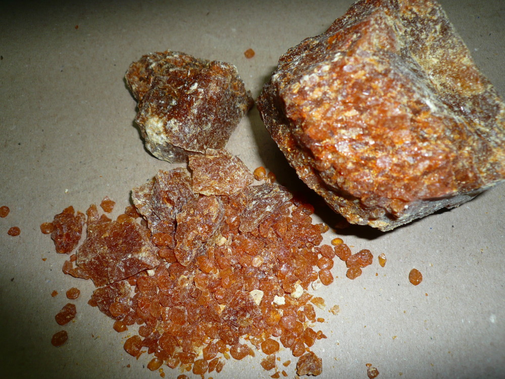

Hi Aristeidis,

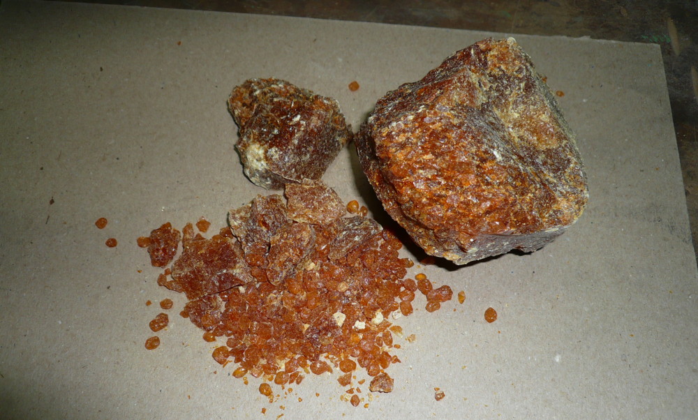

are you using the same king of resin as for art painting (gutte, dammar, copal...) ?
The gutte resin (Cambodgian "garcina morella") color reminds me the color of some ancient oriental sword sealings, but copal resin, which is from India would be more geographically accurate. What do you think ?
delor is offline   Reply With Quote
Old 17th December 2010, 08:20 AM   #22
libra
Join Date: Jan 2009
Location: GREECE Patras
Posts: 40
Hi Delor
I don't now exactly what type of resin is.
Here we buy it from the shop as simple resin with no special name
But i beleive it is copal!!
I hope those two photos help you more!!
All the best
Aristeidis
Old 18th December 2010, 12:25 PM   #23
delor
Location: Marseille - France
Posts: 73
Thank you Aristeidis !
This resin is surprisingly red. It looks like myrrh, but is probably not (unless you by it from a monastery !). Might be from some local tree. Thanks anyway.
