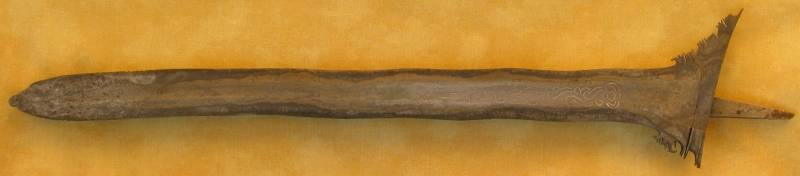

This Moro kris was sold by a Portugese family from California. It's supposed to have been "obtained" during the Spanish-American war but there are no details since the persons who may have heard the story first-hand are long dead. Actually, the poor blade must have spend considerable time "in storage" - there's some damage to the tip (maybe partly "original"?).

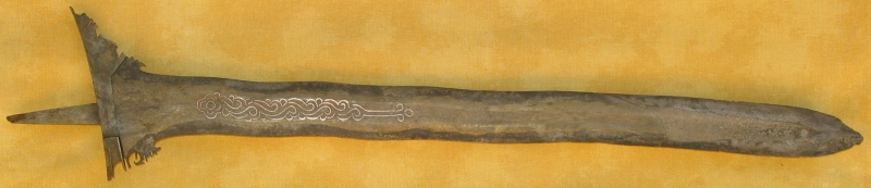

The half-waved blade is of the Mindanao "crossover" type (sensu Cato); the 7 luks are pretty subdued. It has a deeply forged fuller along the full length which makes it feel light for its size (length 549 mm/21.6" + 65 mm/2.6" tang; width 41.5 mm/1.6" and thickness 5 mm at base of blade; gangya spread 128.5 mm/5.1" and 12.2 mm/0.48" thick; weight 477 g). The utilized steels, the inner core and the outer layers, seem to be both pattern welded. The asang-asang is forged of iron - this integral type extends below the hilt till the end of the grip. The kakatua hilt carved from banati wood still has a silver band at the base but any wrapped twine (or braided wire) is long gone. I suppose this is a datu piece mainly based on the elaborate silver inlay which would be inappropriate for any Moro of lower status AFAIK. I guess this could originate from Maguindanao (i. e. a Luma) since the silver band is plain and I'd expect a far more elaborately embellished hilt if it were of Maranao origin. (No original scabbard to glean additional information from.)
The following pics show the blade after rust removal by pineapple juice. Most of the blade is in good condition (some pitting at the tip though) but quite rough which tends to obscure the nice lamination pattern, especially towards the tip. Would it be advisable to (moderately) repolish it by hand followed by a final etching to restore the original appearance of this Moro blade?
Any and all comments appreciated!

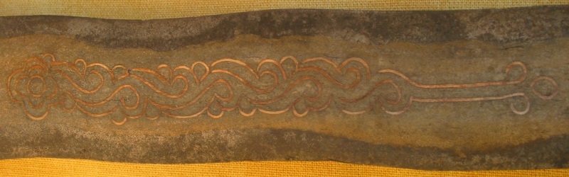

right side...
Old 20th September 2005, 11:05 PM   #3

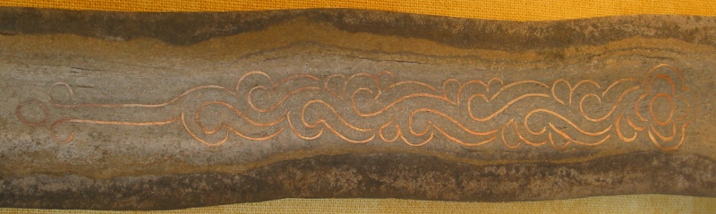

Default Gangya
left side...

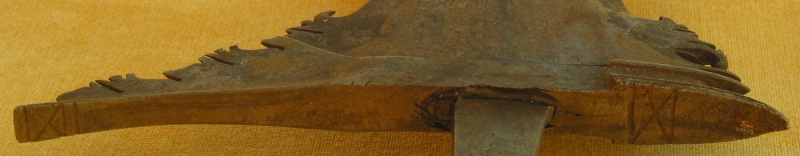

Old 20th September 2005, 11:08 PM   #4
Left side of blade...

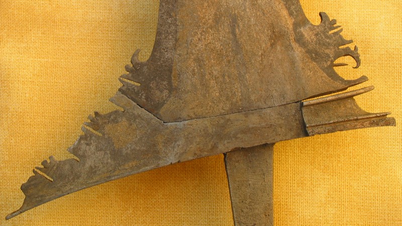

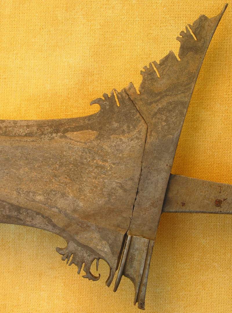

Old 22nd September 2005, 12:21 AM   #5
Question markings on gangya
I have seen similar features on keris melayu - a shared (though rare) theme?

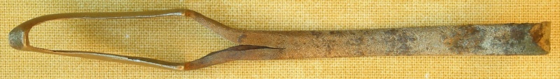

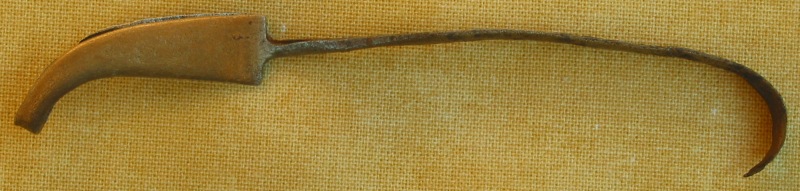

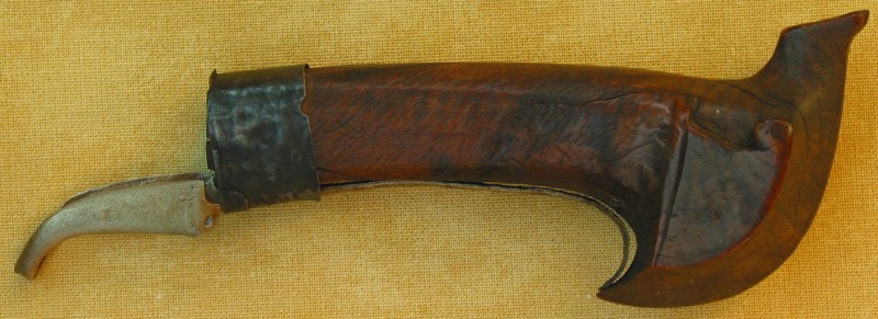

Default Hilt ...
... in original condition (asang-asang already cleaned).
Old 22nd September 2005, 12:35 AM   #7
Asang-asang forged from a single piece of iron.

Kai, what is really nice about this puppy is that you have the silver inlay intact. A rare thing indeed. Regarding restoration, you may want to consider wrapping the hilt below the pommel in silver okir bands. I would take a little time to polish the silver inlay. If you want, you can email me on other matters of restoration, or if you want me to do any of it. Would take too long to exlain everything on this posting and not sure if this is the proper place to do it. You are right in that this is a datu piece.

nice old kris. the pictures make it hard to tell the real condition. even hand poishing with light abrasive compond may pull up rust deteriorated metal particles that might scratch the inlay, if your not carefull. You might try buying a soft cotton mop, put the handle in a vise, so that the strings hang freely. streak one side with a fine abasive compond and the other with final polish. Componds contain silica and should not be inhaled, wear leather gloves so you don't cut yourself. if you keep changing where you insert the sword into the mop head, you are less likely to cause scratches; the tips of the mop can be used for working certain areas. Good Luck, post some pics when you are done.

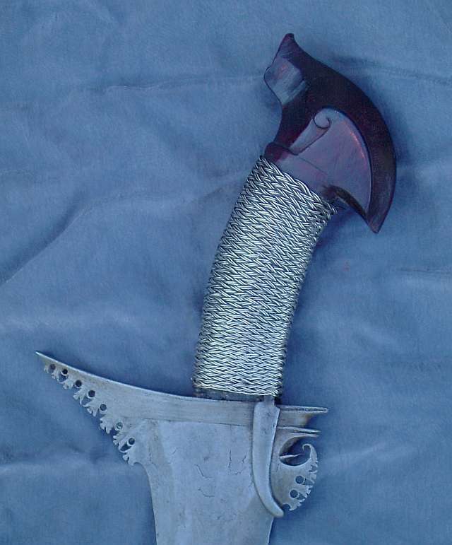

Posts: 6,441
Hello Kai , here is one example of fairly simple silver braiding .
As for increasing your images to 150dpi wouldn't this adversely affect the dimensions of the images you can upload ?

The problem I have always had with inlay and restoring kris has been in the etching vs the polishing. The acid can seep underneath the inlay and loosen it, or it can eat away at the thin inlay real fast vs its eat rate for steel. In certain cases, I have used a thin layer of clear nail polish to protect inlay or other fittings (such as asang-asang) when etching. High grit sandpaper (eg. 600, 800, 1000, 1500, 2000, 2500, etc...), is relatively gentle. You could always start at a higher grit. I would just personally avoid over-etching, or long soaks in acid, as it can add a topographical etch, that at least in what I have seen, has not been typical of Moro swords. The polishing compound idea, can work depending on the compound, but there is always a danger that some compounds contain a portective additive that can sometimes create more of a mess than theyre worth (eg. brasso). Jewelers red rouge is nice, and goes a long way. If the rust is isolated in spots, you could just use #0000 steel wool, a gentle hand, and some WD-40 (or other penetratin oil), to clean it off. Anyways, nice kris, and great inlay.
Kai, if you decide to send to Battara for restoration, you may want to think about adding a silver collar underneath the cockatua below, above the wrap.

Federico has a very good point on the over etching. Light etching to bring out pamor is fine and won't really affect the inlay. Over etching in the way he describes is for Javanese pieces, etc., and will pop out the inlay (thus I have not seen much in true inlay in Javanese pieces).

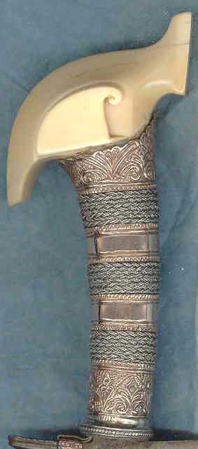

As promised, here is a Maguindanao kris I have that is closest to yours. The hilt has an ivory pommel, the bands are of okired swaasa over copper and braided twisted silver. The bottom band is silver.
Enjoy!
PS. (I also do installment plans ).
Thanks, Battara - that's a really nice hilt! How old is it approximately? Are those 2 central swaasa bands hexagonal?
Well, that's more difficult to cover up though...
Old 29th September 2005, 07:09 AM   #23
Posts: 7,417
Thanks. I'm pleased. The age of this puppy is I would guess around 1890s. The orange swaasa bands are round, they look hexoganal...well...because I used the poor man's camera - the church scanner.

Here's a link to a somewhat similar example: http://www.oriental-arms.com/item.php?id=1804
However, the inlay just reaches into the fuller (which is also less wide), whereas the fuller extends more towards the base in my blade so that the inlay is completely within the fuller.
