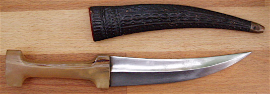

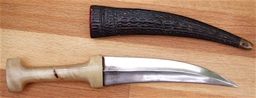

Hi,
Another local find. My apologies for all the questions but I'm a bit unsure of the facts. Small, the blade is 5 1/8th inches and the hilt is 3 5/8th inches, this seems pretty small with regard to the examples I've seen here and on Oriental Arms site. Wootz, the close up of the blade appears to show a pattern? Kurdish, nowhere can I find a match for the hilt material or exact shape, the scabbard would seem to conform to the Kurdish type. As usual your thoughts and expertise is sought. Many thanks.
Norman.

It is a nice piece but I can't make out any type of wootz pattern on the blade?

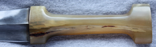

The hilt looks so far to be a type of white horn. Better close ups would be helpful. I agree in that it is Kurdish.

Norm, i definitely see the pattern you are seeing, but whether it is wootz or not i couldn't say. Obviously an etch will tell. Is this in your hands?
Norman.
Looks more like a multilaminated blade.

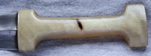

Close ups of hilt as requested.
Norman.

I had a similar knife but with a dark-coloured horn hilt.
It could be kurdish, but I think just as likely to be marsh arab. Also an Iraqi group.
I think fairly safe to say it is Iraq area.
Mine too had a wootz blade. A nice item. I'm sorry I sold it.
The scabbard on yours is quite striking. Very nice.

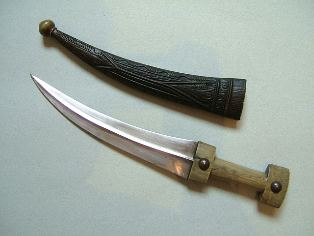

Originally Posted by Ron Anderson
Note, mine was identified very clearly as marsh arab and had the same shape hilt as yours.
Ron
This is not an Arab Marsh dagger is is most definately a Kurdish piece. Below is one from my collection Kurdish the other is an Arab Marsh dagger from Southern Iraq.

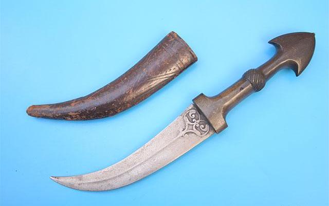

In an effort to keep this information in one place, rather than starting a new thread, I'll add to Normans.
Here is another small Kurdish Jambiya with a wootz blade. Don't know if the pictures are any good but here goes. The knife is 26.5cm overall length.
