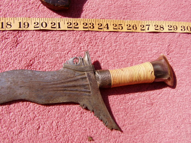

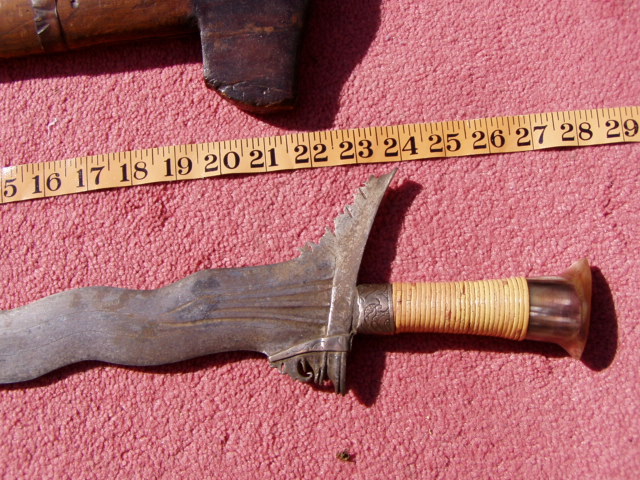

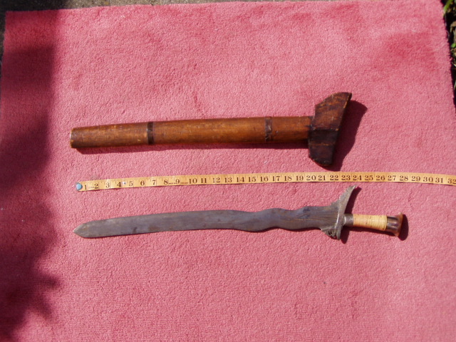

This belongs to a friend and I'm thinking about purchasing it from him. Unfortunately I know less about it than he does. I'm guessing it is 20th century (1920s-1940s) but really not sure. Grip is made of horn wrapped in a rattan binding. The rattan binding may or may not be original. Any comments about this keris are extremely welcome. I don't have any measurements other than the length, I will post the rest as soon as I get them. Thanks.

How thick is the blade of this *kris* where it meets the hilt Robert ?
Can you take a picture looking down on the handle ? How thick is the Baca baca (blade clamp) ; it looks pretty thin .
The file work looks pretty good .
Actually comparing the blade to the overhang of the ferrule in the pictures the blade looks kinda thin as does the baca baca.
The handle is round and flared at the end ?

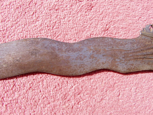

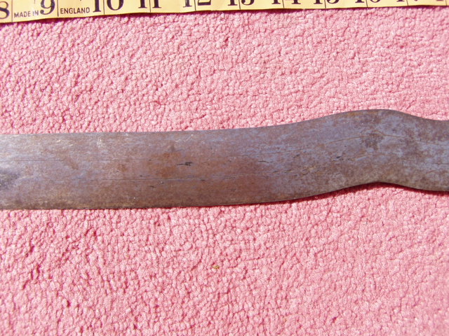

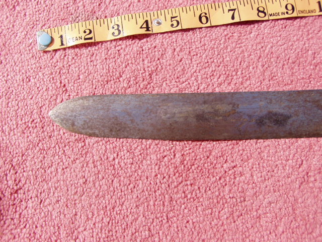

Here are more pictures. The thickest part of the blade seems to be 1/2 inch. He didn't send a picture looking down at the very end of the hilt so I will have to have him send it later.

It looks like it's been rehilted or reshaped .
The Baca baca could be low grade silver .
I like the blade configuration .
It seems hefty enough ; have you held it , everything tight ?

For me, the more I learn, the more I realize, the less, I know. Every Moro kris is a unique sword. Every rule, so to speak, seems to get broken. A seperate guardpiece, while generally can tell us something about the age, is not absolute. The same can be said about the blade form. Generally, it seems, in the 1940's there was a revival of the "18thC" form, which is what I think you have. Even with sword in hand, it is sometimes difficult to form an opinion. Your sword looks to be older than the 40's, but I'm not sure, to guess about the age. The hilt and wrap look receint to me, while the ferrule, seems 40's-ish. Having the scabbard, nice blade, nice price; I would buy it.

The possibly relatively old scabbard might be a plus, whereas the hilt seems really recent to me. How long was this kris with your friend? At least, I'd replace the rattan with a more suitable (and nicer) traditional wrapping! Clamp & ferrule would be fine with me, especially if both were to test positive for silver.
I have mixed feelings with the blade - if pressed hard I'd therefore tend to a conservative guess, i. e. 20c. I agree with Rick that the file work is quite nice. OTOH, the scroll work seems to be a bit shallow (from the pics). The convex side of the first luk could flow nicer and also the engraved lines don't follow the luks perfectly (cp. pic #4). A light cleaning etch to remove the rust would give us probably more clues on the quality of the forging (laminations/tempering).
