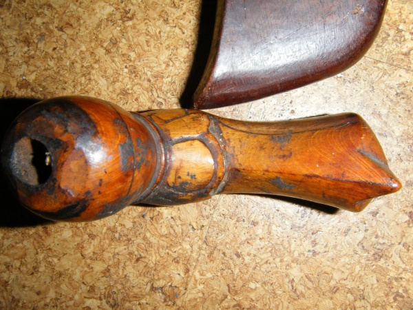

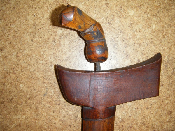

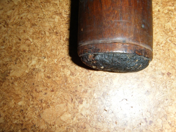

Hello All,
I just received my last e-bay grab, here the link:
http://cgi.ebay.com/ws/eBayISAPI.dll...=STRK:MEWNX:IT
I am positive surprised, it's a nice and good worked small keris. The five luk blade is without pesi 26,5 cm (10.43 inch) long. The buntut of the sheath is long missing and the gandar is filled with resin and there is a carved circle at the end of the gandar.
What do you think, is it a pure bugis keris? Do you agree the the buntut have been a flat one? Which reason may have the carved circle?
All comments are welcome, thank's in advance.

Very nice wood grain on hilt.
The carved circle is most probably a buntut imitation.

Hello Gustav,
yes, the hilt seems to be carved from Kemuning. But the sarung have also a nice grain, I have cleaned it already and it look very nice. Tomorrow I will post some pictures.
That the circle shall be a buntut imitation is possible but when it is like this it is a later addition when the original one go lost. The carving isn't very fine and I don't think that it is from the mranggi who carved the sheath.

Originally Posted by Sajen
Hello Gustav,
I beleive that your sampir might be kemuning, there is no way of telling for sure unless you can show us pics of the sampir after you have clean it up. You may get wonderful chatoyance (Gehwang) after it is cleaned up & restored.
For your stem - Batang Serunai it is most probably of Sena wood, (Pterocarpus indicus) I think that is the scientific name that it is known as. It doesnt have as good a chatoyance affect as a kemuning but a respectable one. It is the choice of material for the stem Malay keris sheath. as it is lighter and believe to allow the blade to "breathe" better as oppose to the Sampir and Hulu that is usually made of kemuning and other hardwood that is beleive to have medicinal, spiritual and combat efficacy.
Which brings me to the subject of where this is from... My humble opinion is that judging from the shape of the sampr, if it is original to the piece, then the blade may be of a bugis variation from the peninsula... maybe up north. You may wish to get better insights from Alam & BlueErf on this tho. Be waiting for the restored pics...

I might be wrong... but it looks like a bungkem piece at the gandek area there...

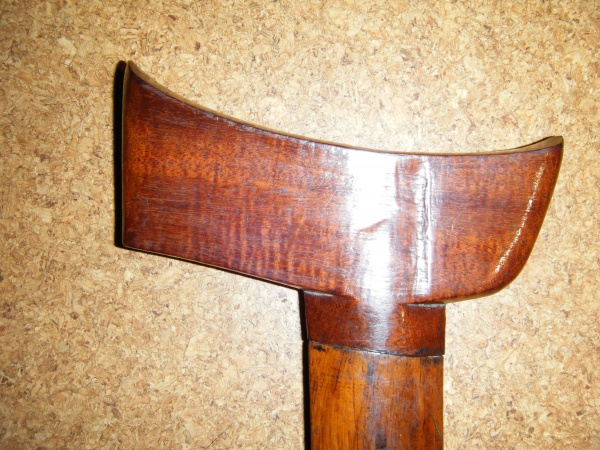

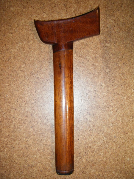

Old 12th September 2010, 10:08 AM   #11

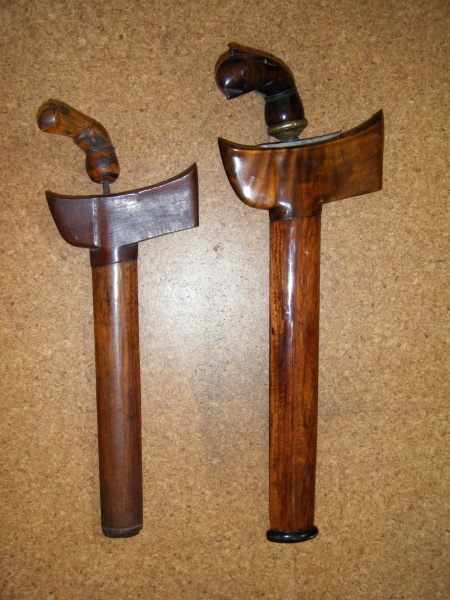

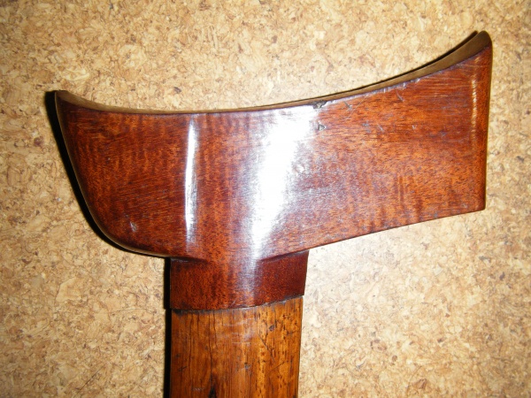

Here pics from the cleaned sheath.
I am certain that the stem is sena... It is likely that the sampir is also a kemuning though the grain doesnt seem to be refine... and there isnt as nice patterning t the grain that is referred to as plots amongst M'sian keris collectors...

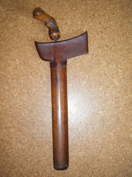

The buntut is likely to be a flat one... similar in shape like the one I had drawn & given to you earlier...

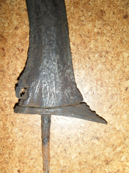

Old 12th September 2010, 04:44 PM   #14
Hello BigG,
thank you for your further comments. Yes, the sampir hasn't the nice grain like the other one but it's better than to seen on the pictures. I start to clean the blade (not yet finished) and here some pics, also from the cleaned handle.

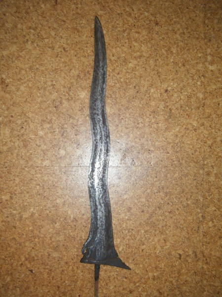

Hello BigG,
Better pictures... it is clear that this is not a bungkem piece...
The blade has fine crystaline structures... this is a form of decorative element similar to pamors. Many Malay blades have non contrasting metal combinations... the crystaline structures are termed as miangs. This is in reference to fine hairlike structures on bamboo leaves and stems that are a protective element/ It is highly irratable and causes extreme and maddening itches... The name that are given to the crystaline structures are derived from this. They are prized for talismanic as well as asthetics qualities just like pamors...
BigG is offline   Reply With Quote
Hello BigG,
thank you for your further comments... I start to clean the blade (not yet finished) and here some pics...
In my honest opinion the value of this blade lies in its quality as a fighting piece. ie... in Malay kerisology... though the keris has mutliple cultural functions as an artifact of material culture, and can be valued for asthetics, as well as talismanic reasons much like the Kejawen (Javanese influenced) pieces, its value as an effective weapon must not be underestimated. Pieces that do not have high asthetic points may score well in terms of its robustness and real or perceived efficacy as a weapon such as this blade.
Firstly, if am right in assuming that the sheath fits well and is original to the piece, then it would tell us a fair bit about the intended character of the keris as a whole. The sheath and hulu is made very functional with the prerequisites of a good fighting blade dressing all there. A functional hard wood material for the sampir and probably the huu too, without too much showiness in grains and decorative natural patternings... the sena stem again with minimum asthetics and also a prerequisite material for the dressing of a fighting blade and no ostentatious refinement to the sampir.
The blade has luk 5... effective fighting blades is usually deemed to be have between 3-5 blades. The blade is likely to be light in the hand but very sturdy. The width of the luks are not too deep and neither is it too shallow. Making it ideal for stabbing as well as slashing at very close quarters...
If you notice, the edges of the blades has rough serrated edges. These are not the results of weathering but deliberately designed to increase the efficacy of the blade in combat. Based on oral traditions of Malay Silat practitioners, seasoned collectors and academics who have done researched on this that I have met as well as my own experimentations, The serration would cause increase tissue trauma during the entry of the blade as well as during its exiting.
So congrats... a piece that lacks ostentatious refinements but a very good fighting man blade... no frills but likely to be deadly... probably a what is deemed by malay collectors as a "Bilah Berjasa", A Blade That Performed Its Intended Duty ... ie a blooded blade...

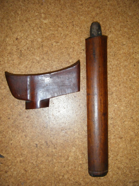

Old 12th September 2010, 06:45 PM   #17
I think that the sheath is the original one to the bilah, look the pic.
