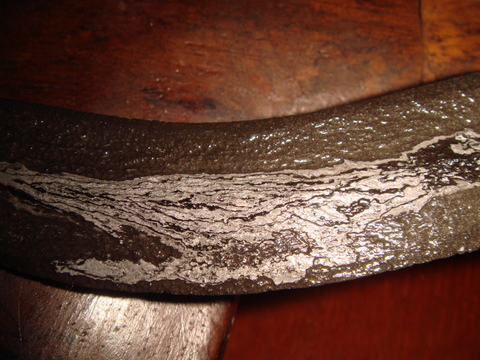

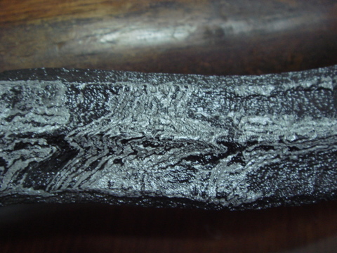

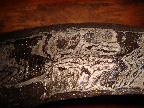

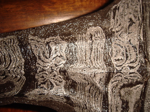

Some pictures of what I am talking about. The one that resembles kupu tarung / tumpuk is said to be tangguh Majapahit by the owner. Note that different lighting produces different color hue of the iron.

Would a full length photo of these blades be possible?
Yes, we do understand that different lighting can produce different effects in the image produced.

Unfortunately, no ... the owner sold the keris to someone else not long after I took the picture about 7 months ago. Back then I was such a neophyte that when I took pictures I only cared about the detail texture of the iron. I haven't learned the importance of dhapur and wangun yet ...
I will find some other photographs to illustrate what I meant. Meanwhile, without considering the overall dhapur (let's assume it's within the acceptable tangguh standards), is it possible for krisses from Majapahit or before to have different color tone of iron and slorok as seen from the picture?
