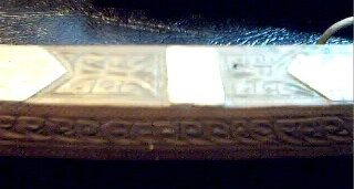

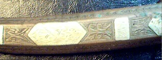

Question Help! I really could use your help in identifying this arabian(?) dagger
Fellow blade enthusiasts. Thank you for allowing me to participate in your forum.
I am in need of information on the following dagger I purchased from a customer. I feel it is old as I know for a fact that it has spent a good number of years in a trunk with quilts.
I bought it along with a very ornate solid brass powder horn.
Thanks in advance for your help in this matter. I am
Vman

Hi , welcome to this great forum, I would say it is probably the most active one to join, with the most wonderfully diverse and informed opinions given with pleasure. Your knife is, I am sure from Morocco and although the pictures are not the best I think it is clear that your knife is a very late 20th century tourist product. I hope this is not to disappointing. Stick around and look through the archive and learn more. Tim

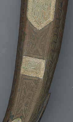

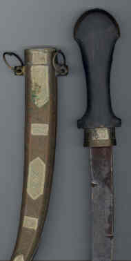

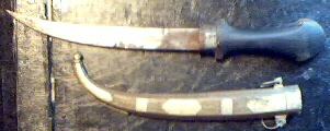

Talking thanks Rick, here are hopefully better pics
I am totally blown away by this forum. The willingness to help is amazing?
I appreciate any and all information you can give me. Here are some scanned pics, hopefully they are of better quality. be sure to ask for any other pics you need.

I think this one is a little earlier than Tim's late 20c. estimate . The engraving looks only so so in quality from what I can see . That does not mean it's not a worthy piece as not everyone can afford the best in any society .
I ask again what is the handle material , also how thick (not wide) is the blade and lastly is it sharpened ?

Sorry for the mix-up. The handle is mainly wood. with a brass plate on the pommel. The handle THICKNESS ( ) is ~1 1/16inches or (for you european chaps) ~2.8cm.

The knife does have the original edge except for the back where some idiot touced it to a grinder. I'd like to ring his neck. I'll post the horrific pic.

Hi Vester , I guess in trying to clarify thickness I actually created confusion . I was referring to the stock the blade is made of i.e. when you look at a coin or piece of metal edge on .

Looks like it's going to be a restoration project .

Rick, you must look over my thick headedness. The blade is 2mm thick and 22.5cm long. It is, the best I can tell, high carbon steel.

Arrow Koummya
That's what it's called . It's Morroccan in origin .
Now the quality of this piece lies in the blade ; if it is made from stout stock , tightly mounted to the handle , and the unground side of the blade is 'sharp' not rebated it might be a decent everyday example .
If it is unsharpened it is more likely to be a souvenir quality dagger .
I would guess it to be at the oldest late 19th to mid 20thC ; you may be able to determine this from the source you bought it from i.e. some Granny's attic etc.
I'll guess it at about WWII .
There are tons of these around some quite good some average and some cruddy junk made for "One who travels for pleasure"
In my opinion any good quality blade is worth restoring .
If it's schlock then just unload it .
In the end you will have to decide the quality because , of course, it's in your possesion .
