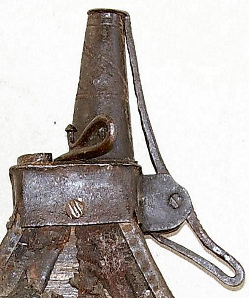

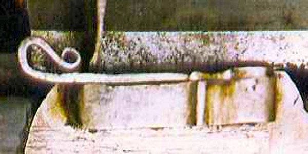

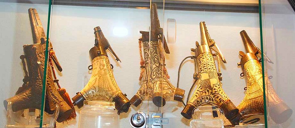

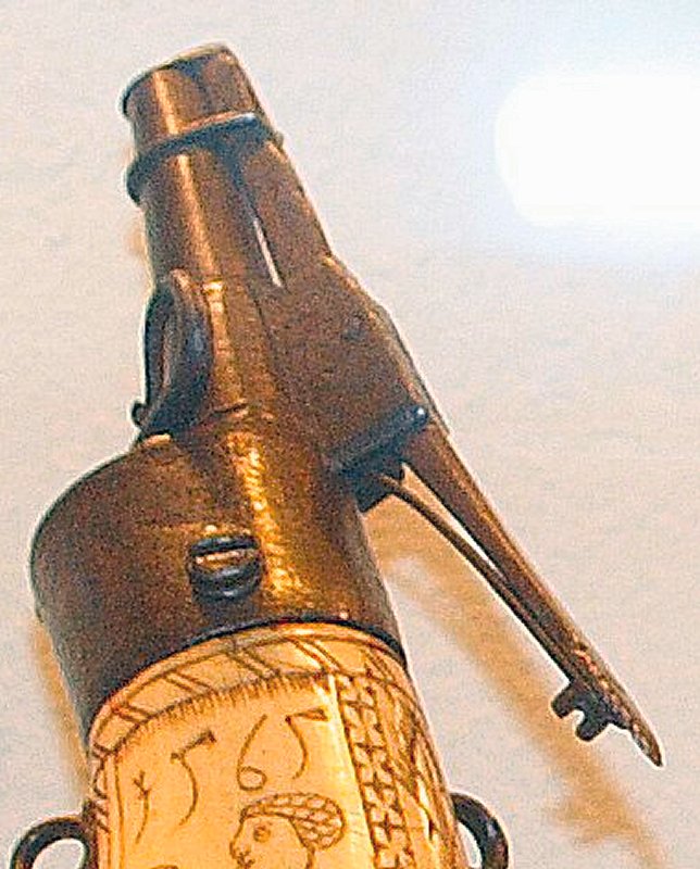

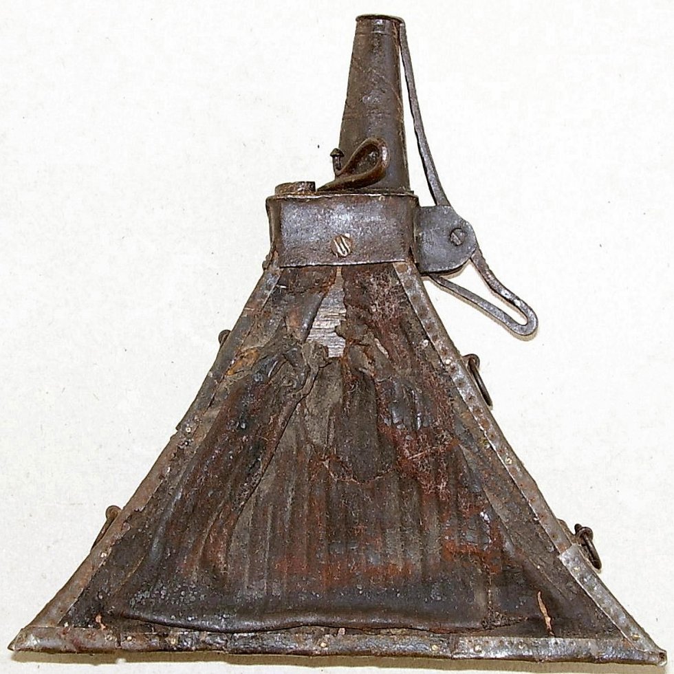

Both technically and stylistically, the top mount closely corresponds to that of an average staghorn powder flask of the 1550's-70's. A very small number of such staghorn flasks were combined with ball reservoirs as well. Also the delicate serpent-like shape of both the top cut-off and another lever at the right bottom side correspond to both pan-cover handles on period matchlock arquebuses and safety catches on wheellock mechanisms - see attachments of related items in my collection:

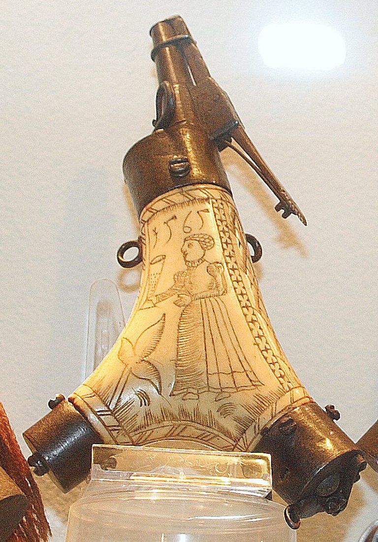

- a fine arquebusier's staghorn flask dated 1565, with serpent-shaped cut-offs on both the top mount and the lower ball compartment

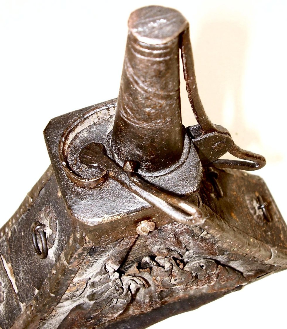

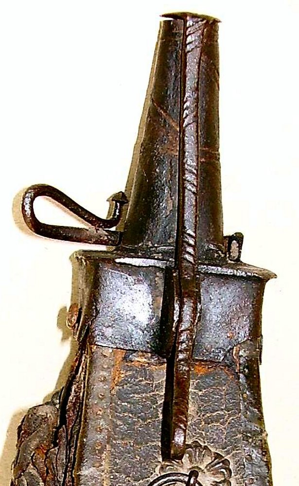

- a very early arquebusier's trapezoid flask with leather pouch and serpent-shaped cut-off, ca. 1540, from a small number preserved in the Munich arsenal

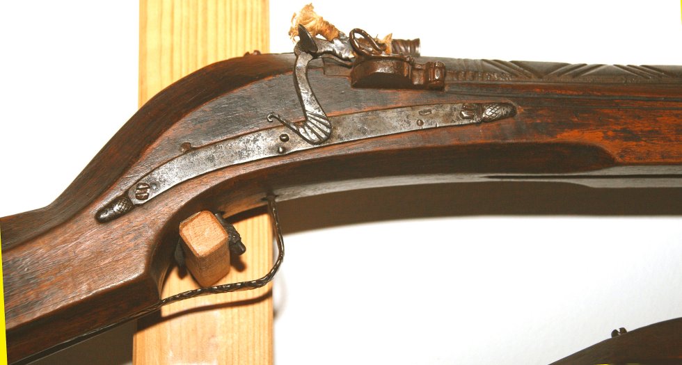

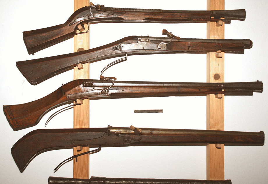

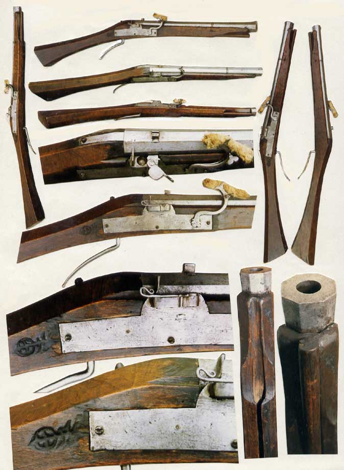

- a Landsknecht matchlock arquebus, ca. 1540, with serpent-shaped pan-cover handle
- another, dated 1539, with similar serpent pan-cover handle

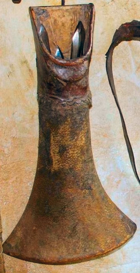

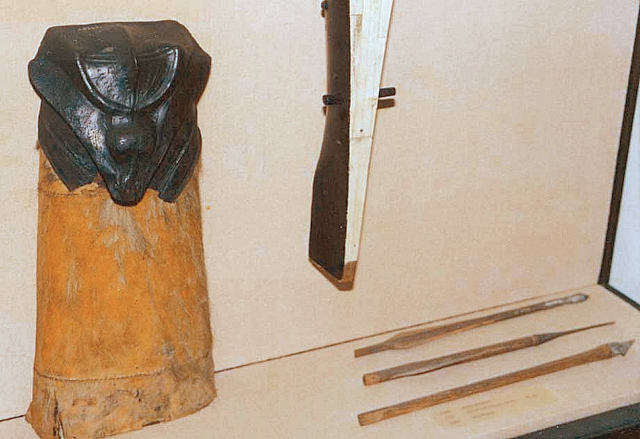

This the shape of a typical High Gothic quiver for quarrels/crossbow bolts; its basic form with the straight sides strongly influenced the earliest trapezoid powder flasks and, for the complete short span of time of their production, which was only from ca. 1550-1590, the rare patrons for paper cartridges.
First quiver in the Bavarian Army Museum Ingolstadt, the second, with the concavely curved sides, in a private collection.
Author's photoographs.
