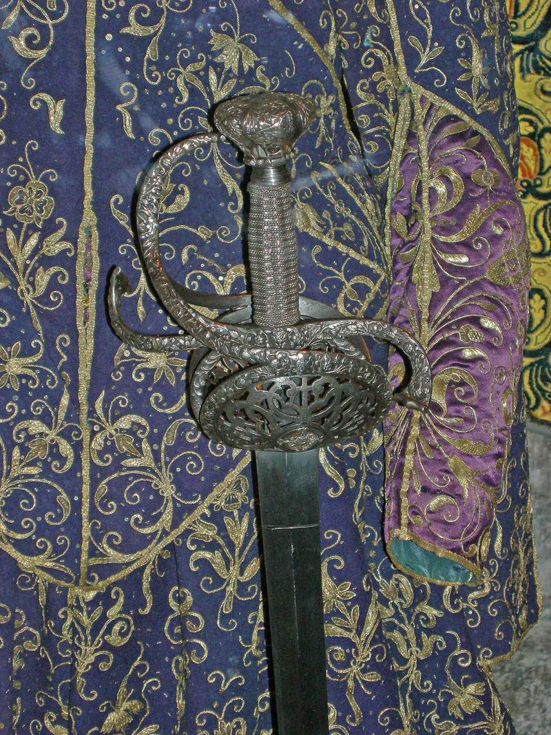

Staying with the Pappenheimer hilt, the Royal Armoury in Stockholm has two Pappenheimer-hilted blades on display which were used by Gustav II Adolf in times of war. One with the hilt damaged as the king ended up fighting a Polish cavalryman during a recon trip outside of Dirschau in 1627. Next to it there's a saber displayed which according to tradition is to have been taken in battle by the king from a Polish cavalryman "before the battle of Dirschau", its unclear if that would be the same man who chopped up the king's hilt.
There's also the blade he carried at Lützen. A third blade with a Pappenheimer hilt on display is also attributed the Gustav II, but with no mention of it being used in battle, instead it is to have been his favourite for everyday carry.
Now, Gustav II Adolf doesn't seem to have been leading from the front unless he absolutely had to, but he does seem to have ended up in combat personally at least two times, and he was wounded multiple times before Lützen. Thus I would guess that he would indeed have gone to battle knowing that he might have to fight for his own life. Still, he brought along something which, in my eyes, is clearly rapiers, which would be rather odd of these were somehow civilian weapons, unfit for the battlefield.

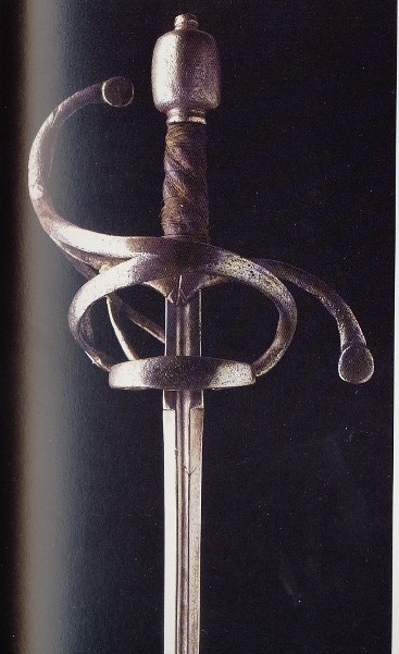

The attached picture shows a lace hilt rapier (Norman-57*), with a 1,030 mt. blade, dated 1585-1640. There is evidence that a number of identical swords were consigned for a Bavarian troop corps.
I wouldn't doubt that rapiers had a civilan (fencing) birth, as at least some rapier variations were used in or for combat.
