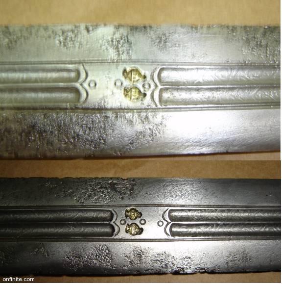

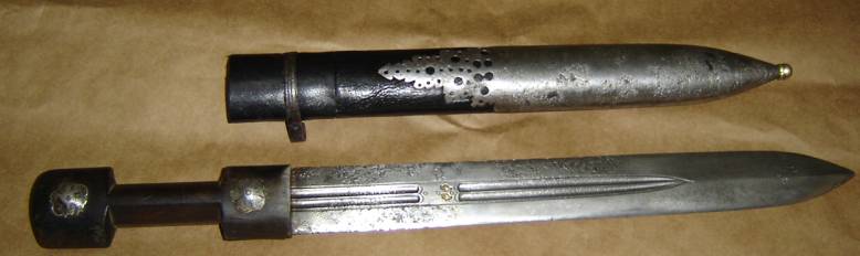

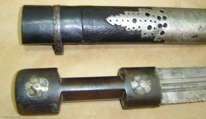

may i learn your comments on this item? is the hilt normal for a caucassian kindjal, or the blade normal for jambiyas? the scabbard mounting and the artificial damascus design in the fullers is clearly Caucassian, not? When the broad blade shape is considered, can this be a very early item?

Ahriman hi. I meant just the hilt as if it was reminding the jambiyas of Northern Iraqi ones. Not the curved blade of jambiyas of course. I have not seen a hilt like this on Caucassian kindjals, but many on jambiyas. What I personally guess, it can be a later hilt restoration with an unrelated spare part, but it can be a known characteristic type too. I hope anybody can explain it. The scabbard mounting is 19th c. Caucassian - as far as I know-. But those blades are always with longer fullers, pointed tips with blades getting thinner through the tip, unlike this one the blade of which continues broad more compared to usual. Again, I expect more comments on this piece.

"Etched damascene" or "etched leaf pattern" in fullers is something extremely common for post 1850 kindjals and quite rare for older examples. I'm not an expert, but if my memory does not betray me, squarish hilt for example can be characteristic for certain cossack patterns, but this one does not strike me as a cossack thing. Fullers are typically turkish (lacking only star and crescent to be 100% turkish). Scabbard is very simplistic and uncharacteristic for major caucasian producers.
It's indeed a rare kindjal type, but I've seen blades like this one. My diagnosis would be that it's something southern - turkish or even more southernish, with slight possibility that's it some rare Dagestan pattern made for Cossacks (the blade's shape is also sometwhat characteristic for cossack patterns).
I hope to be corrected by a real expert.

Rivkin is on the right track, these kamas were produced in Trabzon during the first half of the 19th century. Latter 19th c. photos show that they were worn by Ottomans crosswise through the silahlik or girdle (perpendicular to the waist) rather like a yataghan. They are also occasionally found in W. Georgia but the scabbards were generally remounted in nielloed silver there, though the one-piece horn grips were usually left unembellished.

Qamas were popular in many cultures:Tirri's book has one from the Arabian Peninsula and I have one from Sudan. The distinguishing characteristic is the handle or other decoration, not the blade: Persians sold trade blades all over.
I am more inclined to think that the steel cover of the scabbard points more toward Iraq/Persia.
Ham, do you have any hard evidence of Trabzon provenance?

The most immediate and available piece of hard evidence is the image you posted, Ariel. It is clearly labeled and dated TRABZON 1870.
