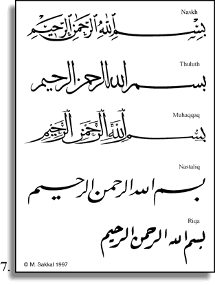

On the 'haladie' thread we have entered into what has proven to be a fascinating subtopic, and Tim suggested perhaps a separate thread would be useful in recognizing and how widespread the use of this distinct calligraphy might be.
We know that thuluth is typically associated with Sudanese weapons, particularly Mahdist kaskaras and often sundry other weapons of the period, but was it used elsewhere? I have understood that as a form it seems to have developed from naskh with the Mamluks, but did its use expand to other areas on weapons?
It would be very useful to see differences in the types of script used on inscriptions of Islamic arms and armour.
Also, I have often heard that thuluth was often essentially unintelligible, and used on Mahdist weapons simply to imply imbued power to illiterate native warriors....however, in many cases the dramatically applied motif was actually repeated phrases from other notations I have seen.

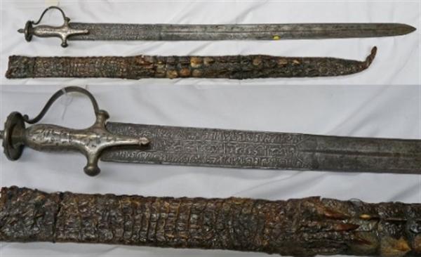

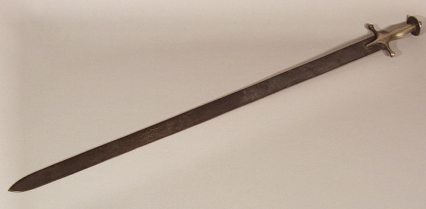

Thanks so much Gav! Thats what I was looking for, good examples, and this really presents a quandry with this....what in the world is a Sudanese weapon doing with an obviously Indian hilt????
Last April we discussed another of these anomalies with a brass tulwar hilt and a Sudanese type blade described as a 'kirach', posted by Valjhun.
(attached below)
I have seen these curious tulwar type kaskaras a number of times, but not in any significant number. There was of course distinct connections in trade between India and the Sudan, and Indian forces were with the British at Suakin in 1885, but it would not seem any of them would have had Mahdist blades on thier weapons. There have been firangi blades mounted on a few kaskaras.....but it would seem more likely that these Indian hilted examples would have been the product of innovative armourers in Sudan using Indian hilts.

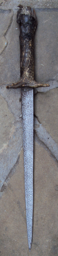

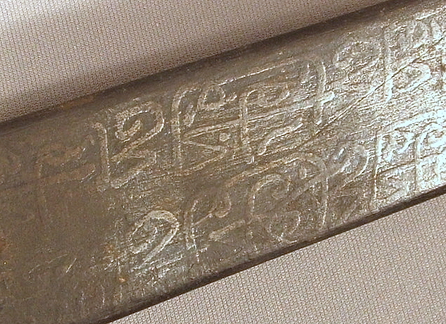

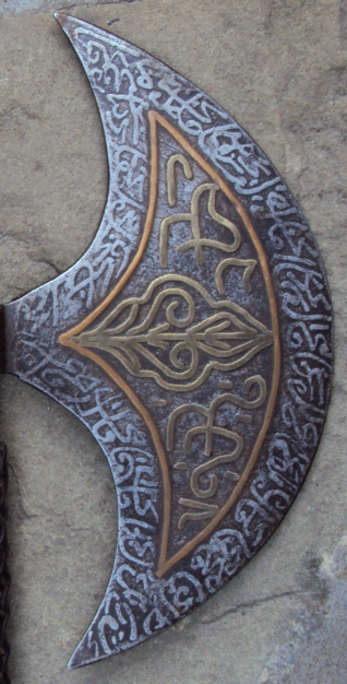

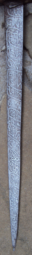

To keep a more narrow focus lets just stick to etched thuluth where ever from. I have seen some on Indonesia weapons.
These are the three examples I have. I am not an expert but I thick it is possible to see three diferent styles, certainly two. Are they indicative of differnt regions? Clearly different manufatures. Crocodle skin in not a pointer as the Niger has crocs.

It would be interesting to see Indonesian examples of thuluth, and it seems that I might have seen something like this in an article by Cato. I can only hope that the guys collecting those areas might see this thread and maybe offer some help.
Well made point on the crocodile skin too. There certainly were crocodiles in the Niger and the use of crocodile hide was used in certain cases in West Africa in some of the secret societies. The use of the crocodile hide on weapons to me seems situated mostly in Sudan, but in singular cases it would be possible to the west I suppose. Most of what Ive seen is armor type regalia, along with pangolin hide, rather than on weapons.

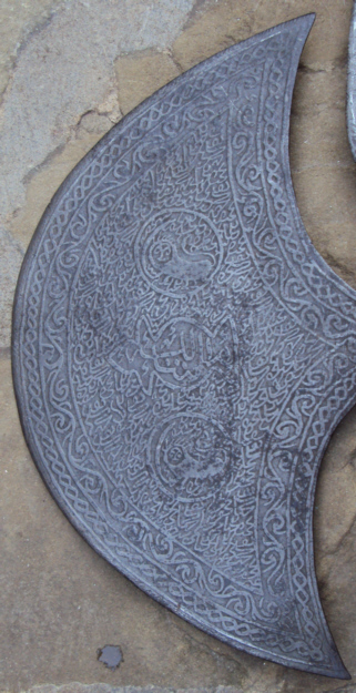

one from a bit further east
tumbuk lada with cockatoo head grip. similar inscription to the one in the style examples above. the raised letters are bright, the etched backgrounds are blackened.

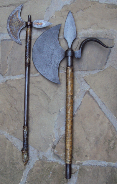

Posts: 6,026

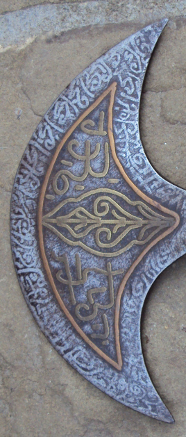

Thank you kronckew. Now there is an Indonesian weapon here I was expecting a swamping of interest, but so far still rather slow. Members have the weapons African or Indonesian and esle where. It is difficult to move forward without participation.
We have the members that can read this stuff. How do the readings differ?
I made this last pic fit my monitor.
