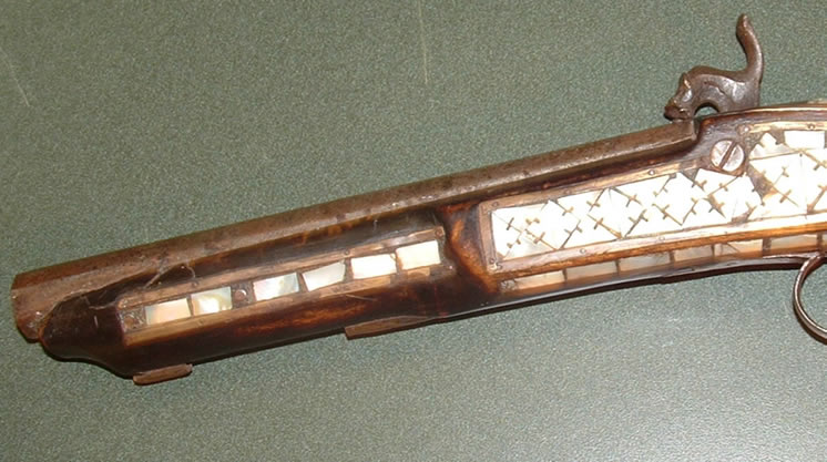

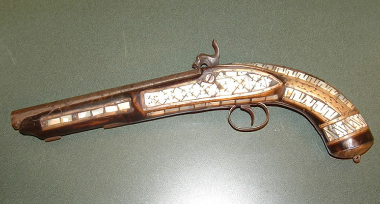

I recently got this English old pistol that has been "converted". I think maybe in the Philippines? The mother of pearl is not as common in North Africa.
Any opinions welcome.

Hello zalmoxis. I do not really know anymore than yourself except it is not African. I just find the similarity of the mother of pearl to this Samoan food bowl most stricking. It would be very rare indeed if it had any relation to Samoa. On the bowl the triangular pieces I believe represent bats. I would agree that your pistol must come from that SE part of the world. Very interesting, maybe there are some gun people around. Tim

This pistol could be a Persian copy of an English pistol ; M.O.P. was used as a decorative material in Persia .
This could also be either Afghan or Indian work .
Do we know for sure that this is an original English pistol or an Eastern copy of which there are many .
This Pistol could also be a composite piece from 20th C. India ; possibly an old piece dolled up to make it more attractive to the "Ones who travel for pleasure" have you checked for machine made parts such as screws ?
{added}
Another hint as to its origin may be the vestigial ramrod socket which to my eye looks to be too short to adequately service the barrel . If I recall correctly many Eastern cultures carried the rammer as a separate accessory on their person rather than attached to the pistol in the European manner .

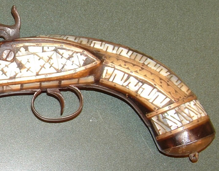

Rick you are so right. In Anthony C Tirri's book Islamic weapons, page 238 top picture, bottom long gun, if you look with a glass you can see the same triangular pieces of mother of pearl. This does bring into question wether this pistol is English in origin knowing the reputation of so many items from Afghanistan. With a very critical stare at the pistol I might feel the plate on the grip end looks a little weak for what would have been quite an expensive pistol. I am sorry for raising false hopes but the mother of pearl struck my eye first, this is ofcourse what it is ment to do. Tim

Also take a close look at the hammer ; damned crude for English manufacture .

This is an Afghan copy of an English military pistol made c. 1900-1920.
While the brass and m.o.p. embellishments are typical, pistols were also made which duplicated the form of the originals so carefully as to be indistinguishable from them, including complex features such as a captured ramrod and Tower marks on the lockplate.
