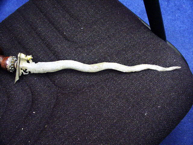

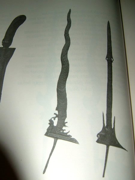

Does anybody know dapur or pamor of this keris or maybe age of blade? claimed to be owned by Raja Bilah, a Mendailing Chief who fled Sumatra during the Padri War and settled down in rich tin mines of Papan, Perak, Malay Peninsular in 1800s. Blade is thin and very fragile. Broken tang but restored.Hilt and sheath original. Buntut (end of stem) restored. Old silver Pendokok but not original to the keris.
All views are welcome. TQ.

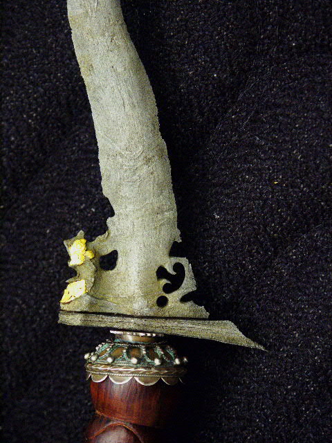

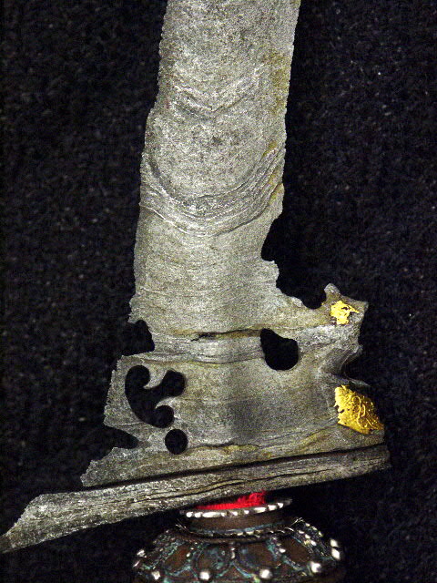

Well, it certainly looks old. You might have a tough time getting an accurate call on the dapor considering all the blade erosion. I would say that without MUCH closer examination it would even be difficult to determine if the cut away bits on the interior of the blade are original to the design or added at some later date. As to any claims of ownership by Raja Bilah, i would forget them unless you have some clear provenance to back it up. Many old keris come with stories meant to increase their sales price. It is interesting just how much more valuable something can become simply by inference that it passed through the hands of this one or that. But without supporting evidence they are only stories, true or not, but unprovable, so we need to concentrate on the item at hand.

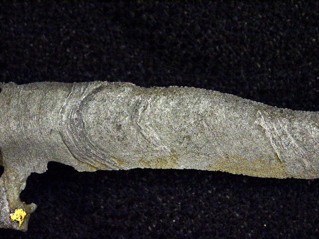

I am not familar with this pamor. A staining would probably make ID easier, but considering the present erosion of the blade and the remnant of kinatah on the gandik it would probably be better off to leave it alone.

Thanks Nechesh, your views make sense to me, probably a reshaped keris, I have never come across seeing one like this before, not even in Bambang`s ensiklopedi of Keris. Maybe my Indonesian brothers and other keris lovers can come forward for their views. I dont think, this keris is of Malay origin. No monetary involved in securing this keris.

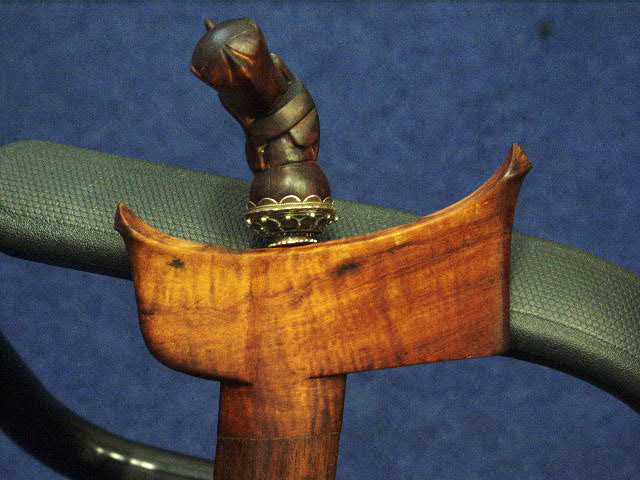

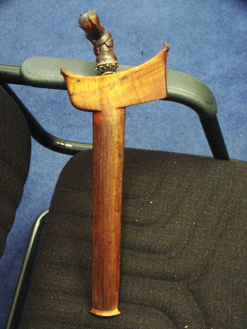

I don't think the blade is a Malay piece. For the ganja, it is long and thin, typical of a Javanese blade. Kinatah is rarely practiced on Malay pieces, another reason why I think it's Javanese. Apart from that, the dressing: sarung, pendokok and hulu are Peninsular form. Just my 2 cents opinion.

Hi mykeris. I'm not experienced yet to see many keris but as my slight glance opinion, the mushroom carving at sraweyan is not well corroded as nearby edge and though the edge is not corroded I don't think that the curve line will match buntut mimi of ganja. Seems like the corrosion is very smart to pick which spot to dwell.
I'm not sure if I'm right, ...just giving my opinion.

Alam Shah, you got strong points there. TQ. Have you seen anything like this anywhere?
