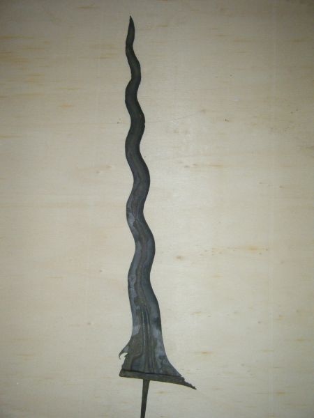

what works fine and certain is lemon acid you can buy in the supermarket. I use a drain pipe closed at one side and hang the blade inside, when you contol it time by time the acid only destroy the corrosion. This blade for example is cleaned by lemon acid.

Hello Detlef,
Very nice result! I see that there are several options. I'll just have to try ...
