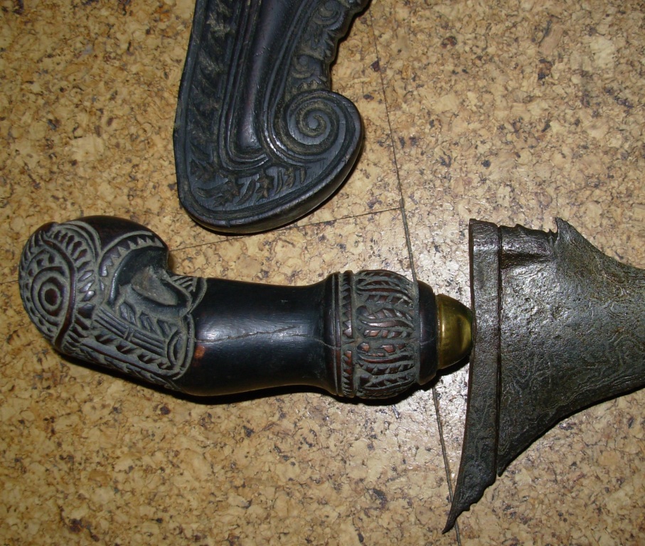

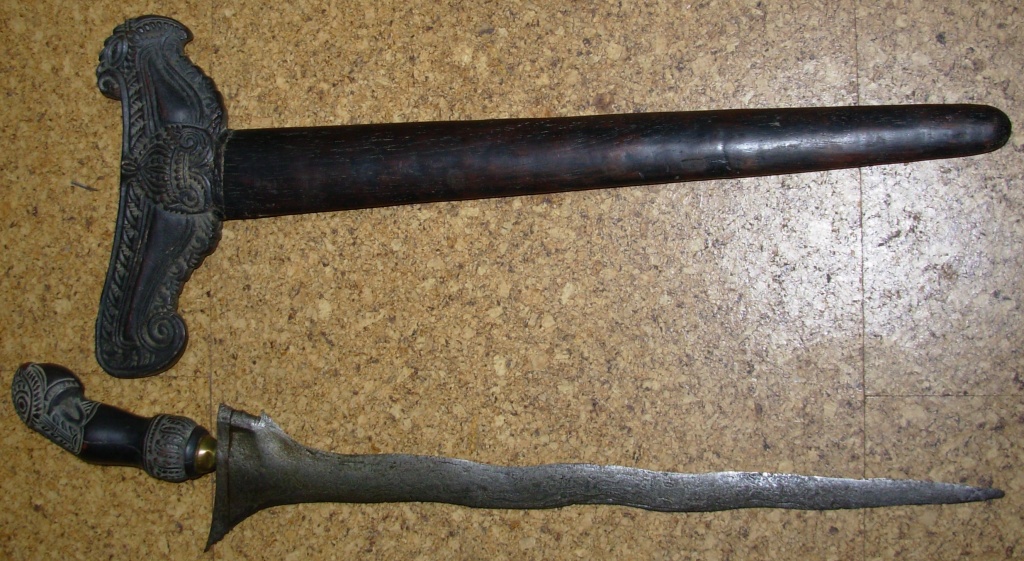

hello together
I bought this today and I'm not sure Keris tourist piece or not.
to any info grateful
gruss Chregu

Based on dress alone i would say this is a Madura keris, not Sumatra. This style of dress is often associated with "tourist" variety Madura keris. Yours seems an older example with an even older blade.
Back in the early 20th century many dutch soldiers brought keris like these back from being stationed in Indonesia. Perhaps one might say that was the beginning of the "tourist" keris. Those bring-backs usually had real, though lower end blades in some sort of carved sheath like yours. Sometimes the figure depicted is a lion. Yours appears to be some sort of bird. You may, therefore, be able to consider this a "tourist" keris, though certainly not in the same way as a contemporary blade in brand new dress made for the market these days. Personally i find keris like this one very interesting and collectable even if there intention in their current form was for sale to returning dutch soldiers. They are a piece of history if you will.

Yes, its a Madura keris, and as David mentions, this style of dress is sometimes associated with keris that were produced for collectors in the period from around 1880 through to WWII.
However, simply because there seems to have been production directed at the collector market does not make this style of dress any less desirable, in fact, old examples of this dress style are now relatively scarce and for the better ones, quite expensive, especially those which are carved as lions.
In my opinion, it is wrong to think of this type of dress as "tourist", because it is a genuine and old established type of dress, however Europeans favoured it because it is elaborate, and blades redressed for sale in the later colonial era were probably dressed this way to facilitate sale.
Examples of this dress can be seen in the museum of the Kraton Sumenep, in Madura. There are a number of different styles, all having different names. I understand the generic name is "gabilan", but there is another larger style that is named "brahmana rsi". I am unclear on the distinction between the two, except that the brahmana rsi is larger.
I do not favour the term "tourist keris", most especially for any type of keris that does have a legitimate old form. If I consider the types of keris that have been made specifically for the tourist market there is really only one type from Indonesia that I can fit squarely into that box, I do not have an example I can show a photo of, but it is a Balinese production, the scabbard is almost always of Makassar ebony, but later ones were stained black, the carving of scabbard and hilt is often of a very high standard, and very often the blade is a piece of flat iron with an etched pamor design. This type of keris was produced exclusively for tourist consumption.

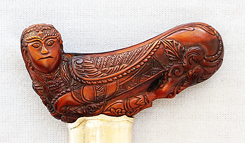

This old thread :
http://www.vikingsword.com/vb/showth...gabilan+madura
And a Lion form .
No mendak needed; it's carved right in .

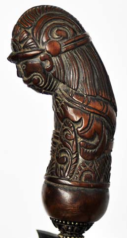

Posts: 7,288
Yes, i have been interested in finding a nicely carved old version of this lion dress for some time.
I agree with you completely Alan. This notion of the "tourist" keris is really a misnomer. Those nasty cut out blades with the paint on pamor from Bali would qualify, yes, and those souvenir Malay letter opener keris with the silver plated blades certainly do, but beyond that...

I thought the blade is a very decent blade! Has a settled old look to it, and definitely made by a pandai who knew what he was doing.

These keris where as mentioned Madura style keris and probably made in madura for the Dutch soldiers to bring back home. Especially Madura was very loyal to the Dutch. This loyalty is represented in some styles of the maduran ukiran full of Dutch symbolism
I already mentioned in another thread that these kind of keris are worth to find a place in a keris collection. A real keris blade in a mostly good carved but also a dress of lower quality of used wood representing a historical period. Until now i've seen two styles of this soldiers keris if i may call it so. Both styles are shown in this thread.
Here in Holland you couldn't enter an auction house or fleemarket without stumbling over some of these keris. Today they start to become more rare to find.

Well, as Alan has pointed out this dress form was a legitimate one that was favored my Europeans and so it became associated with them due to their desire to have these elaborate carvings for keris they returned home with. But we would probably be a bit off base to assume that they were always made specifically for Dutch soldiers. And for the most part i think the blades in them were not made for them either. Just old blades they managed to collect and have re-dressed in this form. Because of this i think we see a great deal of variation in the quality of blades we find in this dress, but usually they are not top-notch blades. We also see a wide range in the quality of the dress itself.
Is it not possible that we might find one of these in Madura where it was owned by a Maduran and never meant to be a soldier's souvenir?

The blades where older blades indeed and mostly not top-notch blades. In my opinion and that's why you see them so much here in Holland is that these dresses were purely made for bringback gifts for mainly the Dutch soldiers and other Dutch employees in those days.
In my opinion the Maduran owned keris in their proper maduran dress and not in dress of lower quality wood, that was used for these bringback kerisses.

There are carved maduran wrongko's en gandars and if i remembered well in a thread about maduran scabbards a wrongko with lying lion is shown.
In that case i completely agree with you. But the keris type we are discussing here are dressed in lesser quality wood which makes quicker carving possible. This quality wouldnt be the choice of a maduran for his kerisblade.

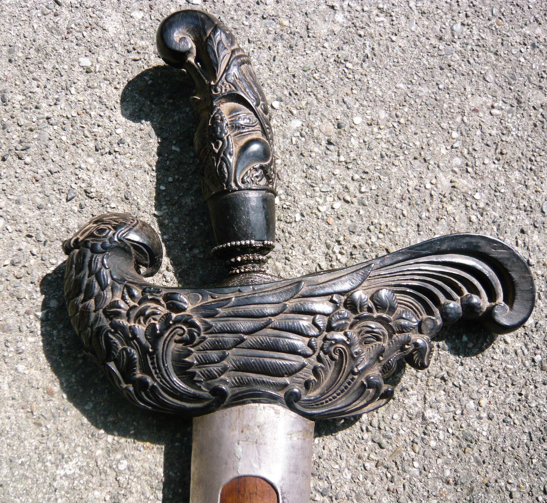

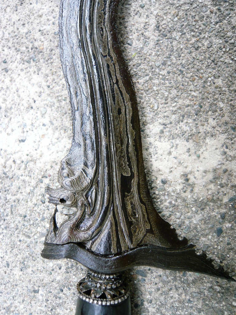

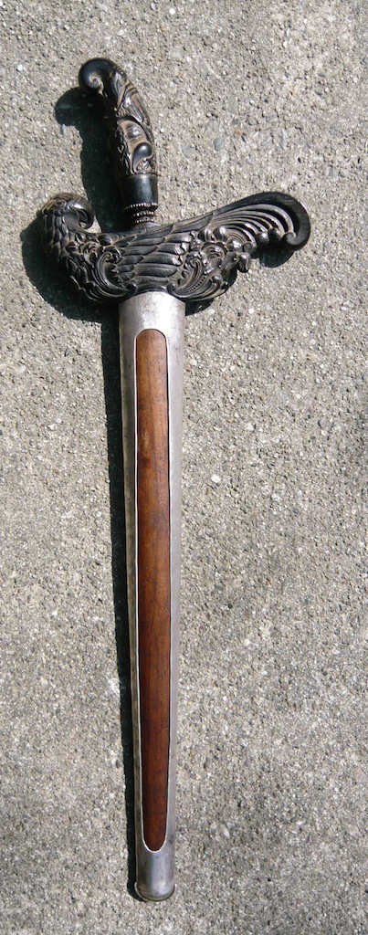

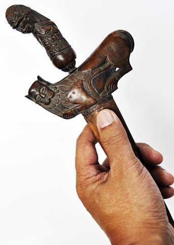

Another carved madura wrongko

I simply cannot tell with any certainty the quality of the wood in chregu's scabbard.
What I can see is a reasonably close grained wood that supports a reasonably fine carving pattern, the scabbard is old, but the pattern of the carving has not collapsed; the wood looks as if it has been stained black, but the area on the hilt where it has worn through seems to have a reddish colour, so it is possible that this wood might be sawo, which does have similar grain and support characteristics, if it is sawo, it is not a low quality wood, but quite a respectable wood.
If the wood has not been stained black, it might be sono--- but it doesn't really look like sono---and again, sono is a decent wood.
Since you have been able to detect that this is a low quality wood, could you please tell us how you were able to know this from the photos.

As i mentioned before, you couldn't enter an auction house or fleemarket here in Holland without stumbling over these soldier keris. Sometimes just 10 in a box.
If you had a lot of more keris in an auction house 10 to 1 you had 1 or 2 of such keris among them.
It is certainly not detecting the quality of wood from a picture as handling these keris so many times that it is not hard to recognize this kind of keris and recalling the quality of wood on all these keris.
I would be very surprised when the wood of Chregu's scabbard would be of a different wood quality than the scabbards of these type of keris.
On the keris Marcokeris is showing us, i will not give any comment on the scabbard simply because i cann't.
And to be honest, i owned both of these soldier keris shown here by Chregu and Rick in this thread. Sometimes it drove me to madness discovering again a soldier keris among the few keris i bought. Just reselling and hoping it wouldn't take too long before someone was willing to buy it.
I sold them all accept one with a lying lion wrongko. Today i regret i didn't kept such a keris as Chregru is showing. Regrets because i realize more and more the historical period these keris represent. But i'm convinced today or tomorrow i will stumble against such a keris like Chregru's for fish and chips because here in Holland these keris are still considered as the first tourist items brought back by our soldiers.
So Alan, it is not that i am able detecting woodquality from a picture, in that case i would be rich and famous, but the expierence of handling these keris through the years.

You said:- "---lesser quality wood which makes quicker carving possible---"
What I understand by this statement is that the wood in and of itself is of a low quality.
There is nothing that I can see in the photograph of chregu's keris that would indicate that the quality of wood used is sub-standard. Yes, the quality of workmanship does leave something to be desired, but all indications are that the wood itself is a decent quality wood.
I have not seen nearly as many of this keris type as you tell us you have seen, but all that I have seen have used wood of decent quality, and the actual workmanship has varied enormously from superb all the way down to absolute garbage.
In fact, the speed with which wood can be carved depends upon wood of a decent quality being used. It needs to be of a tight, even grain in order to support the detail of the carving, and it needs to be of reasonable hardness. If it is too soft, the carving will not be well supported, if it is too hard, the carving will be too difficult, and additionally, very hard woods sometimes have a tendency to shear off along the grain in detail work.
For instance, black ebony is a beautiful wood, that is very hard and carves well, although it does use time with hand tools, however, its weakness is that it can lose sharp edges when these edges coincide with the cross grain of the wood.
Timoho is one of the most highly prized of wrongko woods, however, we almost never see it carved because the black sections are incredibly difficult to carve,and the pale sections are too soft to support detail well.
Cendono jowo is a very low cost wood, that is pale in colour, and easy to work. It supports carving reasonably well, and can be stained, however, in use, the carved edges in detail work will often give way and you finish up with chips all over the work. The same holds true of cendono wangi, but it is rare to see this carved, and it is extremely expensive.
A low cost wood that fairly easy to carve and that supports detail well is sono---which is what the dark wrongko that David has supplied a pic of probably is. Makassar ebony is also a candidate, but its harder and has a tendency to chip.
Sawo carves well and supports detail well, also, it is not expensive.
In fact, the idea of "lesser quality wood" just does not register with me, because the lower the quality of the wood, the more difficult the job becomes, and you can buy good quality wood for carving at a low price.
The high quality wrongko woods are virtually never carved, because it is their grain that makes them high quality, and the carving will hide that.
However, if we accept that the dress in these highly carved wrongkos is often of less than premium quality, in that the form and detail of the carving, and the overall finish, is less than good, then I for one will wholeheartedly agree.

The keris you show from the archives are made with much more quality than the soldier keris. I do own similar maduran keris which i wouldn't qualify as soldier bring back keris, but more as maduran keris. But then to return to your question, were they made for madurans? I really cann't give you the answer. But looking at these keris I have an example with a carved wrongko and hilt of which i can imagine a maduran would have been proud to wear it.
I think however and it is a carefull guess these appearance of the maduran keris came up in the 40ties or 50ties of the previous century.
Then we come to the next point.
Alan, although i'm not an expert on woodspecies i understand clearly what you mean and how the quality or hardness of the wood gives the results of carving.
The wood of the maduran keris and which David showed us from the archives is of a kind usually used for keris sheats.
The wood of the soldier keris shown in the thread, both Chregu's and Ricks, i always compare with the wood of a firtree. Wood of the firtree is here in Holland low quality wood.
I hope this answer made clear what i ment.

I won't make any further comment of the idea of wood "quality", as the difference in our perceptions, and possibly differences in language could see us talking forever.
As to dating, yes, I think the carved styles probably did begin to proliferate in about the middle of the 19th century. But really, we're kidding ourselves to presume to put any date on any of the dress styles, simply because there is very little reliable evidence upon which to base our guess.

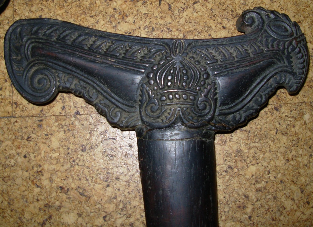

Other example of antique tourist/knil soldier keris. The blad is much older than the scabard.
