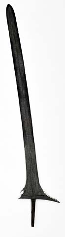

Dear All,
This old blade has been in my collection for almost one year. But it is still doubtful for me to say that it is a sundang. The type of "greneng" (I don't think this is the right term for it) is suspicious... If it is a sundang, then which sundang? Moro? Malay? Fake sundang?
The sheath is suspicious too... It should not be the original one.
GANJAWULUNG

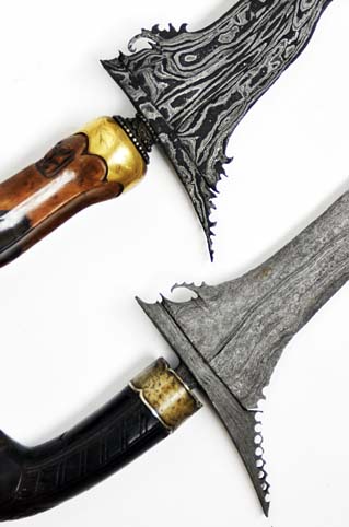

I also attached a picture of a sundang tang that supposedly had been aged. Unfortunately i don't know the ageing technique used. This sundang is probably from Madura. The ageing pattern is very convincing.

Hello Pak Ganja,
It's certainly a keris sundang - I'm not convinced that it's antique though. My first thought was that this may have come from a pande Jawa, or probably be a Madurese creation.
The blade is not Moro (laminations and scroll work are off). Any pic of the blade tip?
From cleaning blades experience -- with coconut's husk, and then "mutih" (whiten) the blade with lime-juice and cream-soap or whatever -- you may learn too to differ which blade is newly made and which is old...
Has the blade been hardened? Could it have been forged from old steel?
AFAIK sundang blades were kept smooth (like keris Bali) in all ethnic groups with a keris sundang tradition. Possibly Rasdan was referring to the obviously Javanese surface treatment?
I don't even bother the type of warangka and the hilt, because it could be changed at anytime.
I'm fairly sure the scabbard is a replacement done on Java/Madura. Can you narrow down it's age from craftmanship and material?

I only know salt & sulphur and natural rusting. What i know is, if the blade is made of wrought iron, the combination of the above ageing methods would be enough to make blades look old. It is just that we have to be patient with the natural rusting process. One year of sun and rain, the blade would look rather antique.
Perhaps you can enlighten us here on how artificial aging is being done?
The most common technique by my Maduran friends -- at least once or twice I practice just to know how -- is "kamalan" (technique of ageing new blade) with crushed red brick (for laying the keris in a certain place, like "blandongan"), wetted by not too-much watter and mixed with about a cup of crushed sulphur and three spoonful of salt... Submerge the new blade in the crushed-red-brick-sulphur-salt for (it depends the result) one night. Then clean with cream soap, and submerge in citroen liquid (I don't know the english word) to clean the blade. Then directly "mutih" (whithen) the blade... Before warangan.
But of course, not as simple as that. And not simple to explain. You must practice yourself...

Here are a few questions.
1)--- what style is followed by the ricikan of this blade?
2)--- is the erosion of the greneng in harmony with the erosion shown between pamor and the steel core?
3)--- what method was used to produce the greneng?
4)--- does filler exist between the gonjo and the blade?
5)--- where do we find this particular pamor very frequently used?
6)--- why do we find this blade in a poorly made Javanese scabbard and with a pedang handle?
The answers to these questions may assist in a determination of exactly what we are looking at here.
Pity we don't have a time machine.
Last edited by A. G. Maisey; 18th March 2010 at 12:21 PM. Reason: unnecessary comment

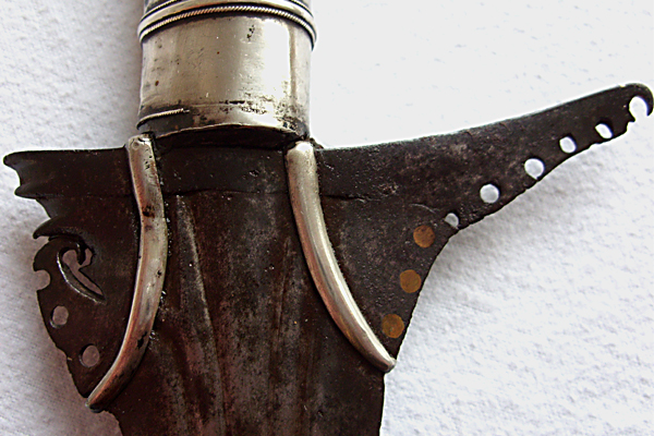

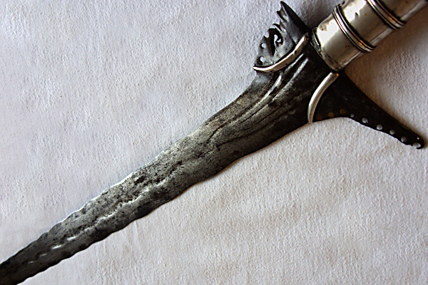

Interestingly, Maurice has recently posted this sundang on the main forum with similiar greneng. Not sure where this one is from either, though Malay origin is being suggested on that thread.
http://www.vikingsword.com/vb/showthread.php?t=11654

With nine circular in the greneng section, and three in the sekar kacang part. And this picture below, just for comparing the ricikan (details) in the gandhik part -- between older Maduran keris and this suspicious sundang...
GANJAWULUNG

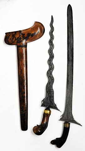

And the whole view, for size comparison. Maduran keris with eastern Jawa scabbard (without pendhok). I found this keris as it is. I didn't change the scabbard and the handle... The size is 42 cm without pesi (comparing to 52 the sundang). Older Maduran, and Eastern Jawa tends bigger in size than the central Jawa kerises. Eastern Jawa -- could means the Madurese who stayed in northern part of East Jawa, just across Madura island...
GANJAWULUNG

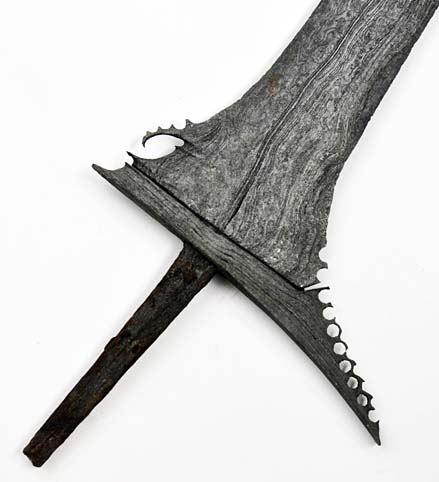

Regarding Alan's question on what's holding the ganja and the blade in place.... the ganja was drilled to tight fit pesi's size, and heated. Once heated, the hole became softer and flexible, so its fitted nicely when cold though normally a little gap can be seen

And though I cant be sure that my opinion is correct, the mismatched blade and dress are normally attributed to Kalimantan....
Old 22nd March 2010, 06:38 AM   #21
Posts: 7,230
Penangsan, I do understand shrink fitting and have used it myself in non-keris related things.
Please note:- this is a square pesi.
Can you please advise the localities where shrink fitting of a ganja is normally carried out. I am only familar with two usual methods:- the keyway and the crimp. I doubt that I have seen a blade where the ganja was shrink fitted.
Is this a common method of fitting the ganja in Moro type keris?

However, I would imagine your teacher is fitting a round pesi to a round hole.
The pesi on this sundang is square.
When we fit a square shaft ( the pesi) to a square slot ( the cut in the ganja) there are unequal stresses at the square cut corners of the slot. The material in the ganja is of small mass, thus the stresses will not be great, however, they will exist, and if that ganja is of layer welded material , we could expect to see any imperfections in welding fail. Especially so when we realise that the sides of the oblong slot are very thin in comparison with the length from the pesi to each end of the ganja.
Still, as I have remarked, the mass is not great, so with perfect fitting, and a press fit of only a few thou, you'd possibly get away with it. Provided you did not go into high orange on the heating.
With a round hole and round shaft (pesi) the same unequal stresses do not occur, but are distributed evenly around the hole.
But then there is still one problem that is insurmountable with traditional hand-tool techniques, and that is the achievement of a tight fit betweem ganja and blade base. I've made a number of keris, and more than a few ganjas. To get a neat tight fit between ganja and blade base is a swine of a job that requires repeated fitting and filing or scraping.
If you want to do a shrink fit you do not have the possibility of achieving a tight fit of ganja to blade base, and anything less is simply not acceptable.
Now, if we consider the blade that is the subject of discussion here, we can see a reasonably close fit, and we can see a very considerable gap between the pesi and the ganja. Anybody who has the skill to hand cut a slot to a tolerance of the few thou needed to achieve a shrink fit, would certainly have the skill to cut that slot so that it fitted closely to the pesi at its top.
Yes, it is possible to shrink fit a ganja to a pesi, but it is not possible to use this fitting method with hand tools and achieve an acceptable fit to the blade base. Most especially so with a square cut pesi and slot.
The crimp method of fitting is where the hole is cut to a press fit on the pesi, and then a punch and hammer is used to tighten the ganja hole around the pesi. I have most often seen this method used in Bugis and Peninsula keris.
The key method of fitting involves cutting a keyway with a very small file into the side of the hole in the pesi, then a small key is made to fit that keyway --- a tiny piece of tapered steel --- which is driven home with a punch, thus tightening the ganja. Sloppy and lazy makers use a small nail instead of a purpose cut key. The best position for the key is at the buntut urang side of the pesi hole.
So to my mind, the question remains:- how is the ganja kept in place?

You are absolutely right Alan, the shrink fitting method is used to fix the round pesi into the round ganja hole - and according to my teacher, it is the old tradition (what ever that means...)
Although i dont have any sundang that was made by my teacher, I was told by him that is the only way for him to attach the ganja to the blade, be it on a keris or sundang.
And, your question about how the ganja is kept in place - would not it be securely kept in place when the ganja is mounted to the pesi when its tightly cold shrunk? Some of my kerises were made by my teacher, and the ganja were fitted this way... I have never experienced the ganja of my kerises loosen even after soaking them in citric acid solution, as compared to using glue or epoxy.....

Penangsan, if it is "the old tradition", all I can say is that any keris maker who could achieve a tight fit of the ganja to the blade base by using this shrink fit method knew a technique of mating metal surfaces that was far in advance of anything known today.
One of my sons owns a precision metal working factory. His normal work involves working to the smallest tolerances imaginable, and the mating of one flat metal surface to another flat metal surface. Using his state of the art methods he tells me he could mate the base of a ganja to the base of a blade with no gap, using a shrink fit method to fit the ganja. However, when I asked him if it were possible for him to do it with hand tools, he told me what I already knew:- impossible to achieve a neat fit.
That your teacher, and others before him , could achieve this neat fit by shrink fitting the ganja simply astounds me --- and for the most part Peninsula blades do have a neatly fitting ganja.
During my lifetime I have cleaned, stained, repaired a very large number of blades. I don't know how many, but a lot. Many of those blades were Peninsula blades, I would guess that most were from the 19th century. I cannot recall ever noticing a single blade, Peninsula or otherwise, that used a shrink fit ganja. Often a crimped ganja will appear to be a shrink fit, and it is only when you look very closely and see the punch marks around the pesi that you realise how it was fitted. Sometimes these punch marks might have been filed flat, and you can often detect this by use of a loupe.
Yes, of course a ganja that has been shrink fitted to the pesi will be kept tightly in place.
However, in the case of the blade under discussion I draw your attention to the large gap that is visible around the pesi:- any maker who could cut the pesi slot with such precision as to permit shrink fitting of the ganja could most certainly cut that slot to a neat fit around the top of the slot; additionally, the base of the pesi has been mated to the base of the blade with reasonable precision, yes, its not good, but it is certainly better than could be achieved at the first attempt with hand tools --- and shrink fitting demands that you get it right first time:- with a shrink fit you cannot remove and replace the ganja two or three hundred times until you get the mating of surfaces correct --- you need to get it right first time.
I'm waiting for Pak Ganja to dig some of the muck out from around the pesi and between the blade base and the pesi, and tell us just exactly how the ganja has been attached to this blade.

...I'm waiting for Pak Ganja to dig some of the muck out from around the pesi and between the blade base and the pesi, and tell us just exactly how the ganja has been attached to this blade.
The best way to know how the "sundang" maker fitted the ganja to the square pesi, is to loose (open) both part. But of course, I won't do that in this "sundang" because it is still fitted and strong enough that you may not open with your barely hand...
To loop it again and again, well Alan, for this time being I can't do that either, while I can not handle or loop it -- 'cause the blade is in Jakarta while now I'm still far away in Neuchatel, Switzerland...
What I know is, it seems that the maker simply used both method -- either a shrink fit method, and using a smal "sindik" (round, needle sized metal?) in one square side, and the part which fit the ganja is bigger than outside part that you may see from outside pesi... To prove it, it is impossible not to unfit the ganja from the "sundang"... What I've seen is, that no trace of "epoxy" or other recent glueing process in this blade

No Penangsang, you don't bore me.
I think I now understand where you're coming from, and it seems that we are travelling in different directions.
Thank you for expanding your comments.
Thanks Pak Ganja.
It won't be a shrink fit if a pin or key has been used.
It will be a press fit, ie, cut to a very neat fit, but not requiring heat to put in place over the pesi.
If you use a pin after a shrink fit, you actually run the risk of weakening the joint.
Looking at the image, it does look as if iron filings and epoxy, or maybe plastic steel has been used to fill, but you you say this is not the case, OK, its not. But I can't help wondering how the black material that fills the gap between blade and ganja has finished as it has at the tungkakan. Fascinating.
A ganja can build up corrosion in a very short period of time, and under some circamstances, this can bind the ganja to the pesi.
